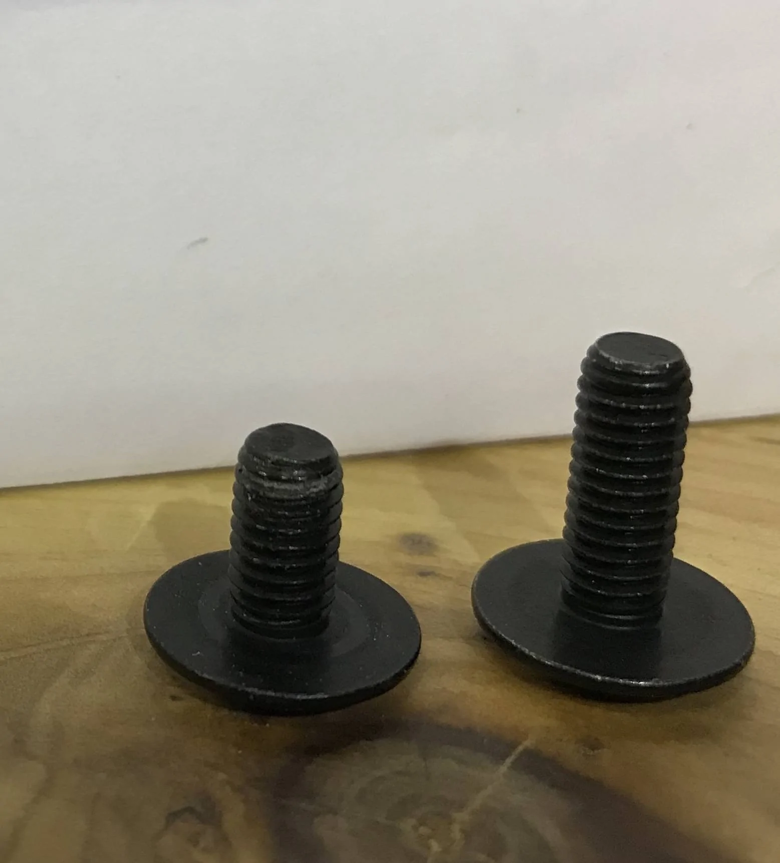

Left is the screw that stays in the swing when the Gurney is not attached--should come already inserted in the swing. Right is what is used with the Gurney--come in a separate package of four with the Gurney.
No part number on the package.

I just verified, I have 8 of the shorter screws. It’s weird though since I’m engaging 4 1/2 threads with the flap installed and it feels totally solid. I wonder if I should call ford performance and see if they’ll send me the correct screws.

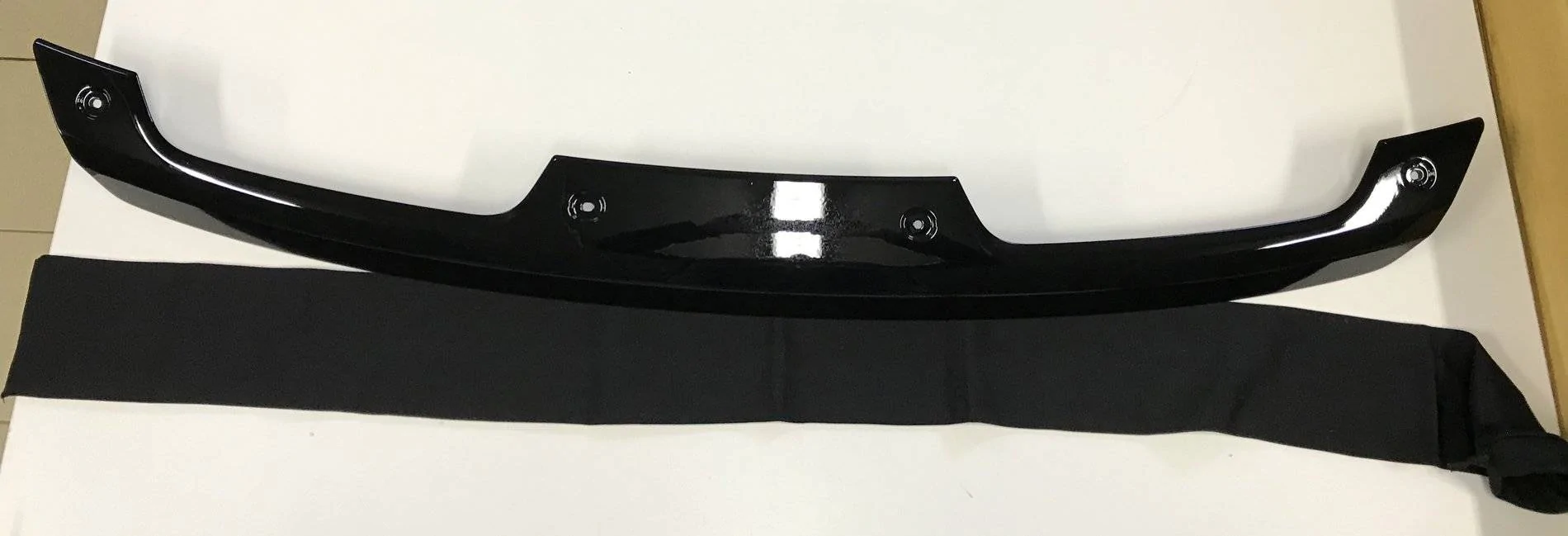

I just mounted the Gurney using only the two center holes using one long and one short screw. Although I probably wouldn't have thought twice about it if I only had the short screws, in a "side-by-side" comparison the difference was very noticeable.
I would definitely NOT trust the short screws to hold the Gurney when driving at speed.
I also reinserted a long screw without the Gurney to confirm that the longer ones would protrude--confirmed. The short screws are needed for when the Gurney is not attached.
Bottom line: recommend calling Ford Performance first and then the dealer, as you noted. That way you will be able to point the dealer in the right direction based on FP's guidance.

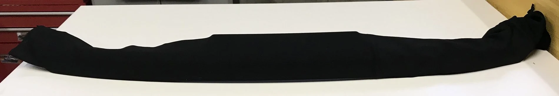

Tip for storing and transporting the gurney flap when it is not actually on the car...
https://www.amazon.com/gp/product/B076GM5X46/ref=ppx_yo_dt_b_asin_title_o04_s03?ie=UTF8&psc=1
https://www.amazon.com/gp/product/B07J4FY1RB/ref=ppx_yo_dt_b_asin_title_o03_s02?ie=UTF8&th=1

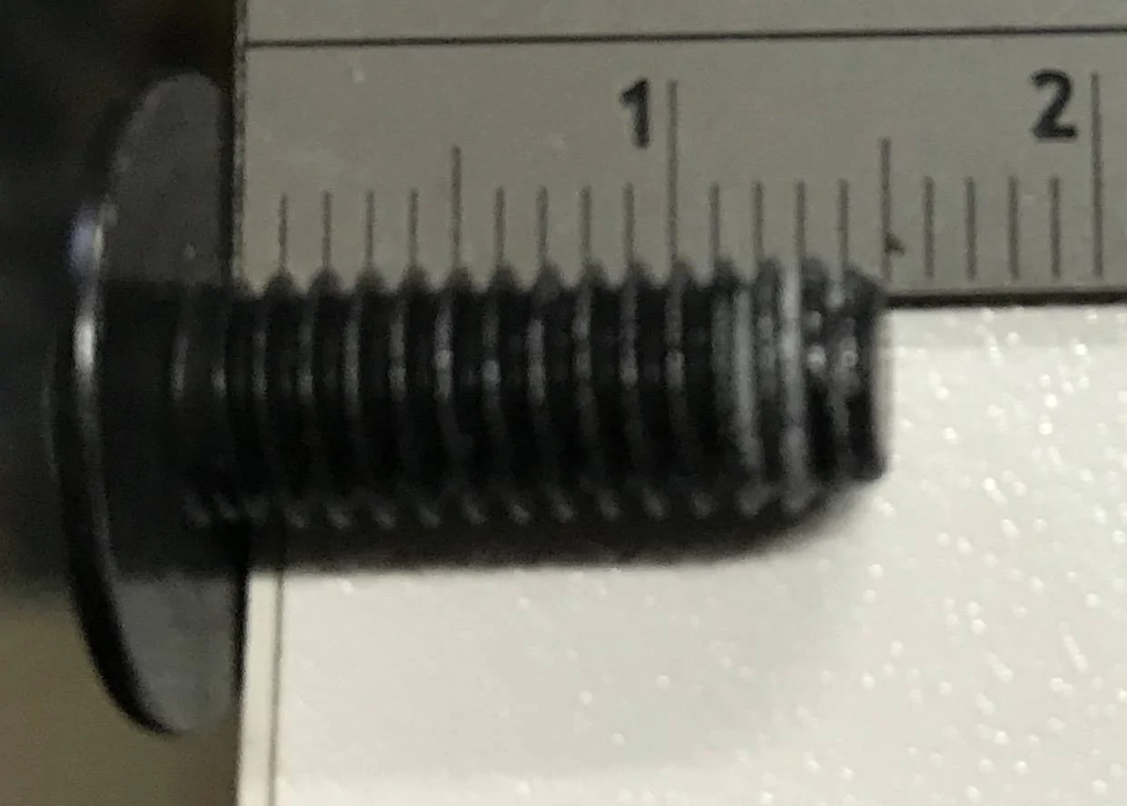

Good luck. Picture below may help
Edit: measurement is metric (15mm or 1.5cm) :
