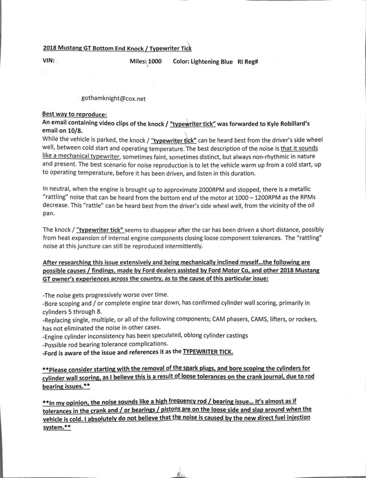

2018 Mustang BBQ TICK List
GothamEMS
New Member
Oct 28, 2018
Rhode Island
Jerry
2018 Mustang GT PP1
Here is a list I compiled, which I gave to my Ford service advisor, who attached it to the work order for the tech. It was helpful with diagnosing my vehicle in one day...which confirmed the worst. Please feel free to use this list as a template or in whatever capacity that helps your case.

Sometimes the simplest things are the hardest for a dealer to do.
Step 1 Cut open oil filter look for bearing material.
Step 2 Bore scope the cylinders for damage.
Step 3 If metal is found in filter replace entire LONG BLOCK. I guess Ford thinks it's ok to have metal floating through all the passages in the heads and the phasers.
Thank you for taking the time to make a list that anyone having this problem can take to a dealer and help make a case. Ford should make your list the FIRST STEP in diagnosing the issue, maybe the Ford Hotline should call forward their # to you LMAO.

I'd be careful telling a mechanic what to do, many are to prideful to listen and will think your trying to tell them how to do their job, I don't dispute how helpful that document is, I think peoples experiences will be different depending on if they get a decent mech or an ahole.

They dont want to check oil filters I think because they know what they will find and don't want to replace hundreds of long blocks. They are trying to get away with as much as they can.

I can tell you right now what the fix will be when they figure it out :
New block with sleeves instead of spray in liner and possible bearing clearance adjustments.

I get the whole ego thing, I deal with egos all day long, I really do...but I didn’t want to end up with all kinds of new parts/repairs on my car, that weren’t the problem. By rolling the dice with my list, I made it pretty clear I had some mechanical knowledge, and suggested a place to start. I didn’t want the dealer to believe they could just pacify me with the whole “it’s normal” crap. In my case, it was helpful on my first visit to the dealer dealing with this issue. I completely understand your angle though.

For the life of me...I don’t know why dealers aren’t scoping these engines first...it literally is one of the easiest tests to perform, and will provide very valuable information

Smart man, I told my dealer I didn't want parts being thrown at it, just replace the engine, but no fishing expeditions. You got a cool mech.. One I got was a little standoffish at first until I got him to verify it, than eased up a bit.
