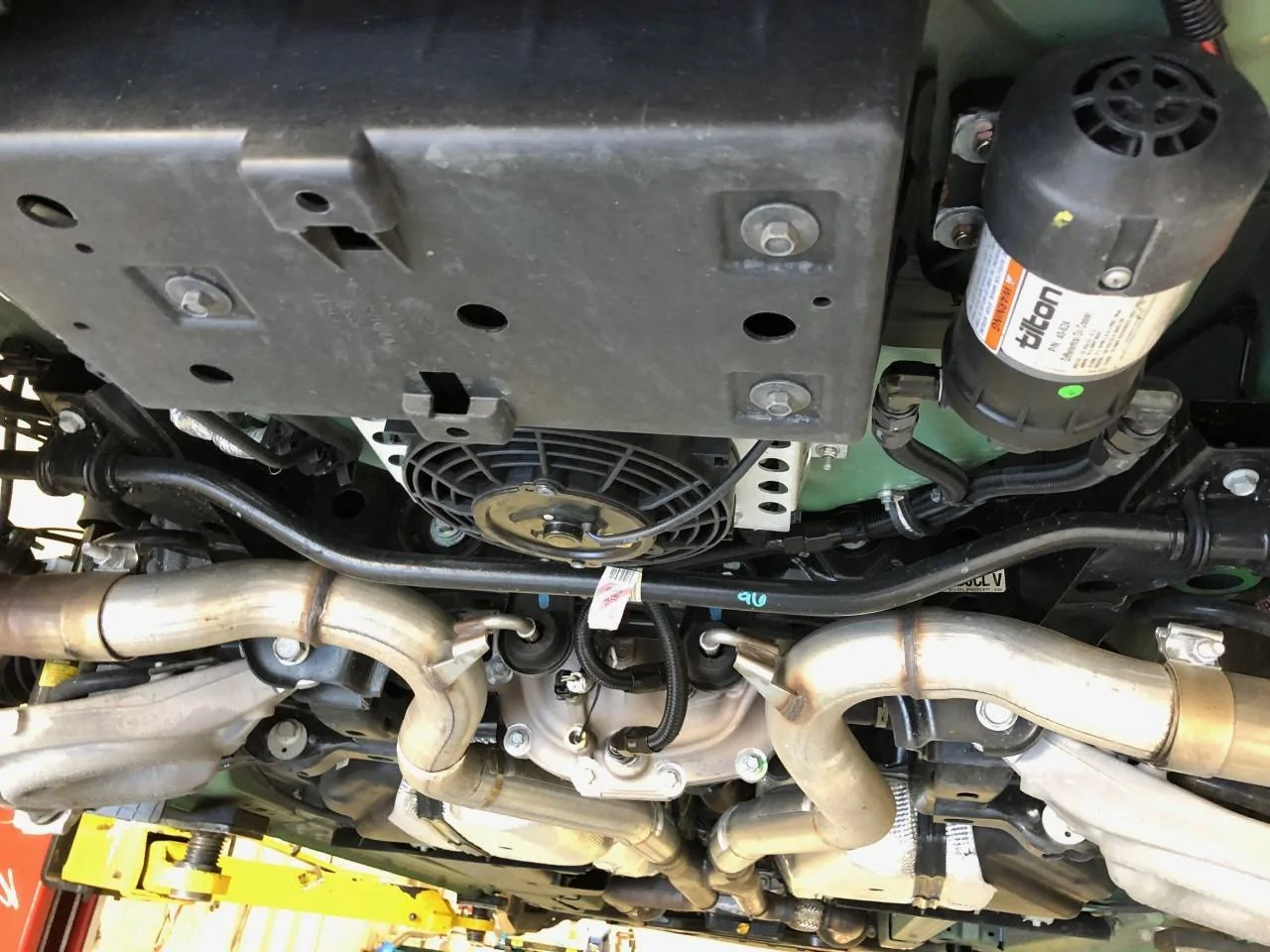

I almost positioned the pump and cooler in the same spot as you did. But out of prior experience with pump related heat failure I have been putting the last four of my cars I put it where I did,(creature of habit). I did fabricated a "bridge" with side venting to drawing the air in and holes to let the cooler push air thru the top after a quick nearby cayon run the trunk temp rose only 4 deg. Above the unairconditioned rear set area. I have ran mine with all the stuff in my trunk and a spare tire stored above the venting area. Please note that I dont plan on needing to run the cooler for street driving, but I now know if I need to I can. If you look closely at the photo you can see the sides of the bridges are cut square for the air to move under the cooler and the holes on top of the bridges to allow the blower to push the hot air out. I will add a few photos to the DIY to show the bridge fab.

I almost positioned the pump and cooler in the same spot as you did. But out of prior experience with pump related heat failure I have been putting the last our of my cars I put it where I did,(creature of habit). I did fabricated a "bridge" with side venting to drawing the air in and holes to let the cooler push air thru the top after a quick nearby cayon run the trunk temp rose only 4 deg. Above the unairconditioned rear set area. I have ran mine with all the stuff in my trunk and a spare tire stored above the venting area. Please note that I dont plan on needing to run the cooler for street driving, but I now know if I need to I can. If you look closely at the photo you can see the sides of the bridges are cut square for the air to move under the cooler and the holes on top of the bridges to allow the blower to push the hot air out. I will add a few photos to the DIY to show the bridge fab.
Great initiative on your part and creative. It is nice to know that you will not go into limp mode while on the track.

I just installed the FTBR kit on my 2019 GT PP1. It’s mounted under the car. works well but the pump and fan are loud. Can be heard both inside and oit side the car. When inside, it’s about the same noise level as running the AC fan on medium To high but makes sort of a high vibration/buzzing noise. I guess that’s the pump. Seems to be working. Dropped the diff temp by 60F just on the highway. Have not tried it on the track yet.
