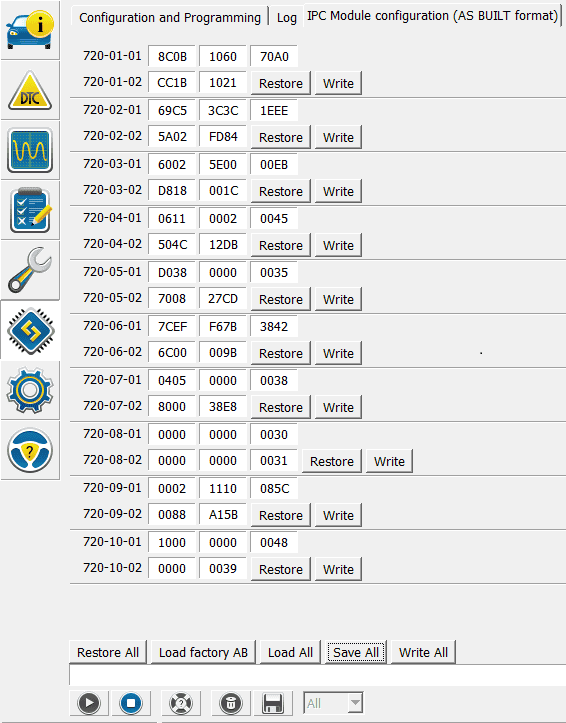

Hey everyone!
I've been following this thread for quite a while and the time came to use the knowledge and install Active Exhaust on my Mustang :)
I have a Mustang GT 2019 A10 401A PP1 S&S. The car according to the window sticker is a 2019, but according to Carfax it was manufactured on the 12/30/2018.

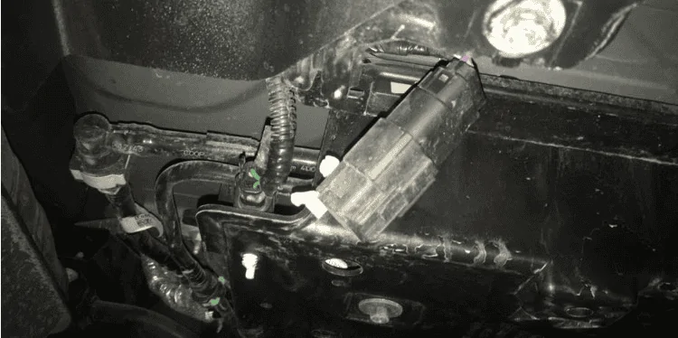

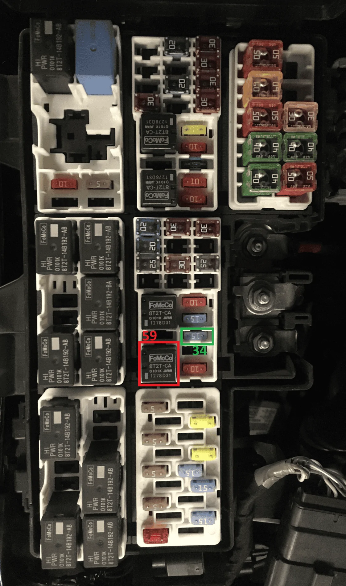

I do have the fuse (34) and the Exhaust valves relay (59) and also the plug on the rear.
I bought a whole OEM exhaust together with the wires and installed everything.
Now to Forscan
Originally I had the following IPC values:
720-04-01: 0611 0002 0045 (4 = Enabled 6 = Disabled DB252's Findings)
720-10-01: 1000 0000 0048 (E = Enabled C = Disabled Both must be set for Active Exhaust enabled/disabled) NOTE: I had a 1 there
I swapped the values to:
720-04-01: 0411 0002 0045
720-10-01: E000 0000 0048
And I got the Active Exhaust in the menu on the Digital 401A cluster (yeey! right?). But this is it... The actuators do not move at all, no matter what option I select in the cluster and I get no errors what so ever.
I will be debugging this problem and if I will find a solution, I will let you know :) But if there is someone out there who knows what am I missing (I hope not the special tune) please let me know.

You have to activate the feature in the PCM for it to work, only the 2018's came with it 'On' from the factory when not installed as an option... Your choices are to fabricate your own controller, pay for a 'tune' from PBD or Lund and ask for the feature to be activated or buy a HP Tuners device and do it yourself.
As Mach VII showed, you forgot the tune. I believe it is a 2019 and up only thing and actual 2018 model years can get away without the tune. Not a big deal, I had to do it myself on my nearly identical optioned 2019. I already had a PBD E85 tune at the time, so I just simply asked them to switch the Active Exhaust on in the tune and it all worked perfectly.

Hey man I finally found the right connector to make the harness for people with out the plug. With in the next month or so I should have the first harness ready for me.
Please share the part numbers.

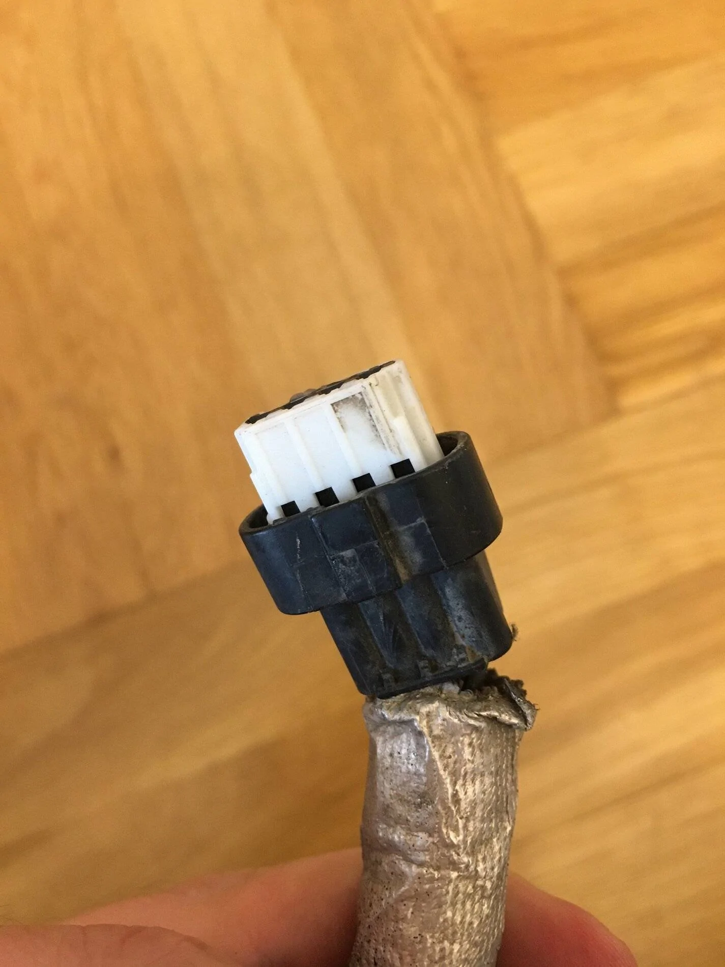

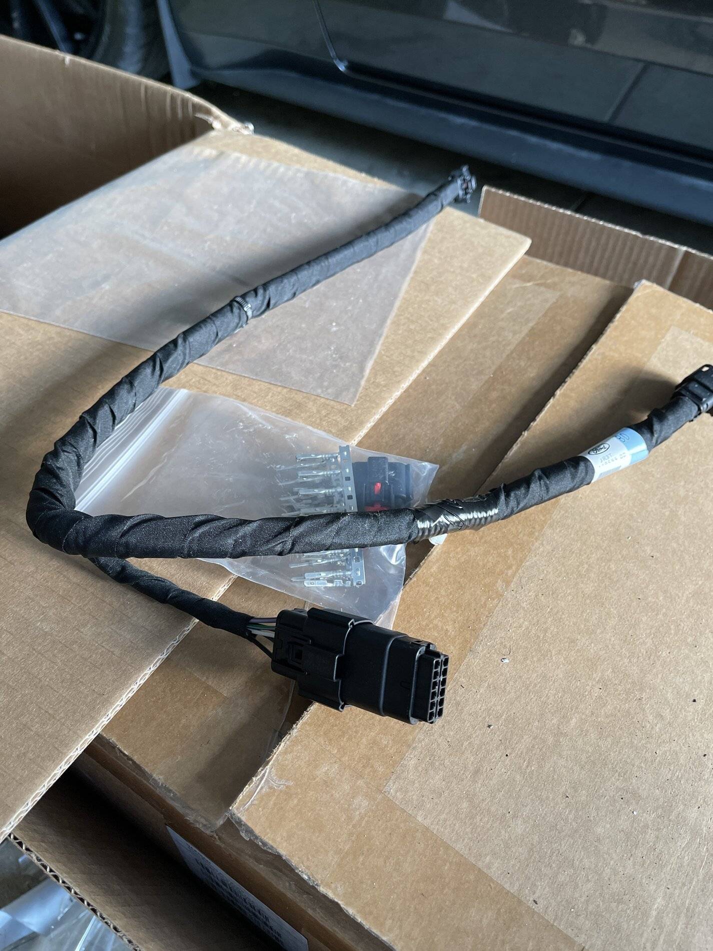

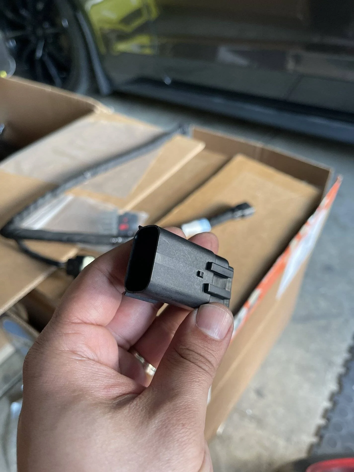

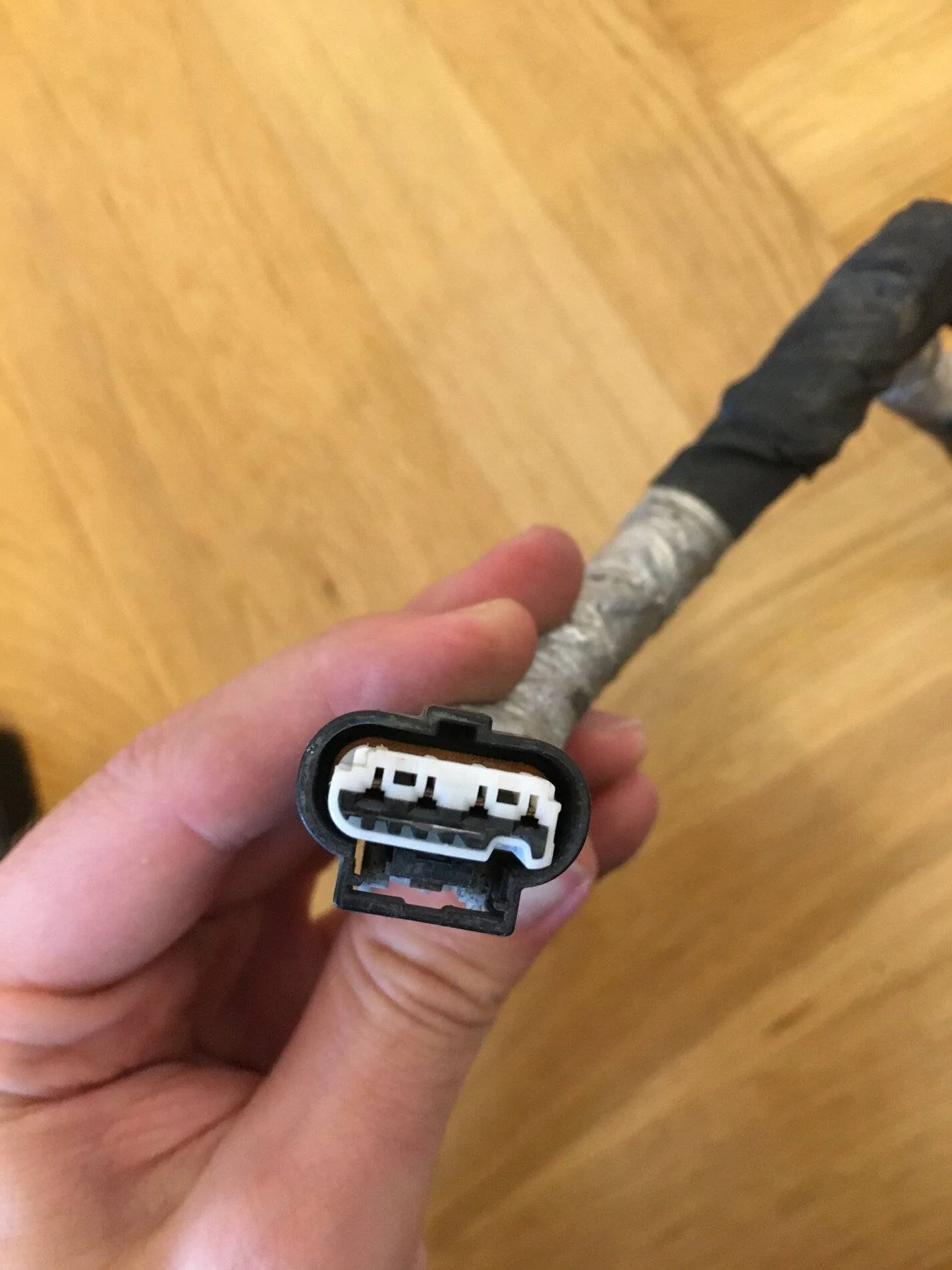

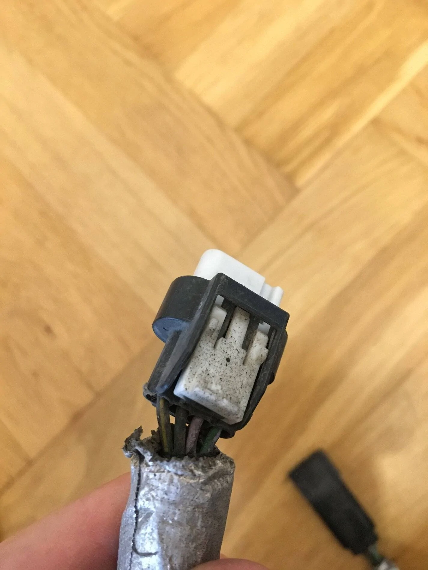

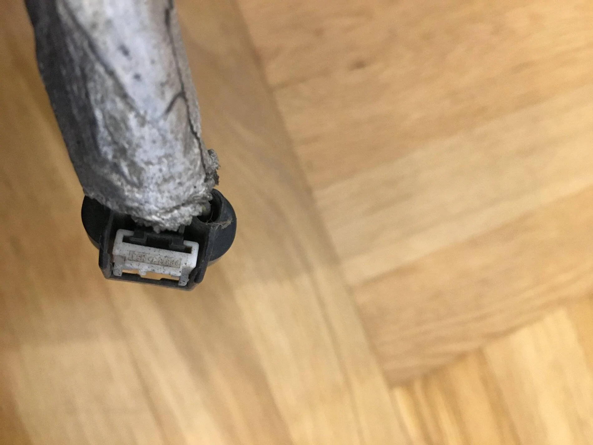

JR3Z-14A411-J - The black Y harness:
1x 33472-1557 12pin - 6 wires
2x 33471-0401 4pin - 4 wires
JR3Z-14A411-H - The silver harness going to the actuator:
1x 33481-0401 4pin - 4 wires
1x <something I can't quite read, see the attached pictures> 4pin - 4 wires

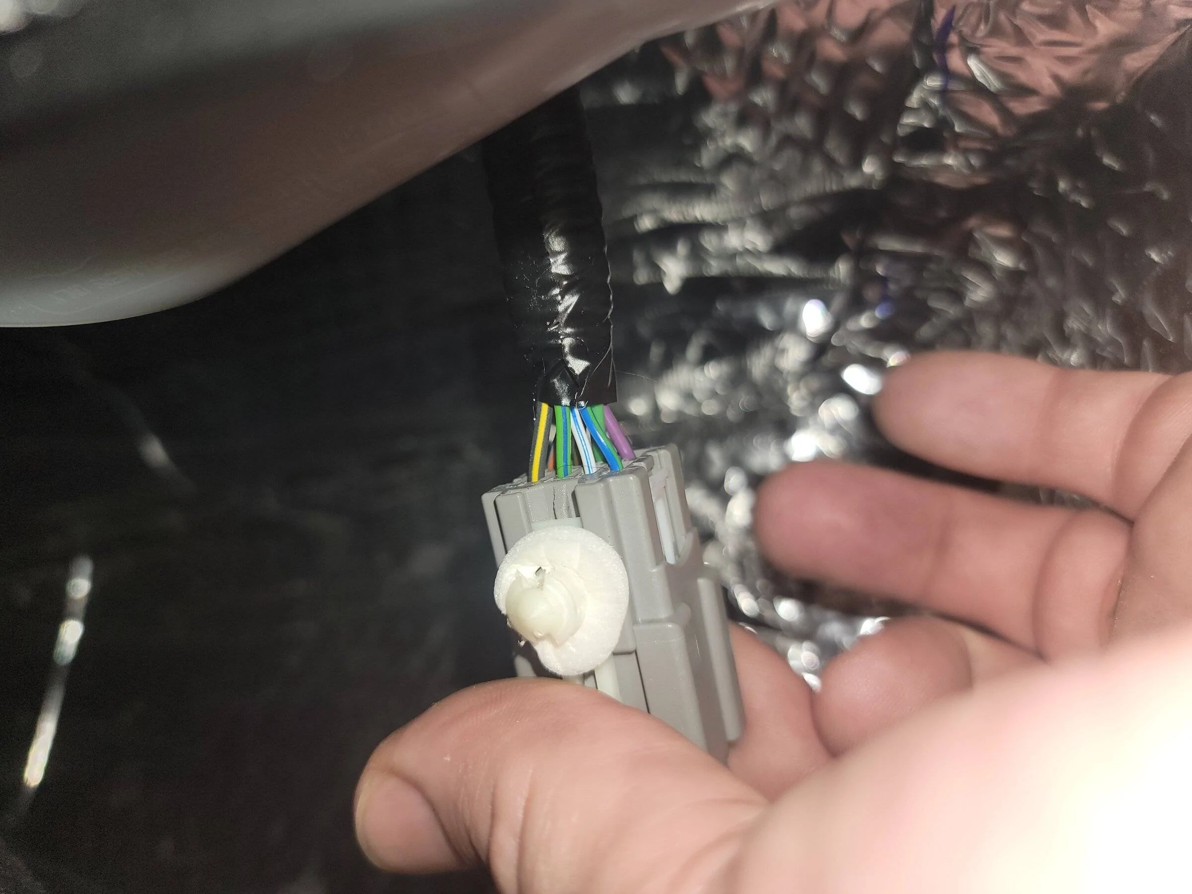

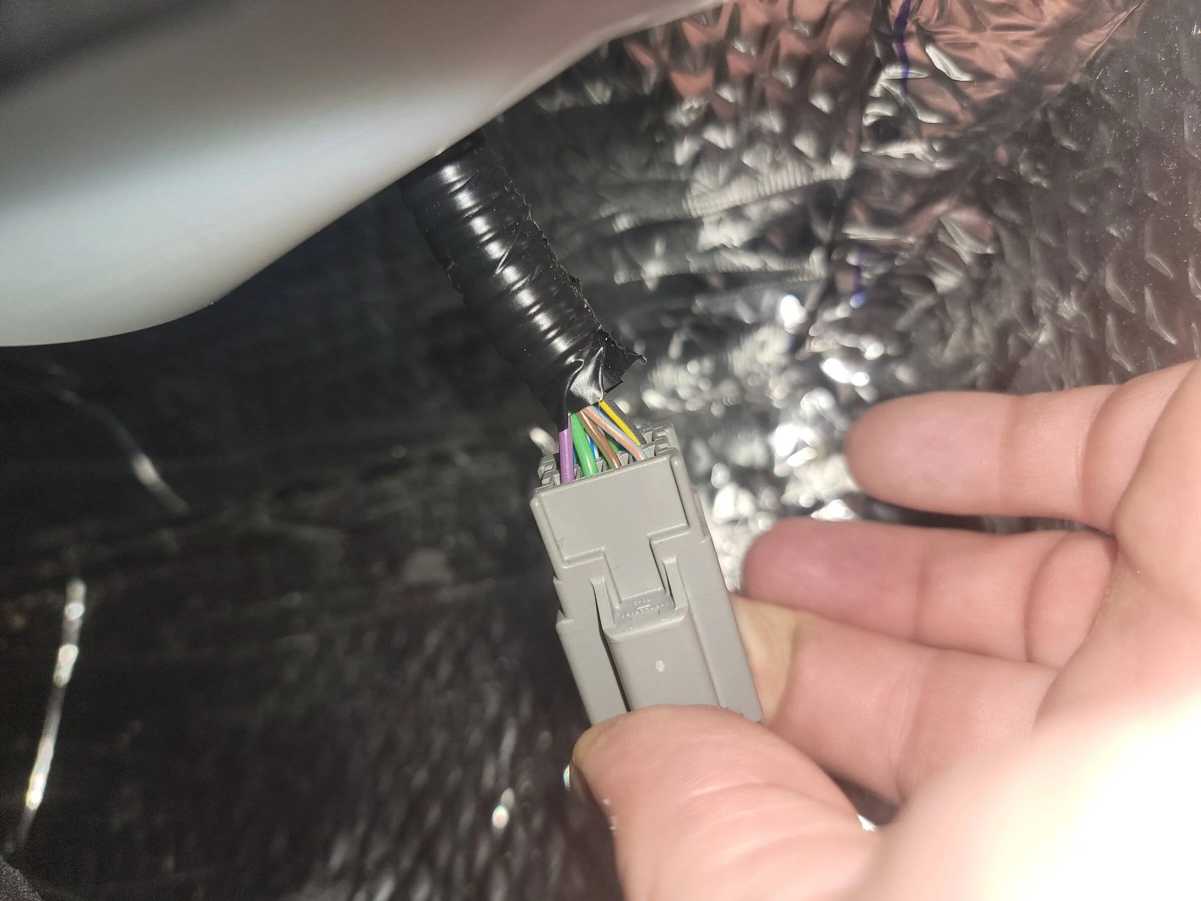

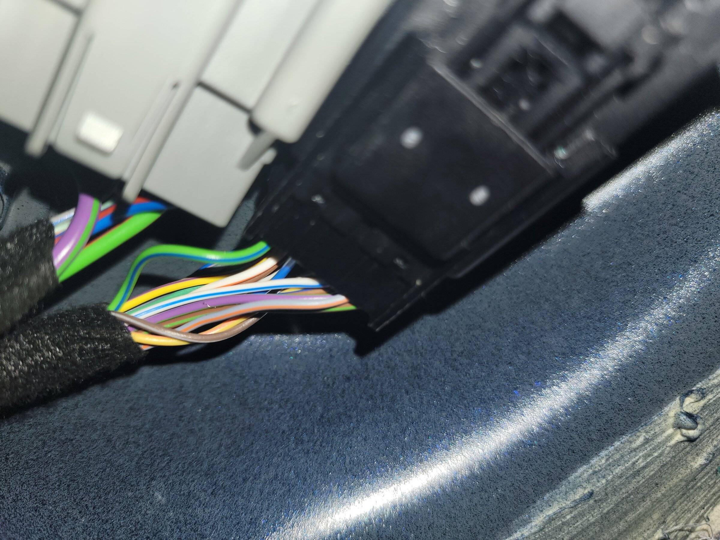

2020 gt 400a. I don't have the plug under the car, however under the spare there is a plug that goes to the evap system that has numerous wires terminating in. The colors match except the gray with an orange stripe. I looked at the c246 plug under the kick panel and the female side had the same colors listed in this thread except wires on pin 2 and 3 were switched, and again the gray was with an orange stripe. I am Ok doing it with the hard wired switch, but much rather do it integrated. Is there a chance they reversed wires in 2020 (late 2020 build, almost 21). Also, I think the wires in the trunk are the same. Without wiring it all up is there a way to check these are the wires.
1st photo is c264, you can see gray with brown, 2 and 3 are trunk plug.

Done! I found some local that had the JR3Z14A411H harness still attached, which was great as those are on order everywhere. The J harness was available but I wired without it, like everything else I couldn't wait. The bottom picture above is the plug in the back of the trunk that the evap lines go to. The AE stuff terminated into that plug, so I used wire splices to tap into that loom, then some bullet fittings to plug into. I also used taps in the J harnesses coming off the mufflers; so sort of made a harness in place of the J harness. I got an updated tune from LUND, loaded that, then went into forscan and into the IPC, filtered by exhaust, then I activated tuneable exhaust; and it works. I started at 730pm, and was done by 1100pm. This included having to cut the resonator off to fit into my current exhaust, mount it, then do all the wiring, and loading the tune and IPC. It wasn't bad, excited to drive it tomorrow.
One thing I will add, when I asked my exhaust guy about getting me some takeoffs he highly recommended against doing this. He said he has seen many cars at the strip throw codes as on the launch the exhaust moves back and the wires crimp or scrape on the back on the car. When I was mounting the exhaust it was obvious where there could be interference. I used a BFH to motivate the offending pieces of metal to get out of the way, should not have an issue now as I have plenty of clearance. Unless you are under the car, with the exhaust off you'd never know I did this; so don't be scared.

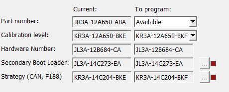

VonWatchmaker
Nov 4, 2020
Warsaw
2019 Mustang GT
Hey eveyone, my theory worked! You can enable Active Exhaust by only using Forscan in the 2019 Mustang :D
For those who do not know how to start, just check comment #676.
If you are on a Mustang 2018, everyting should work right out of the box, but if you have a later year model, you need to continue reading.
Now comes the part that could potentially brick your PCM.
After checking over 100 As-Builts from US Mustangs with and without Active Exhaust, I found the following:
Mustang packages:PCM Calibration / Strategy
2019 GT M6 no-AEKR3A-14C204-ACF
2019 GT M6 AEKR3A-14C204-YF
2019 GT M6 PP1 no-AEKR3A-14C204-ACF
2019 GT M6 PP1 AEKR3A-14C204-ZF
2019 GT M6 PP2 no-AEKR3A-14C204-ACF
2019 GT M6 PP2 AEKR3A-14C204-ZG
2019 GT A10 no-AEKR3A-14C204-BJE | KR3A-14C204-BJF
2019 GT A10 AEKR3A-14C204-BFE
2019 GT A10 PP1 no-AEKR3A-14C204-BKE | KR3A-14C204-BKF
2019 GT A10 PP1 AEKR3A-14C204-BGE | KR3A-14C204-BGF
2019 BullitKR3A-14C204-XG
2019 EB M6 Perf AEKR3A-14C204-BBD
So, I flashed on my 2019 GT A10 PP1 no-AE (KR3A-14C204-BKE) with a calibration from a 2019 GT A10 PP1 AE (KR3A-14C204-BKE) and it worked!
I know that it can be done by VCM2, UCDS and Forscan 2.4.x beta.
The files needed to flash can be found here: fordtechservice

I’m reporting in here, I’ve done that calibration in a 19’ GT with a pp1 and it works without a tuner!
