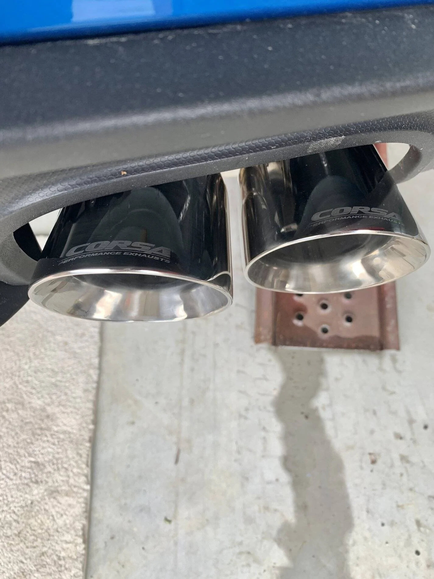

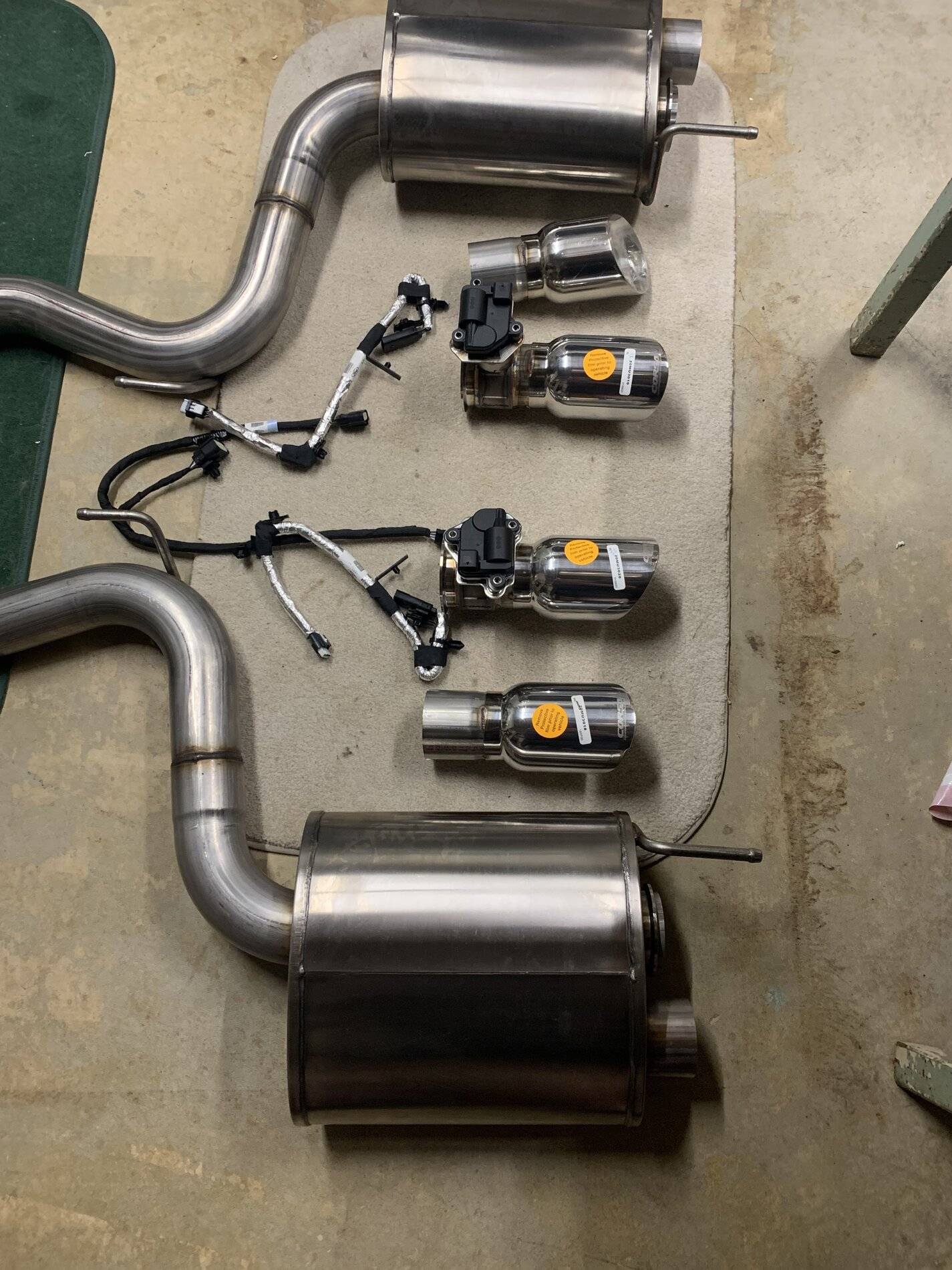

Finally got around to installing my Corsa AE system and completed the upgrade on my 2019 GT. Sounds amazing and 'Quiet' mode will be keeping my neighbors and girlfriend happy. Only issue I had was figuring out how to correctly secure harnesses going to the actuators - one plastic plug made sense as there was a corresponding hole to press it into by the connector but at the actuator end I found a hole that might work but is to small. Can anyone provide insight?

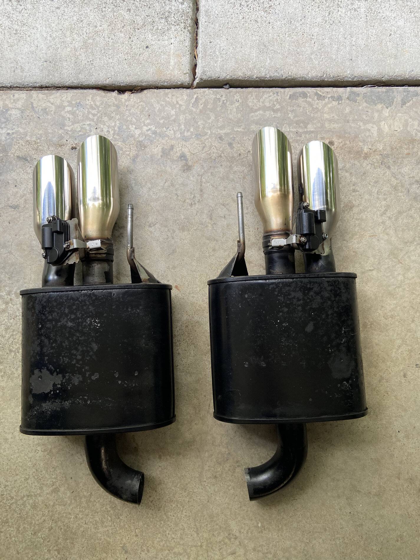

To the best of my knowledge ALL active exhaust are welded to the muffler. If they come complete with the actuator. I assume that would be part of the assembly.
Got tired of setting loud every time I started the car, so Roush fixed that.
New parts 500 miles old, need to be sold.
Why are they black, cause they disappear when looking at the rear. A cleaner look, exhaust tips are all that is noticed
The tips are separate items on my Corsa's so the valve is separate from the mufflers.

Interesting mounts with band clamps? A good idea, one could build the system out in steps.

Sound is incredible - Quiet mode is much quieter than stock unless at WOT, Normal sounds like their 'Touring' axle-back, Sport sounds like their 'Sport' cat-back, and Track is like their 'Extreme" cat-back. Neighbors and GF appreciate Quiet mode and I love Track everywhere else :D
