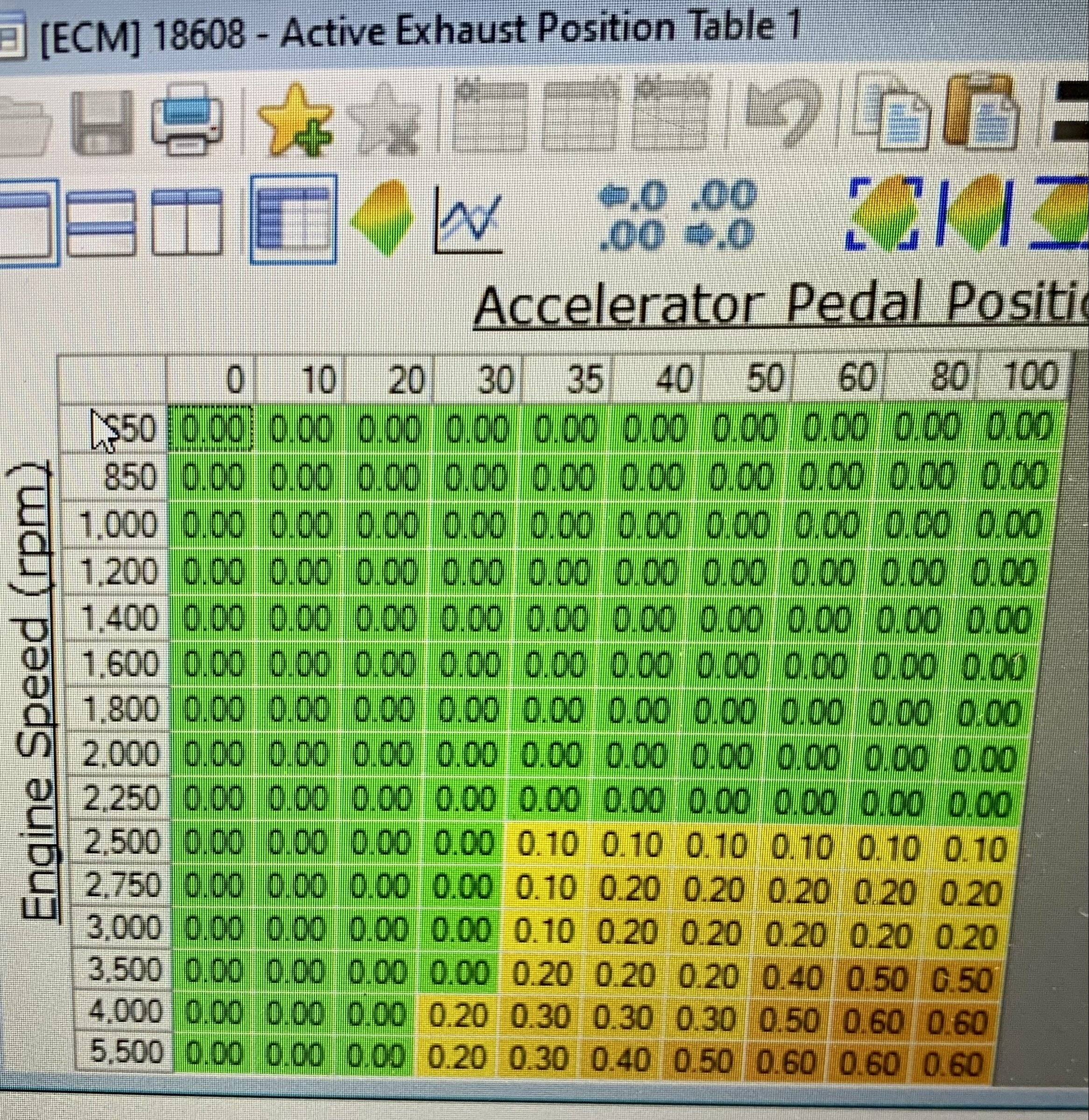

Curious to get some of your thoughts.
I added active exhaust mufflers to my 19 GT PP but just run the motors off of a switch I added in by the steering wheel. works great and I can open and close the valves as well as adjust anywhere in between. My only concern is does keeping the valves closed all the way have a negative impact on the car?
I know that the active system in quiet mode will still open the valves at full throttle so I’m curious if there is enough flow through the quiet side of the mufflers when leaving the valves closed off.

Ford's strategy for 'Quiet' mode...
I have Corsa AE mufflers on my GT, the valve modulates air by closing the straight thru path which forces air into the case of the muffler and out the secondary tail pipe. I would guess that with the valves closed at higher RPM will hurt performance at a minimum and worse case could cause the PCM to throw a flag just like a clogged cat could.

Very helpful, thanks for posting that. I knew the valves were opening under normal quiet mode operation, I guess I still wonder how much keeping them closed would choke things up. Luckily I don’t drive like that very often, but good to know how things may respond.
