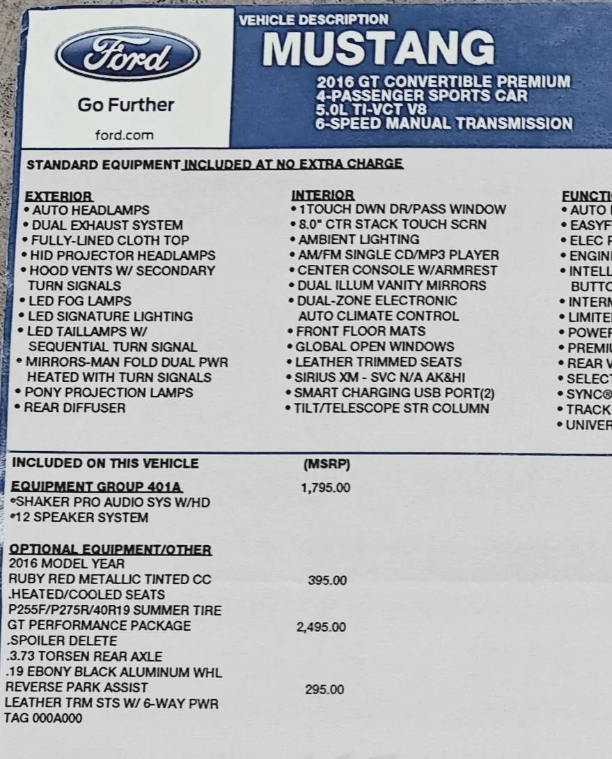

Just bought a sweet 2016 GT Convertible with Performance Package. As I understand it, this brings 19x9.5" wheels and staggered tires 255/275. Would it be unsafe or just sacrifice performance, to put 255's all around? Dont really want to do it, but having trouble getting 275's from my usual source. Thanks, a S550 newb.

The 9.5" wheels are the rears; fronts are 9". The 255s might fit on the rear wheels, but they'll be stretched and have a smaller diameter. Why not find a different tire source? There are many choices of tire brands and stores available for the 255/275 combo.

Didn’t thought that pp1 was available on convertible in 2016
Can anyone confirm or not ?

Newb mistake number 1 - thought wheels were same width.
I think it wasn't available with auto transmission - from what I remember.
