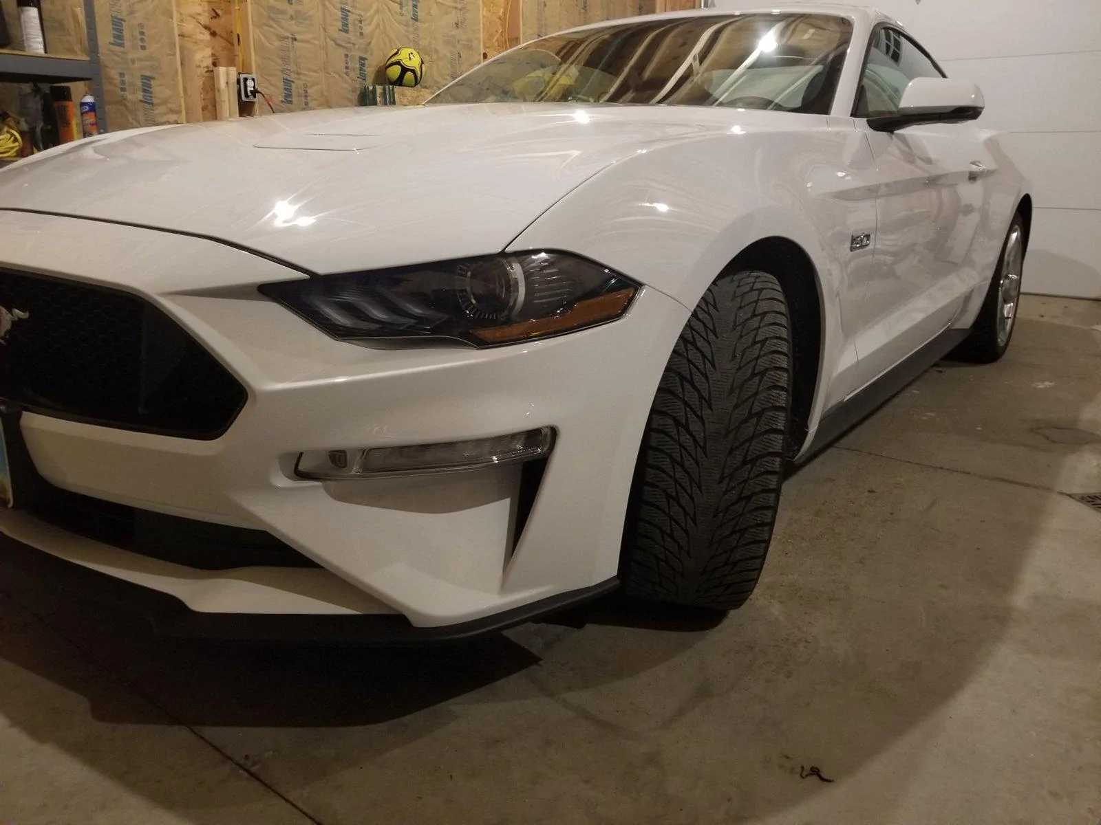

#1. NOTHING beats Nokian Hakkas in the winter!
#2. Id highly suggest some winter wheels. Trying to run snows on PP2s is going to be A. expensive for that wide of wheels. B. Slightly skinnier winter wheels would work better and cost way less. C. Wheel and tire package with narrower wheels would likely cost less and have far more options than looking for wide snows that fit the PP2.
#3. Nokians are worth their weight in gold trust me I live 80 miles north of Fargo ND. This will be winter #3 on Nokians. Dont regret it for a second!!

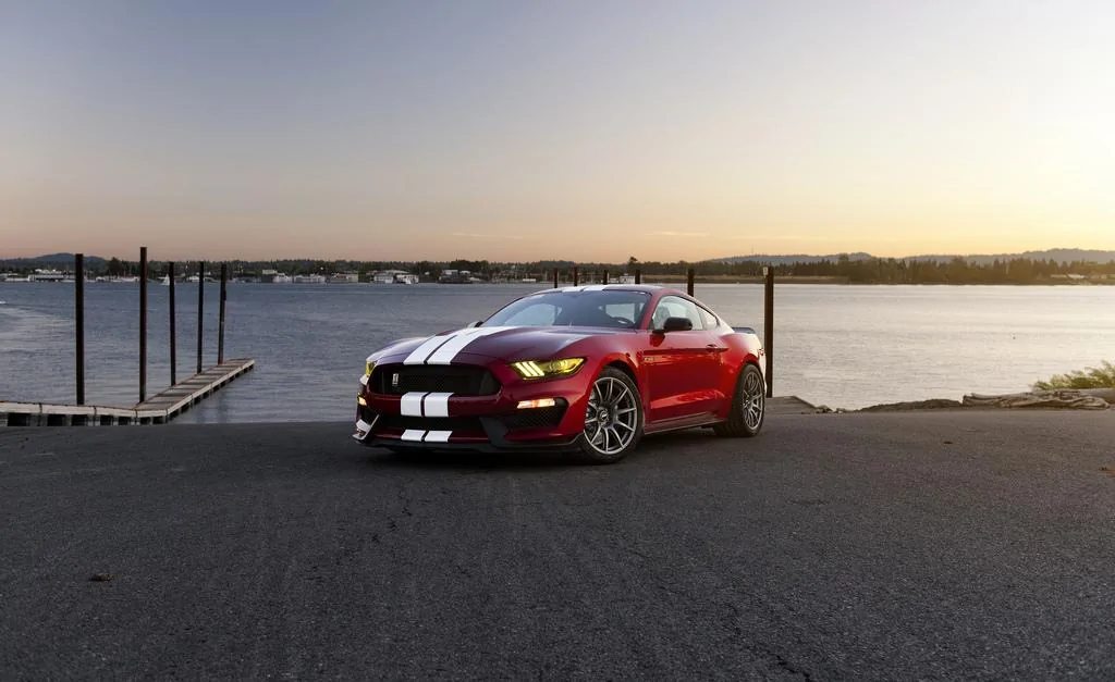

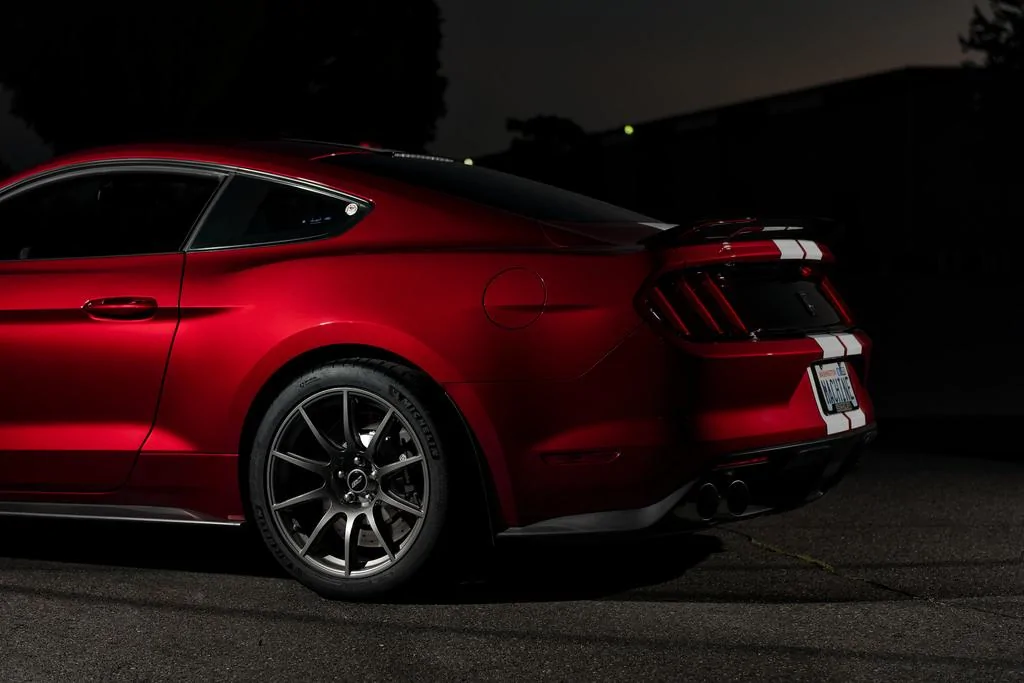

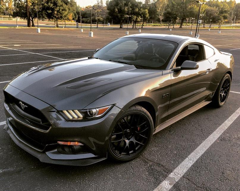

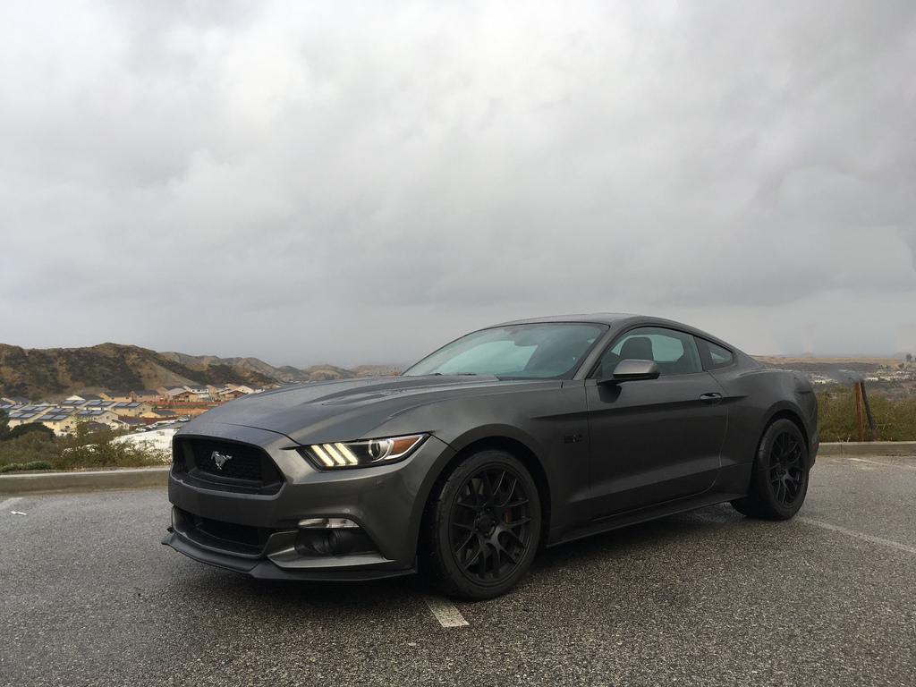

We currently do not produce a 10.5" wide wheel, but we do offer a 10" wide and 11" wide in both EC-7 and SM-10. Using a 10" up front with all season tires can be beneficial for a couple reasons. First being less weight and less cost, second being that the slight reduction in contact patch will likely go unnoticed given that these kinds of tires aren't geared towards all out grip. Going with a 19x10" ET40 front and 19x11" ET52 rear would make for a great daily driver setup on the PP2 and has plenty of tire options with 285/35-19 up front and 305/30-19 out back.

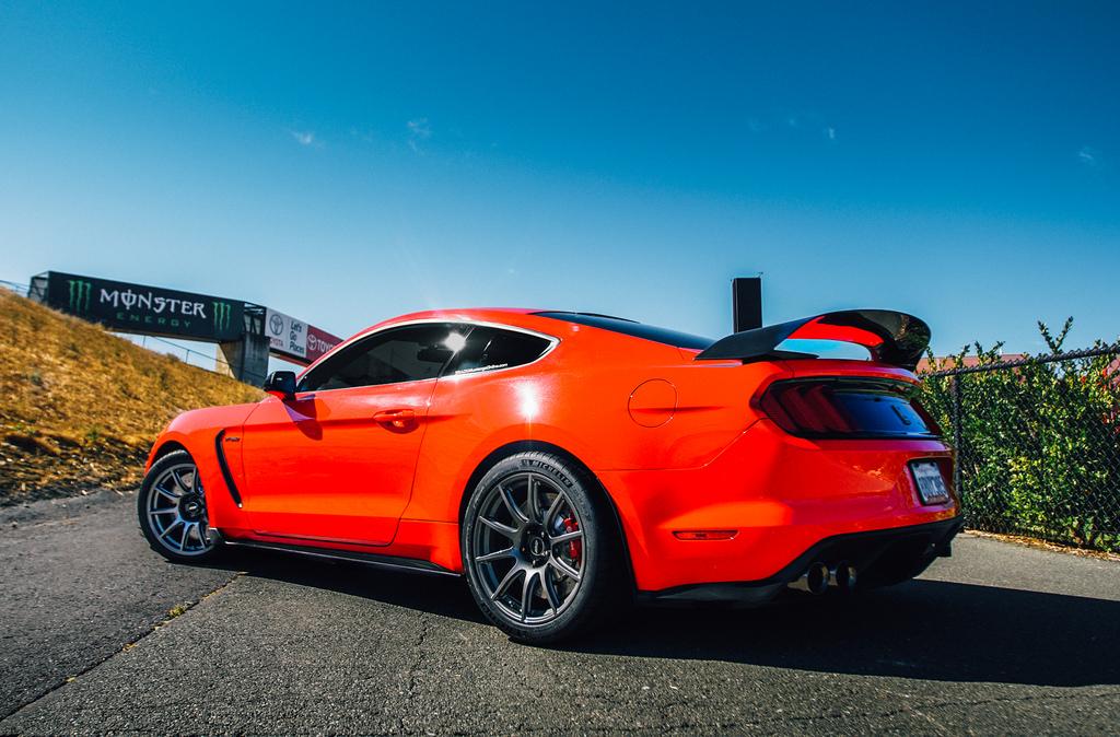

Not quite the sizing you are after, but here are some images of the SM-10 on a couple lovely GT350s.
This GT is running 19x10" ET40 front and 19x11" ET52 rear.

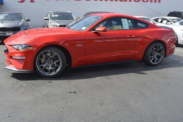

I bought “take offs” from PP1 car 255/40 275/40
Still had stickers on the rims when I got em.$1595.00 free shipping.
The car rides great as driver, keep oem for track, too expensive to wear out around town.
(Same car before & after painted stripes, wheels changed)
