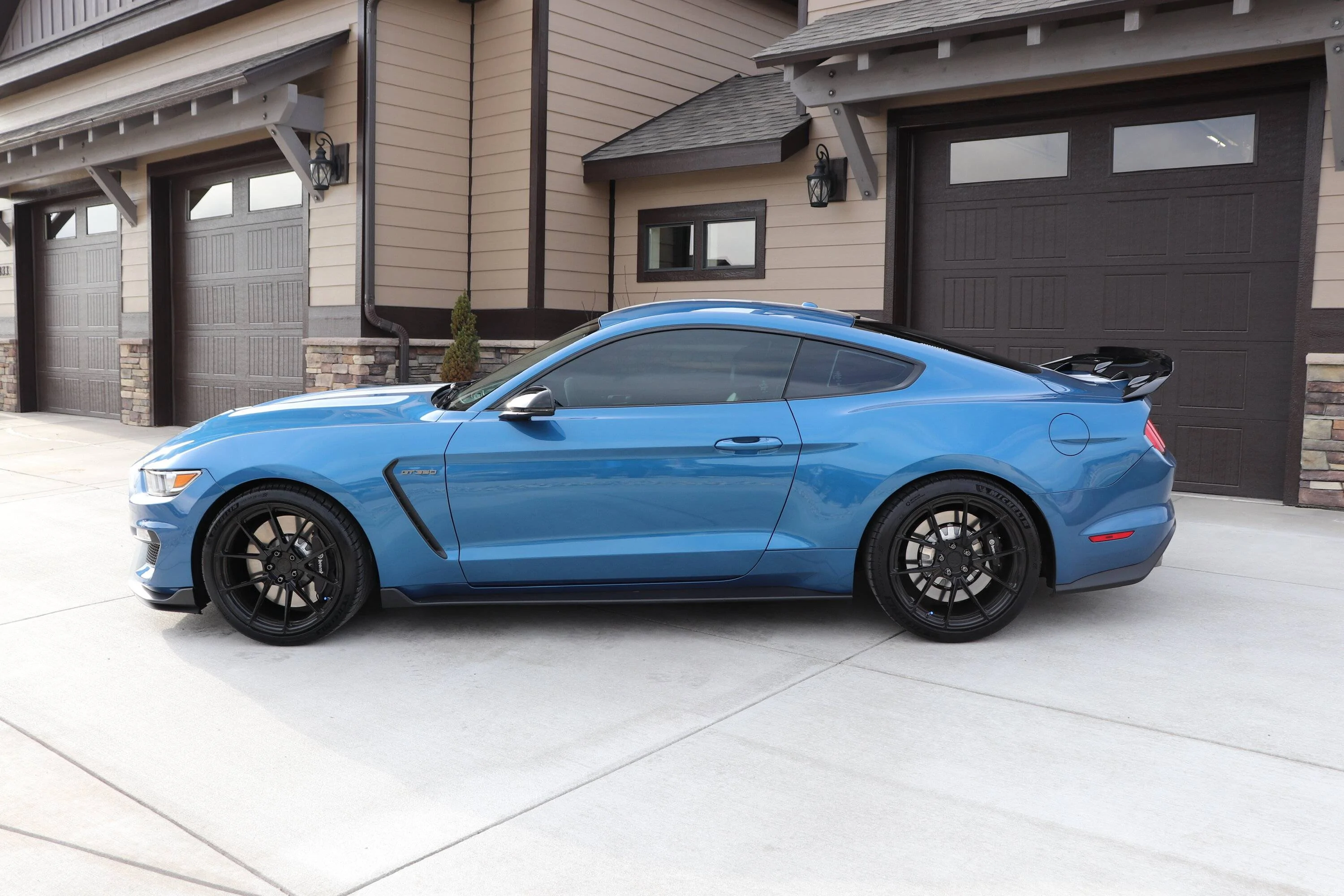

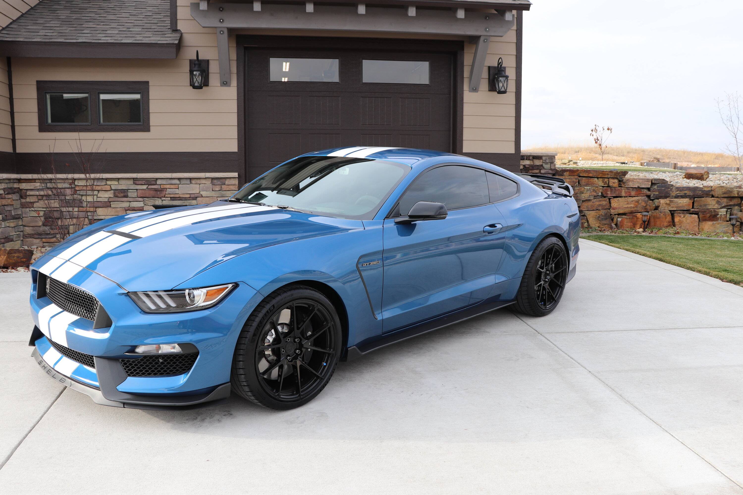

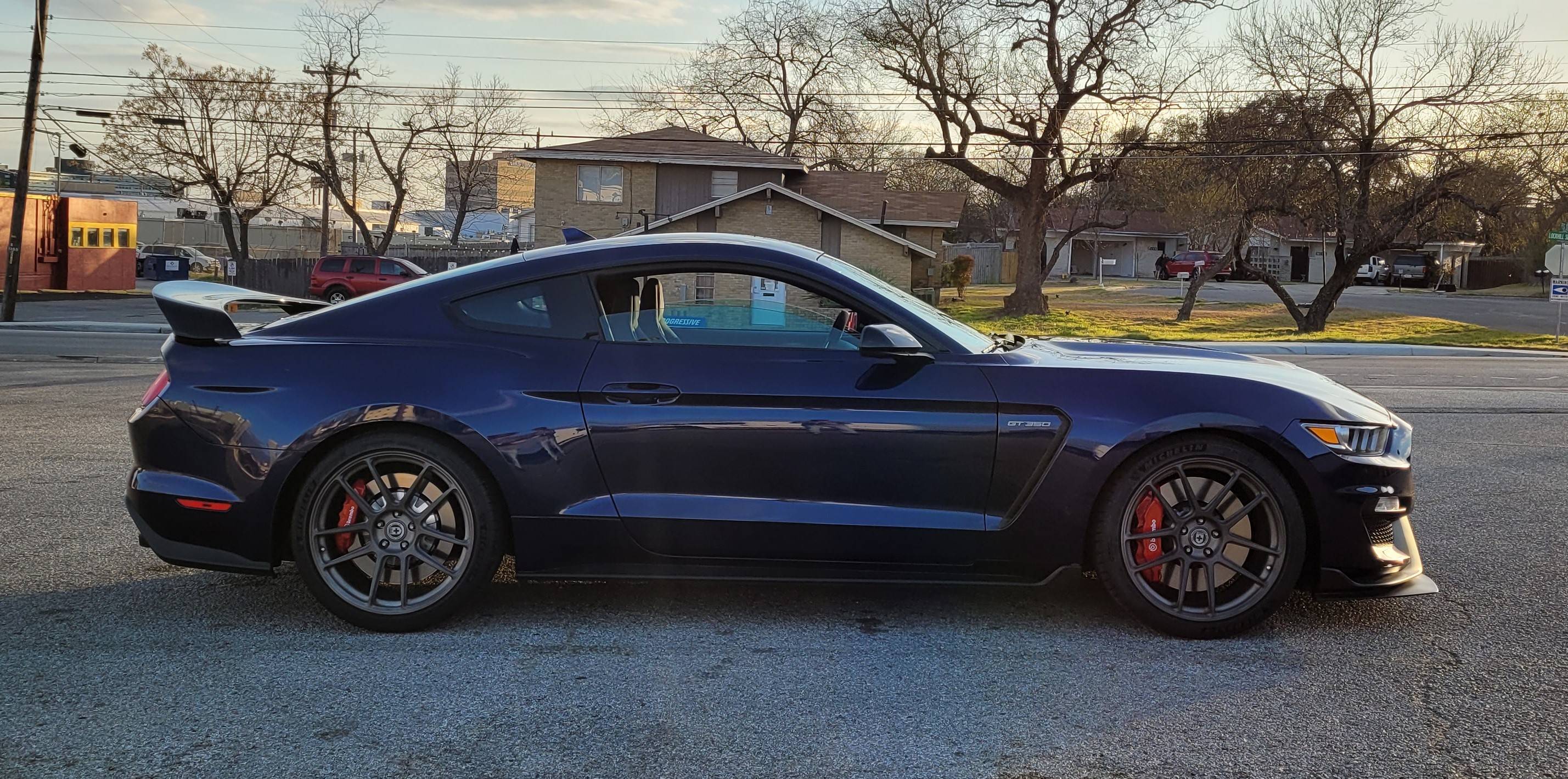

I’ve got the 19” Apex forged wheels on my GT350, 11.5” wide, ET56. Am running 315/30 Continental ExtremeContact Force tires, which are a pretty beefy tire. Here are a few photos.

your 350 looks awesome! what offset are you running on front and rear? Thanks.
Not exactly sure since I bought these as a new takeoff set directly from Vossen. I believe they are close to stock offsets. I will have them off for a cleaning soon so I will figure out the offsets.

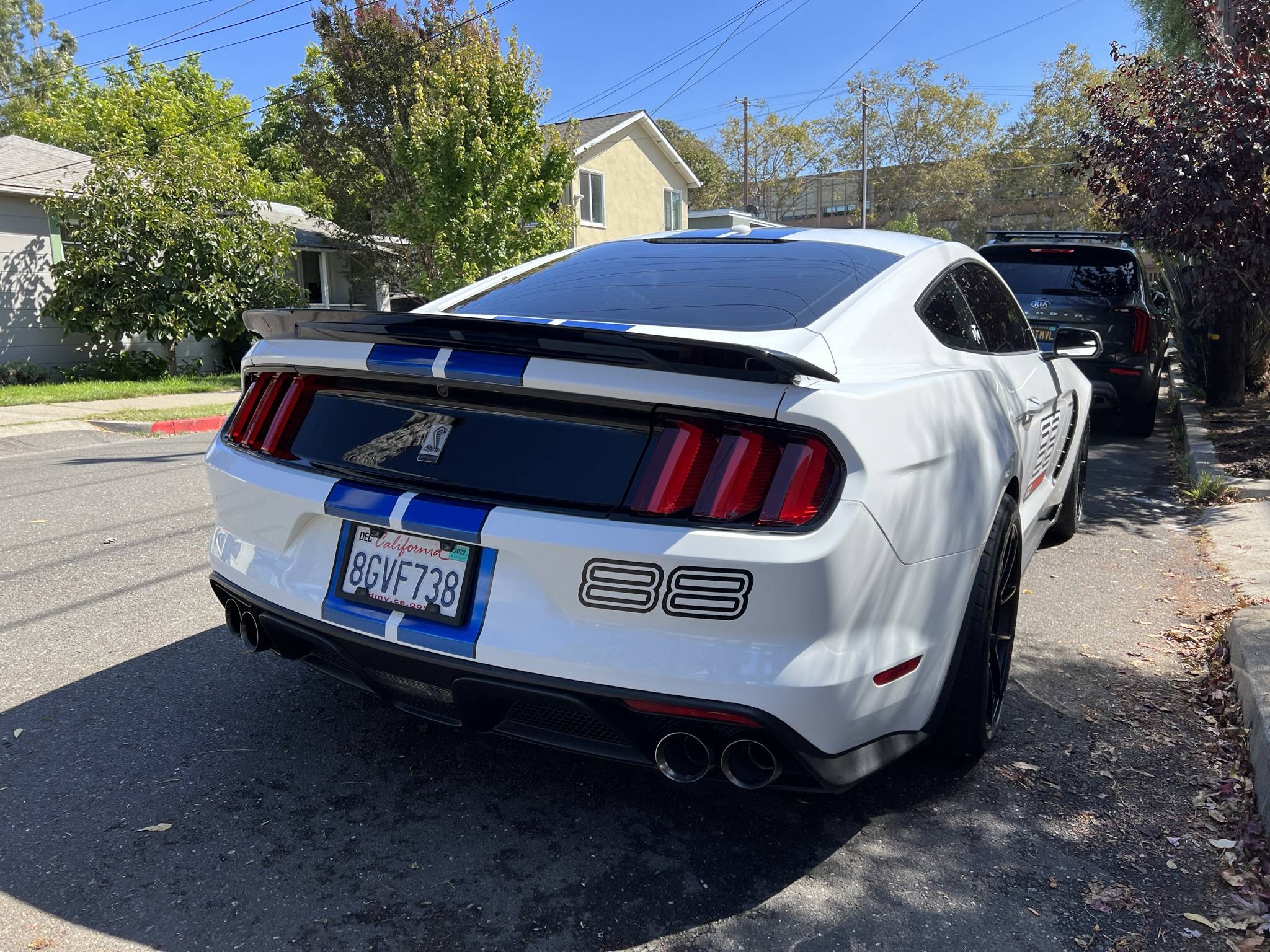

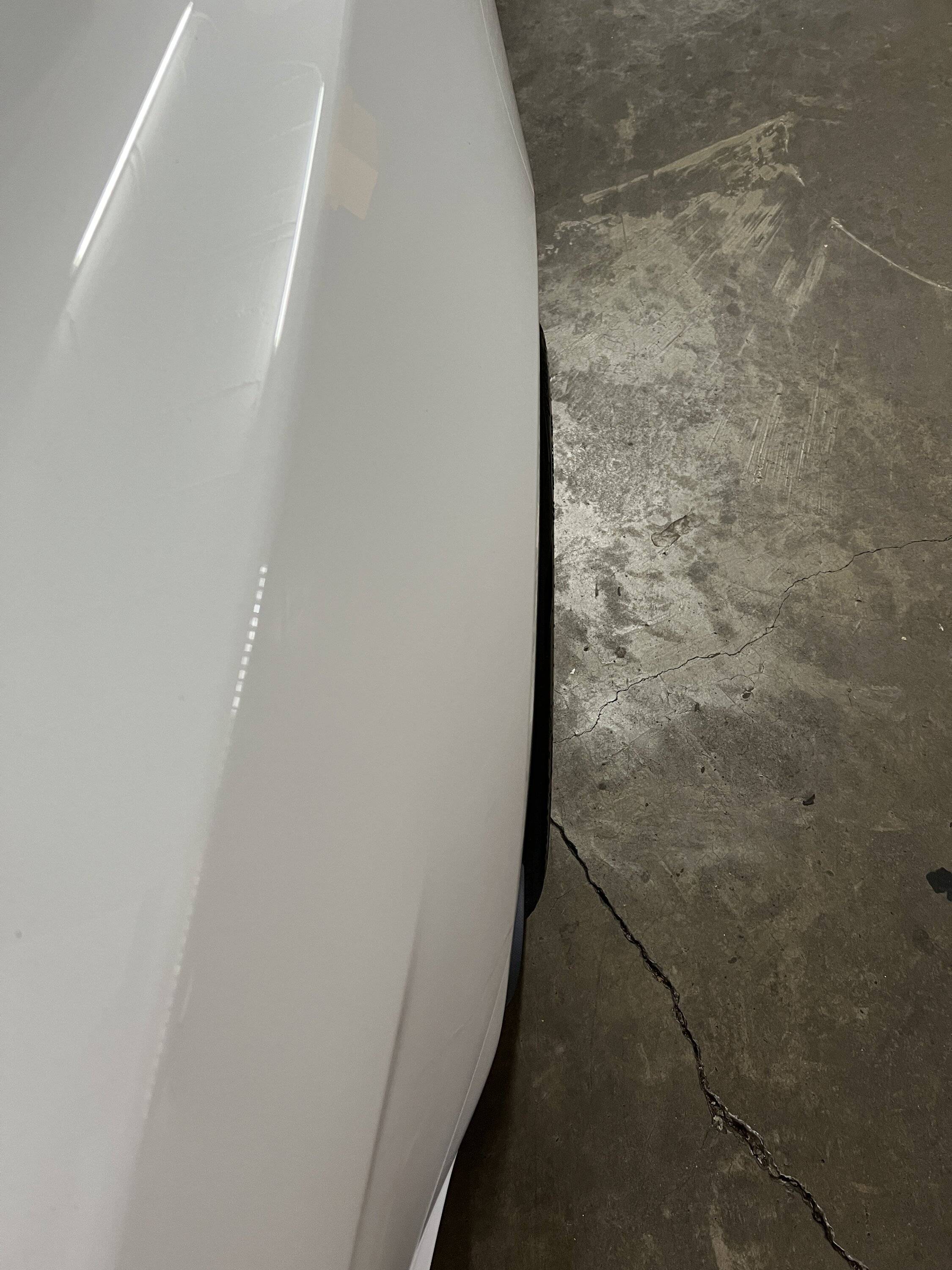

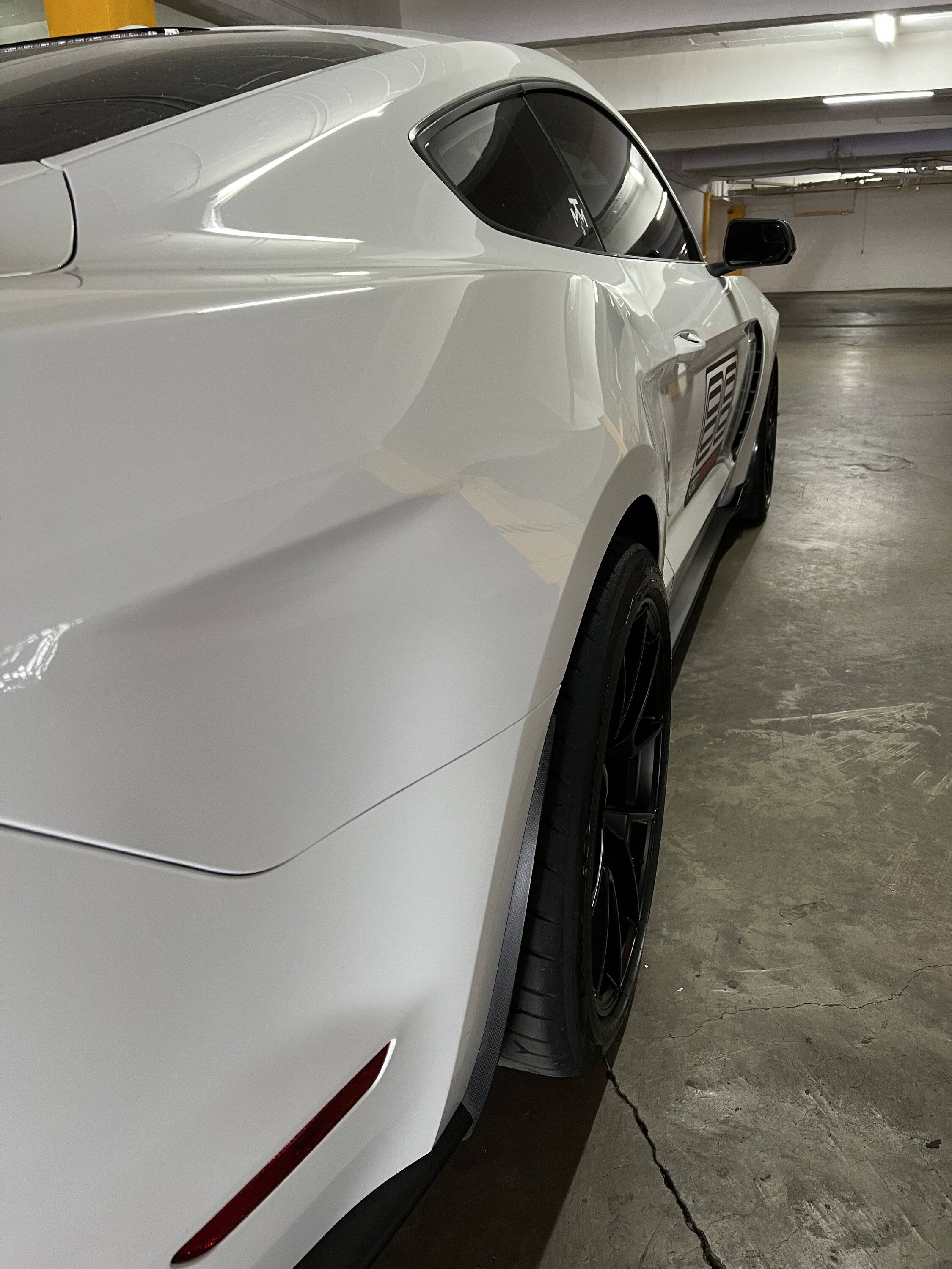

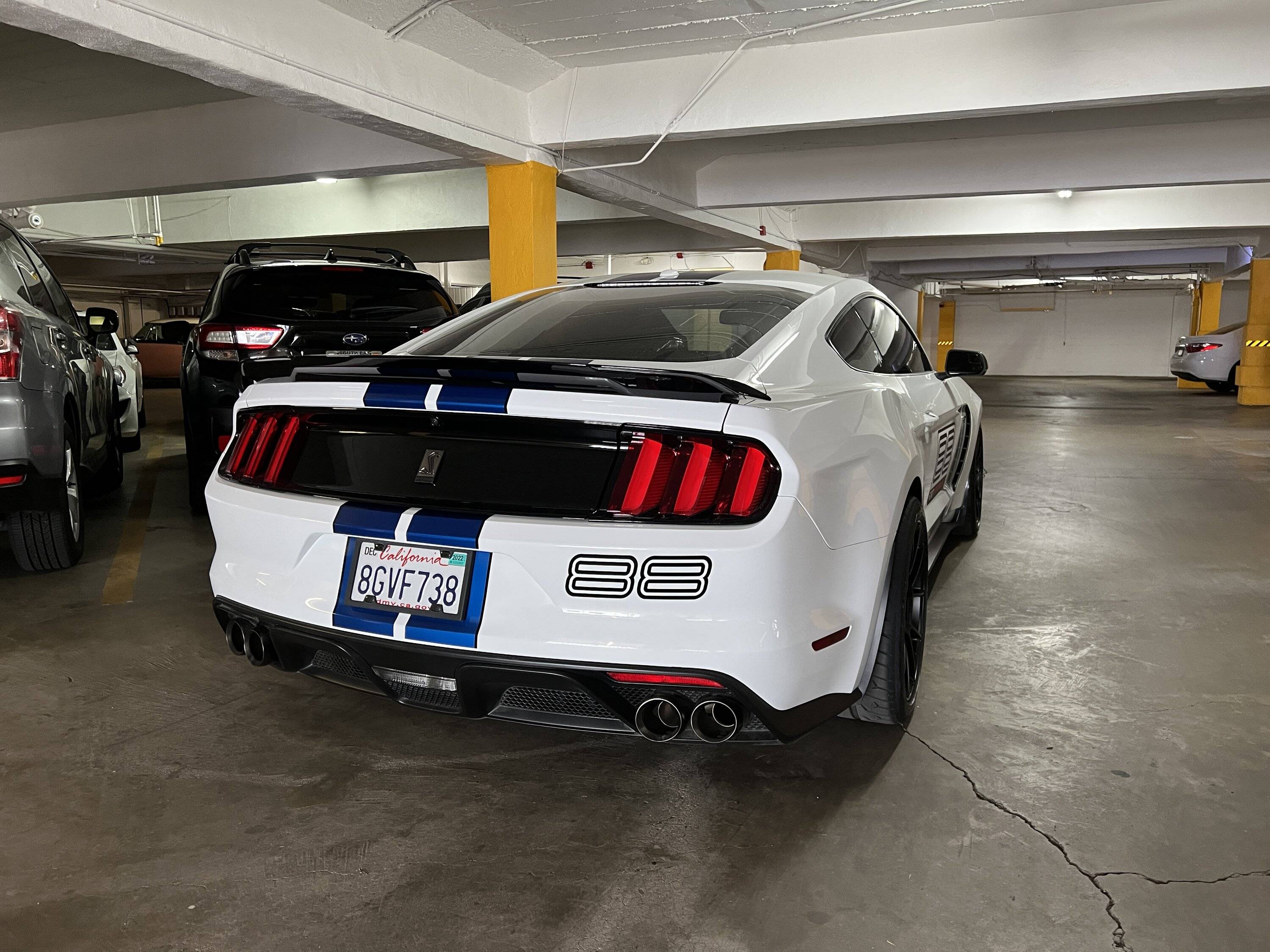

good Lord that is schexi…but I already need to cross into oncoming traffic at a 60* angle to get into the driveway at work, i cringe at the thought of trying any lower 😂
If you are marginal now then you will scrape for sure!! Ford says they are 3/4 inch lower but I think they are closer to 1 inch lower.
