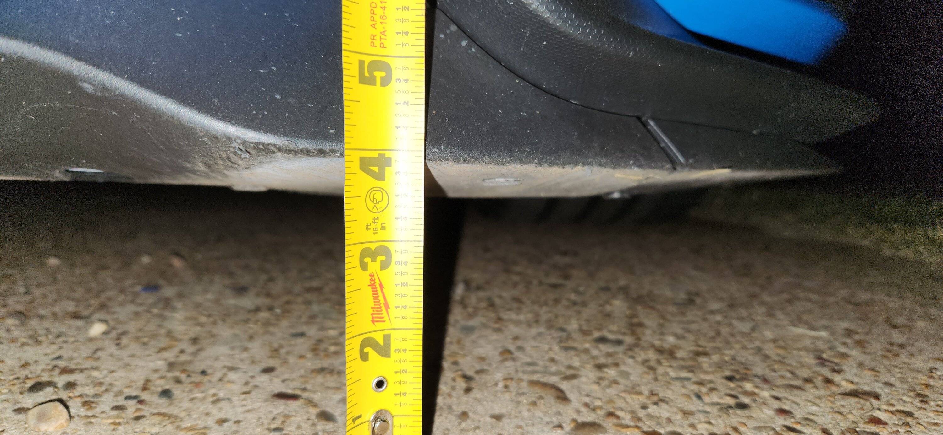

this is what I'm going for what size tires are you running and do you know what the clearance is between the front splitter and the road

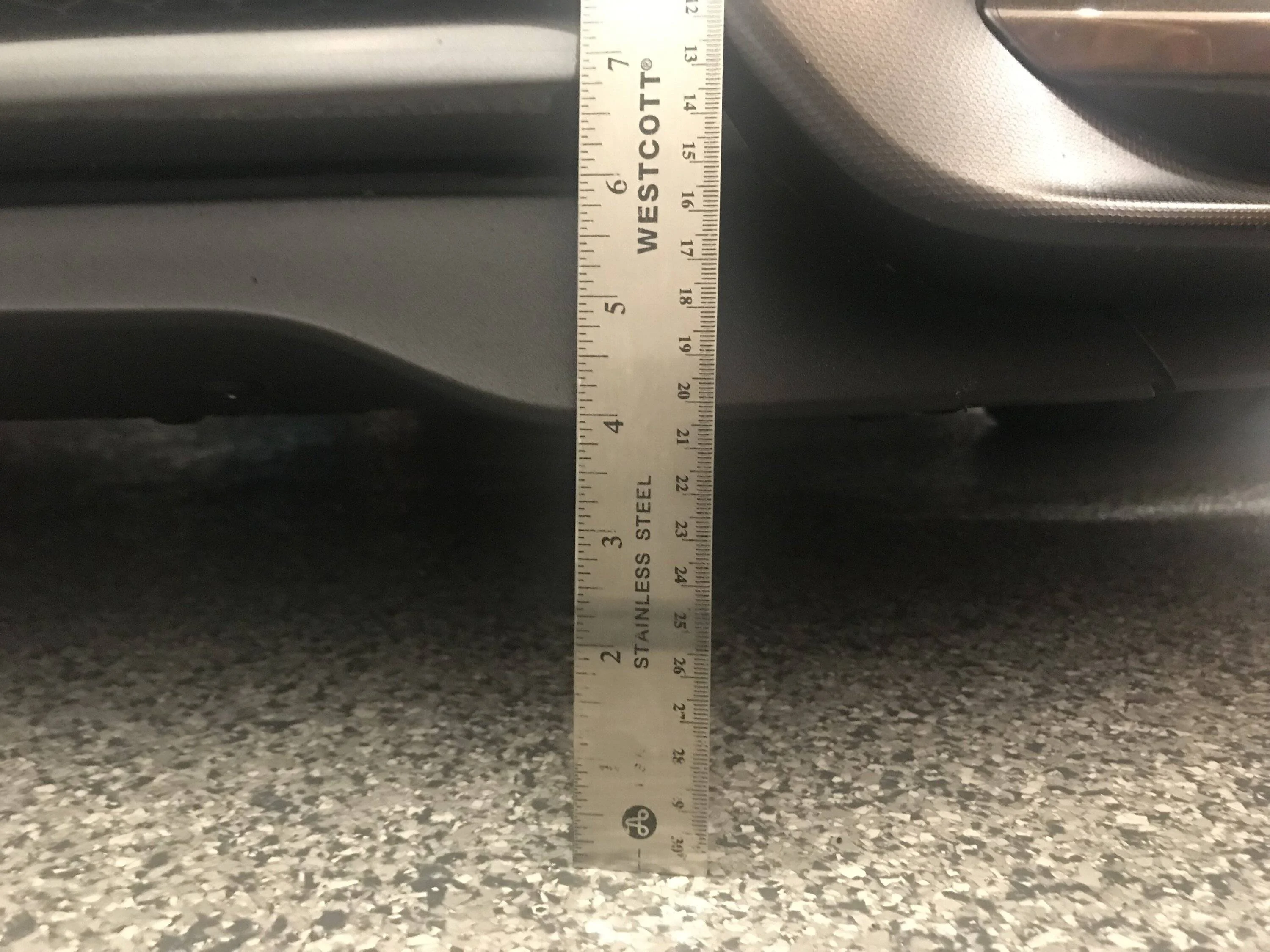

Hey Mech94 -
20X11 wheels front and rear, 295/30ZR20 front, 305/30ZR20 rear Michelin PS4S
Clearance on the splitter is low. 3 7/8 at the front edge of splitter and tight clearance on 3 1/2 under the main sections of the splitter past the leading edge.

thank you will measure mine tomorrow and see how much lower it will be

looks like I'm right at where you are on stock wheels and 305/30/19 ps4s on the front with stock springs so maybe going to the 20 with 305/30/20 will give me a bit of clearance since I rub almost everywhere I go

According to tiresize.com and their tire comparison calculator you will gain 1/2" inch by going the 20 inch wheel and tire combo.
