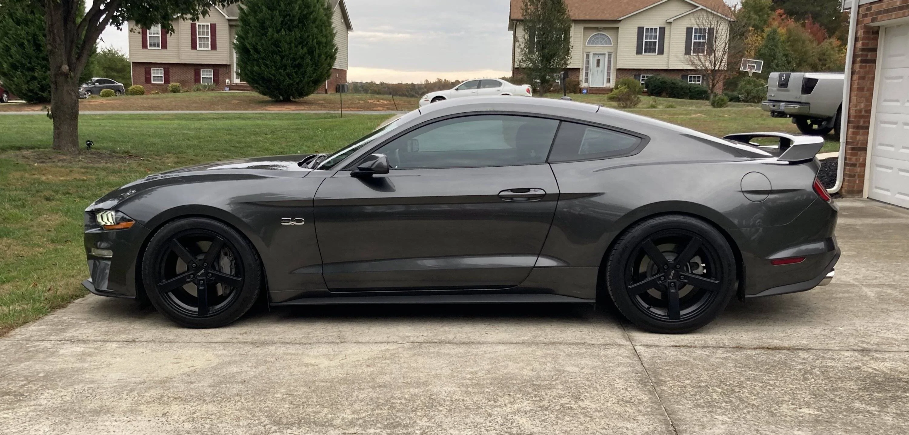

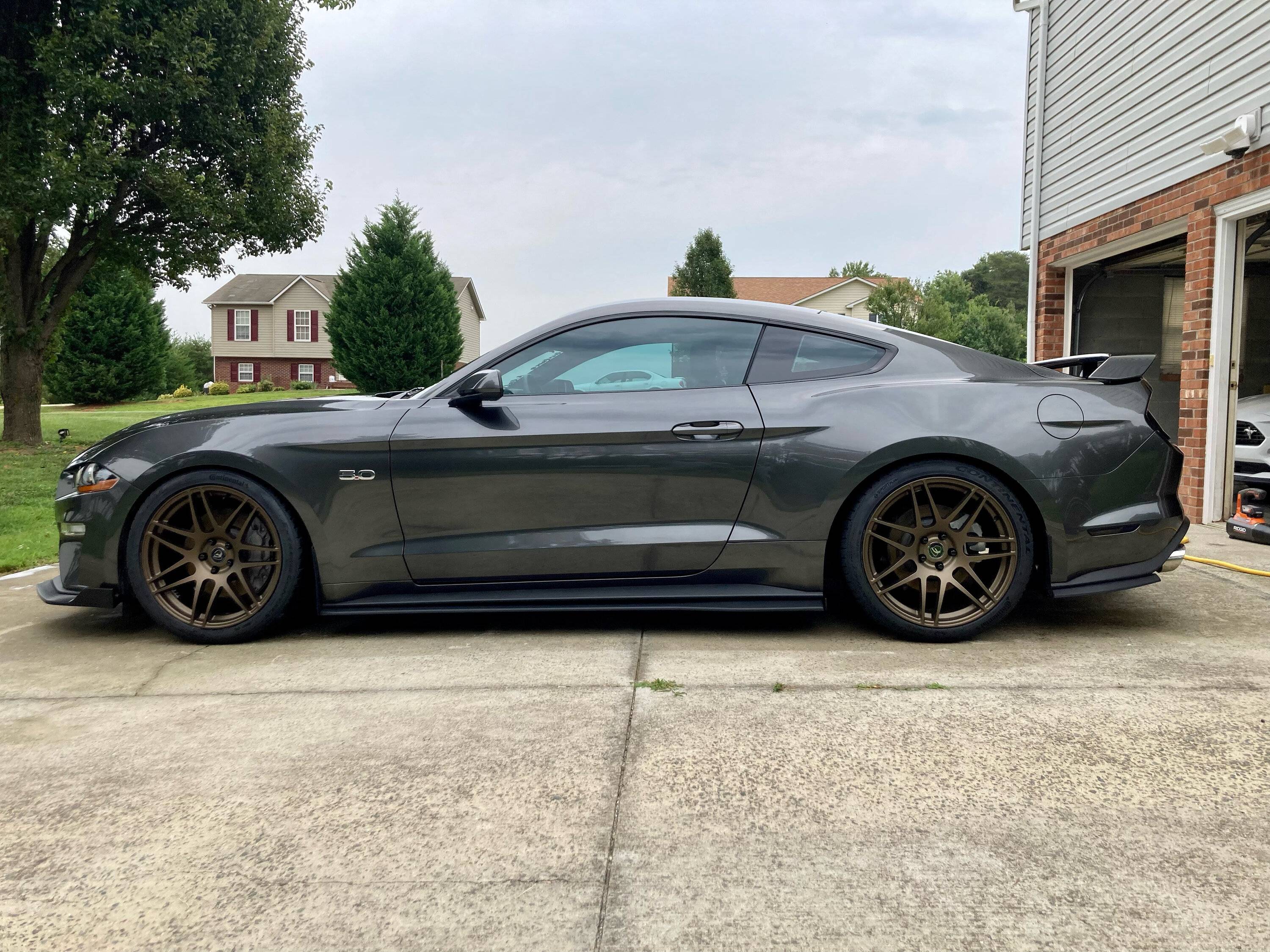

I have ran both. If u want ride go 19x whatever.
looks 20s for sure
Bronze are 20s
Blk are 19s
looks 20s for sure
Bronze are 20s
Blk are 19s
Thanks for posting this. Same car, same location, same angle. Makes seeing how much better 20” look so easy. My mind is made up for once I have $7500 to dump into new wheels and tires: 20” 30 series.
No problem. I was in the same boat before.
