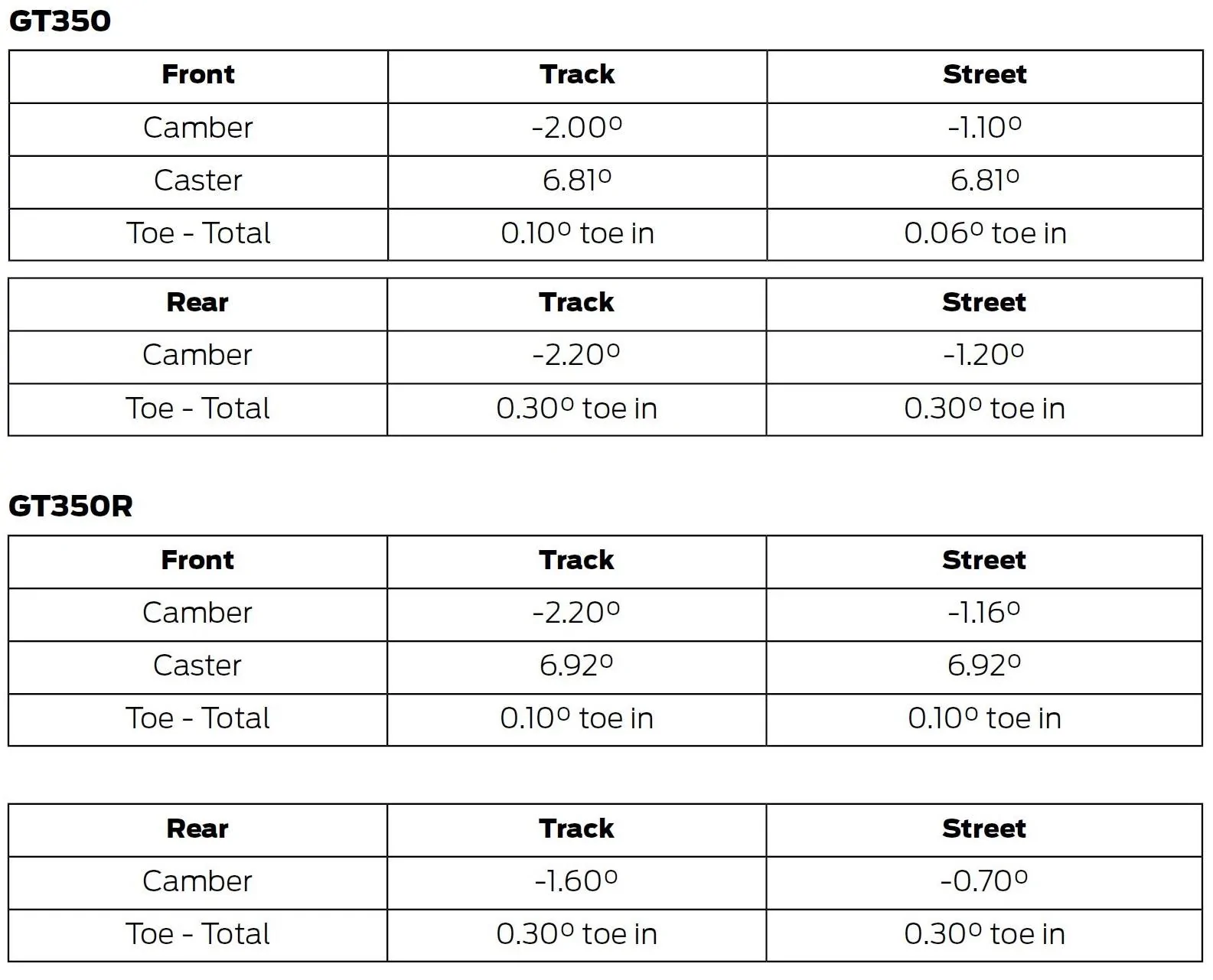

The recommended alignment settings are different as well. I wonder if something has changed? Or maybe they're just pushing a more optimal alignment. Seems many here have been disappointed with the previous recommendations.
still seems like front is too light, I'm gonna start with -3 front and -2 rear assuming I can get those numbers w/ the factory stuff.

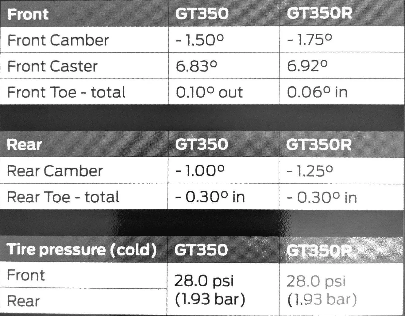

2018 vs 2019. I'm surprised to see the front toe go from 0.1* out to 0.1* in.

It think most people believe it was a misprint and should have been 'in'. The 2019 settings looks much closer to what I expected from 2016-18 models. I suspect real world feedback has adjusted the 2019 numbers to a more reasonable track setting. The 2019 GT350R settings are very close to what I run on my 2018 GT350.

More things are different for the regular GT350. Front spring rates are higher, rear springs rates are lower, rear stabilizer bar the same as the R. To me it looks like they made it closer to the FP springs without the drop. And the alignment settings finally make sense.

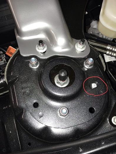

Anyone got the real (non-prototype) numbers yet for the top plates? I looked through the hole in top of the tower and saw KR3V-5310-EB on the label on mine, but the dealer couldn't remember if they installed them or not :facepalm: so I want to verify that's the adjustable ones. Local stores didn't have a big enough torque wrench so I can't pop the wheel off to look if there holes under are oblong or not.

My mechanic doesn't know how to use the adjustable strut mounts to change front camber on my 350R...did you do this yet? Any instructions?
(they seems to be different than my Steeda plates for my GT)
Also can you change rear camber at all?
i had dealer align it so not sure, i assumed loosen the 3 bolts and it should move....
they got -2.5 in rear with stock parts.
