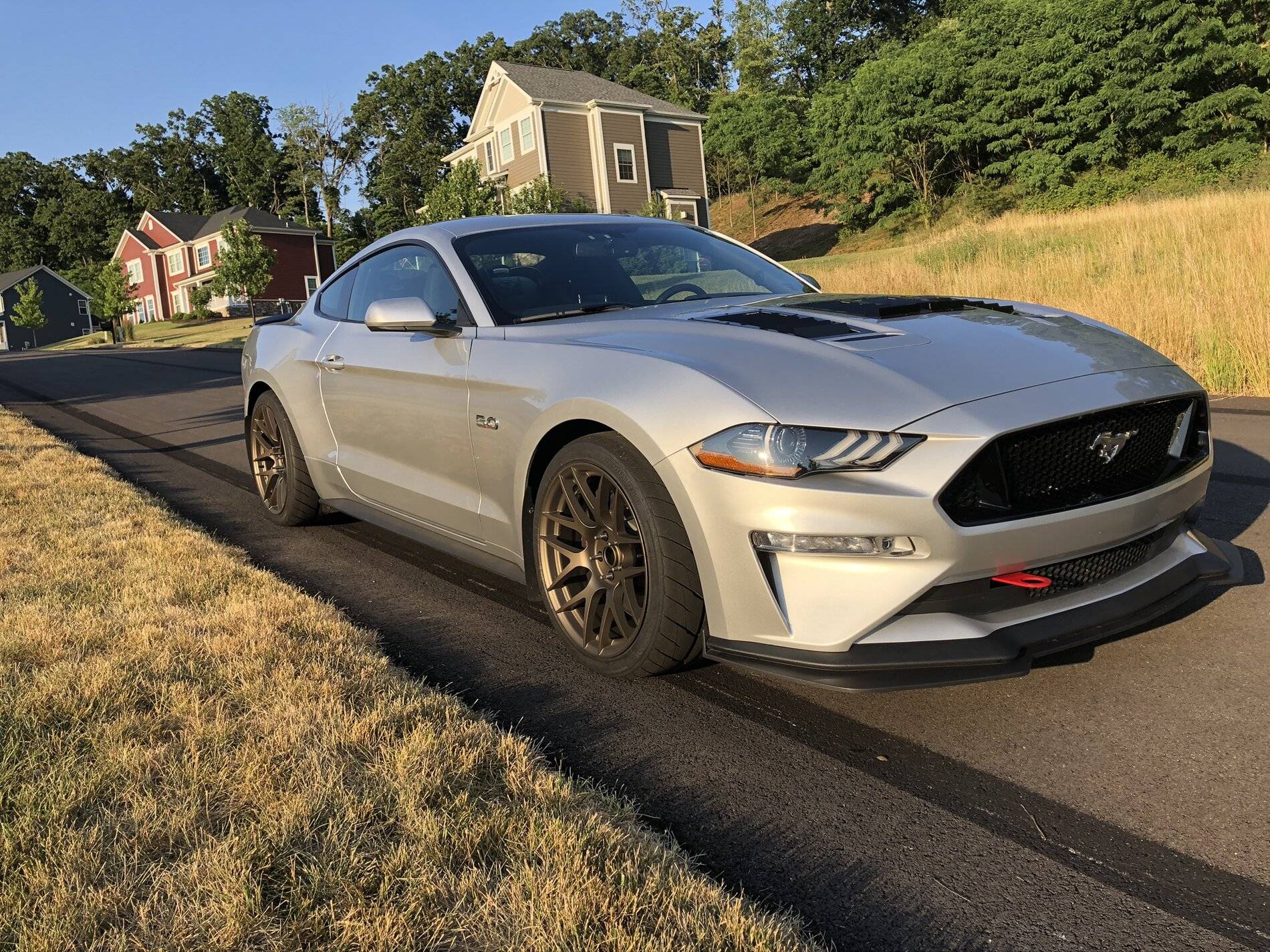

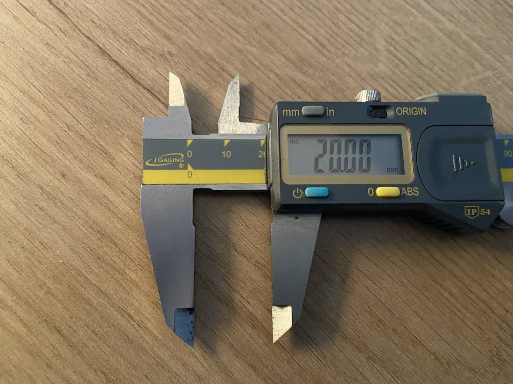

19x11 square +50 w/ 305's. Was able to use a 20mm spacer in front with plenty of space between tire and shock.
Plenty of room, were they rubbing, something I hadn't thought of. Those are the PP2 wheel, 2019 ?
You sure bout 20mm, pretty damn big spacer ? I mean anything is possible, and could explain why Ford staggered the wheel.
Think I need to leave the wheels sealed, mount the rear up front, check this. Thanks for the heads up... :thumbsup:
That’s a PP2, isn’t it? I got away with a 20mm spacer on my Magneride car as well, but a number of folks have had to go with 25mm spacers… I suspect there is a difference in MR vs regular hubs/spindles, but have no info to back that up. Measure twice, spend once…

Yes it is a pp2 Just checking lacking 3/4 = 20mm, so I might push this off. Not liking the spacer idea.
Going to cancel the wheel order, not delivering until 11/7, so just a paper work deal.
Next oil change I' ll jam a rear wheel in, go/no ..... go. go reorder.
Appreciate the red flag on this :handshake:
Yup 100% positive. I used a 20mm but could be due to unique PP2 knuckle and hub or mag ride. Most the interwebs say a 25 is required.
I like to be able to rotate. I even run them backwards rotation when dry.
I’m not sure what there is to be scared of with spacer?
I tested mine pretty regularly going airborn over gnarly curbing at the Glen and Road Atlanta.
Plan to run same setup on my Mach 1 if my order manages to squeeze through.
None of us track guys are talking about bolt on spacers with 40 total fasteners holding your wheels on the car. We're talking extended wheel studs and slip on spacers, which are proven reliable in motorsports and on the street.
The PP2 rear wheel is ET48 IIRC, which with the right camber could fit on the front of a GT with about a 20mm spacer. A lot of aftermarket 11s are 50 or 52mm, so a few mm here or there will add up to slightly different spacer thicknesses needed. 11s on the front of a street car is completely overkill. Fun tho.
