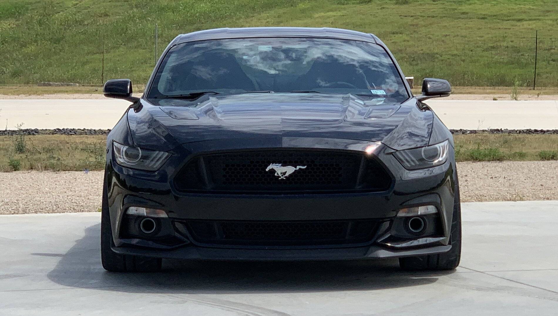

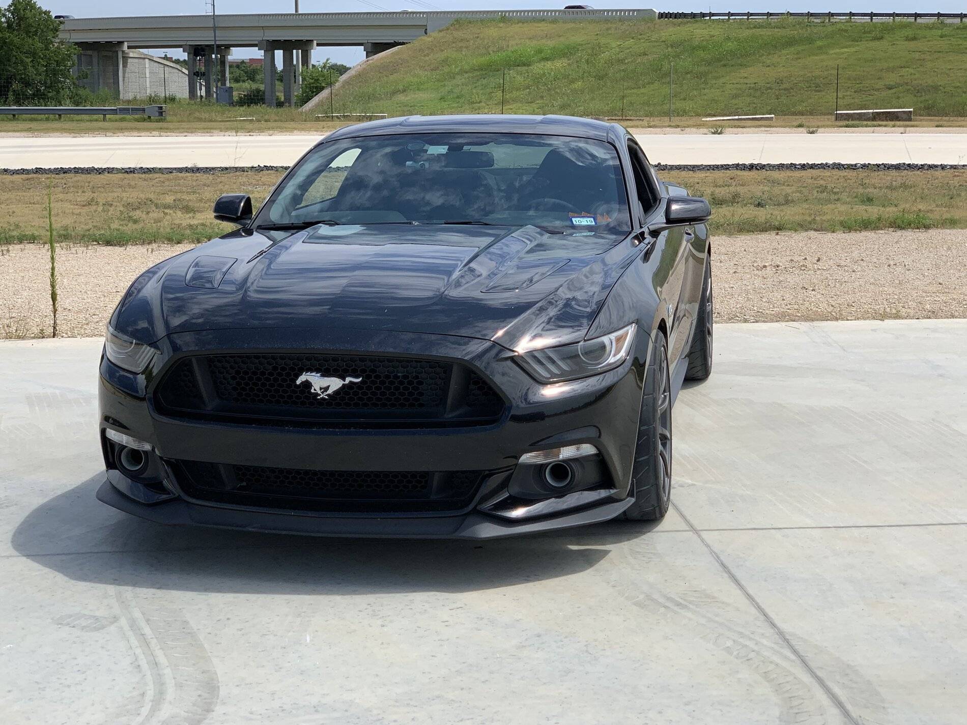

You can do it with +50mm offset in back and +25-30mm in front… or +50mm on all four if you use 20-25mm spacers and long wheel studs up front. I went square with -2.0* camber and love it. 305/30-19, no rubbing.

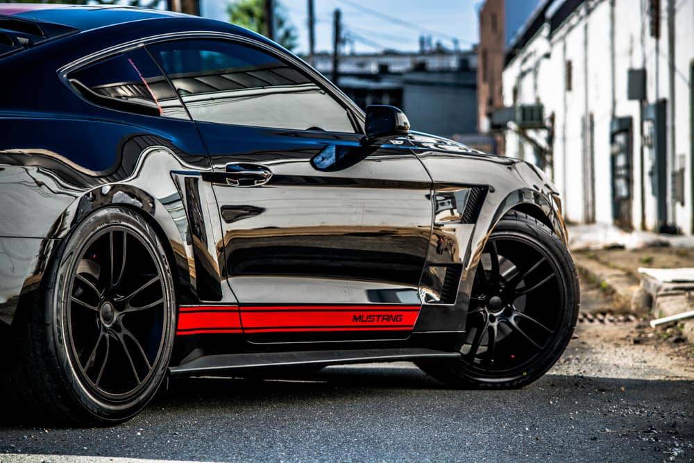

The only downside is the car can follow grooves on the highway a little easier when the tires get old. That, and the common 305/30 sized tires are a little shorter and wont fill the fender as well as a 295/35.
this one is a GT so the wider 350 front fenders do a little better job covering the tires.

These are GT-7’s from LMR in 19x11+50. They were discontinued a couple years ago, but I hope they come back sometime.
There is another place that makes similar wheels - replicas if the current Ford GT wheels - but they are much more expensive.

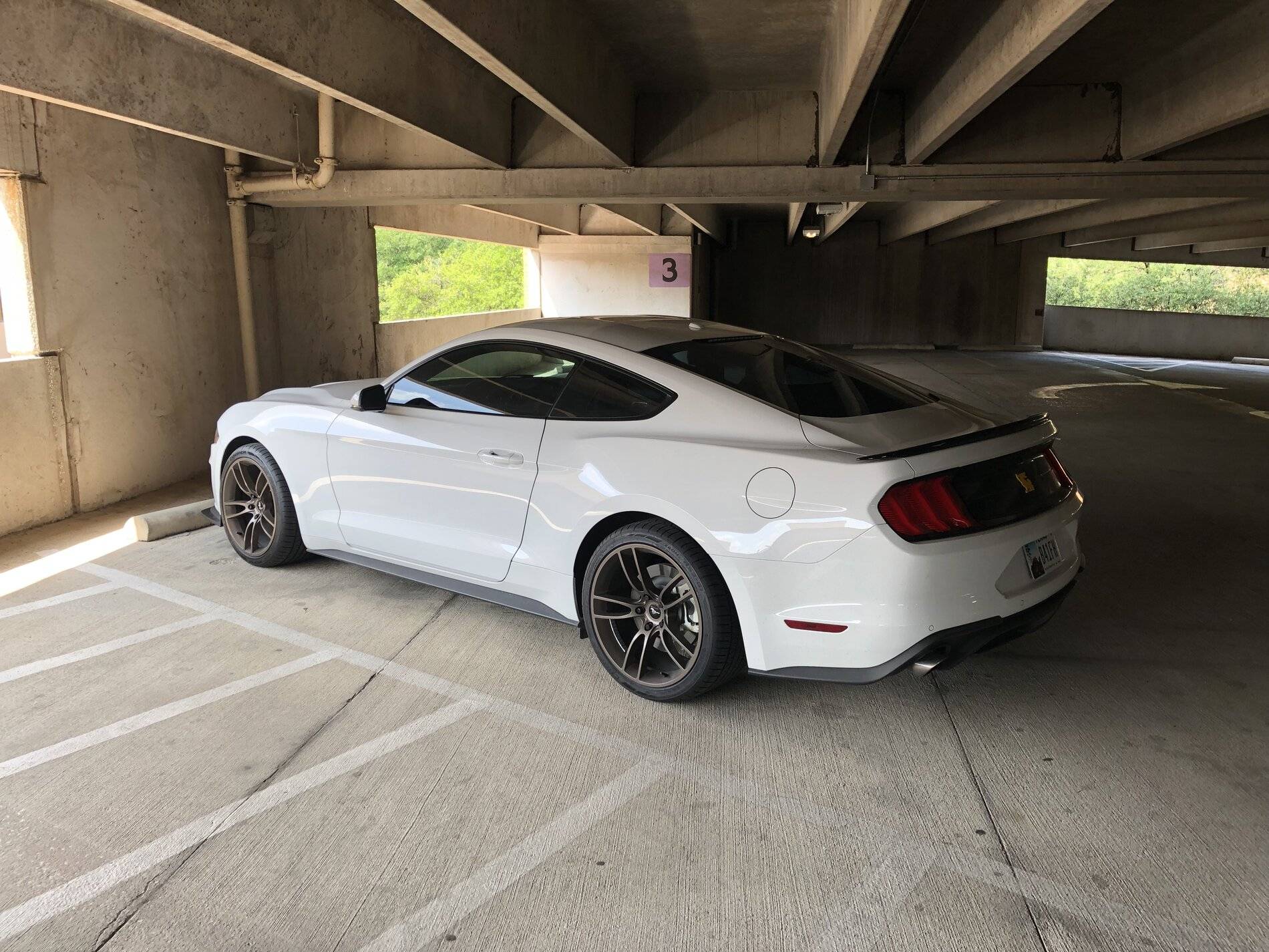

I have a nib set of the gt7 (well sve's white label version, which is the identical wheel from the same factory that makes MRR) in 19x10/11 set as well as 20x11. I need to post them again.
I have the 19x11et24 for the fronts on my car so no need for spacers. Can't rotate them obviously.
You can still get the wheels on ebay.
