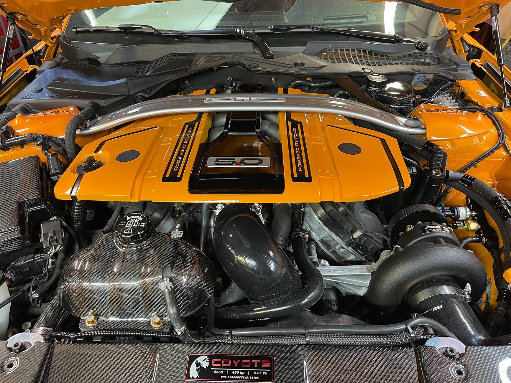

I went with ESS and am very happy with my choice. 18 GT Premium A10. My build configuration is as follows:
  • ESS Tuning G3 X-Trim, G3 IC
  • Fore Innovations Vacuum/Boost Manifold
  • Fore Innovations HOBBS Switch – Inactive Pending Fore Innovations Return Fuel System Install
  • HP Tuners Remote Tuning Device – Wengerd Performance (RTD3)
  • Injector Dynamics ID1050X Fuel Injectors
  • NGK Spark Plugs
  • Reische 170 Degree Thermostat
  • TiAL Q-Series Blow Off Valve
  • UPR Products Dual Valve Catch Can System for Centrifugal SC
  • UPR Products Two Port Quick Connect EFI Fuel Line Adapter
  • AEM X-Series Digital Fuel Pressure Gauge
  • AEM X-Series Digital Vacuum/Boost Gauge
  • Auto Meter 2 Gauge A-Pillar Pod
  • Vortech Engineering MaxFlow Fuel Pump Booster
Good luck with your install!
