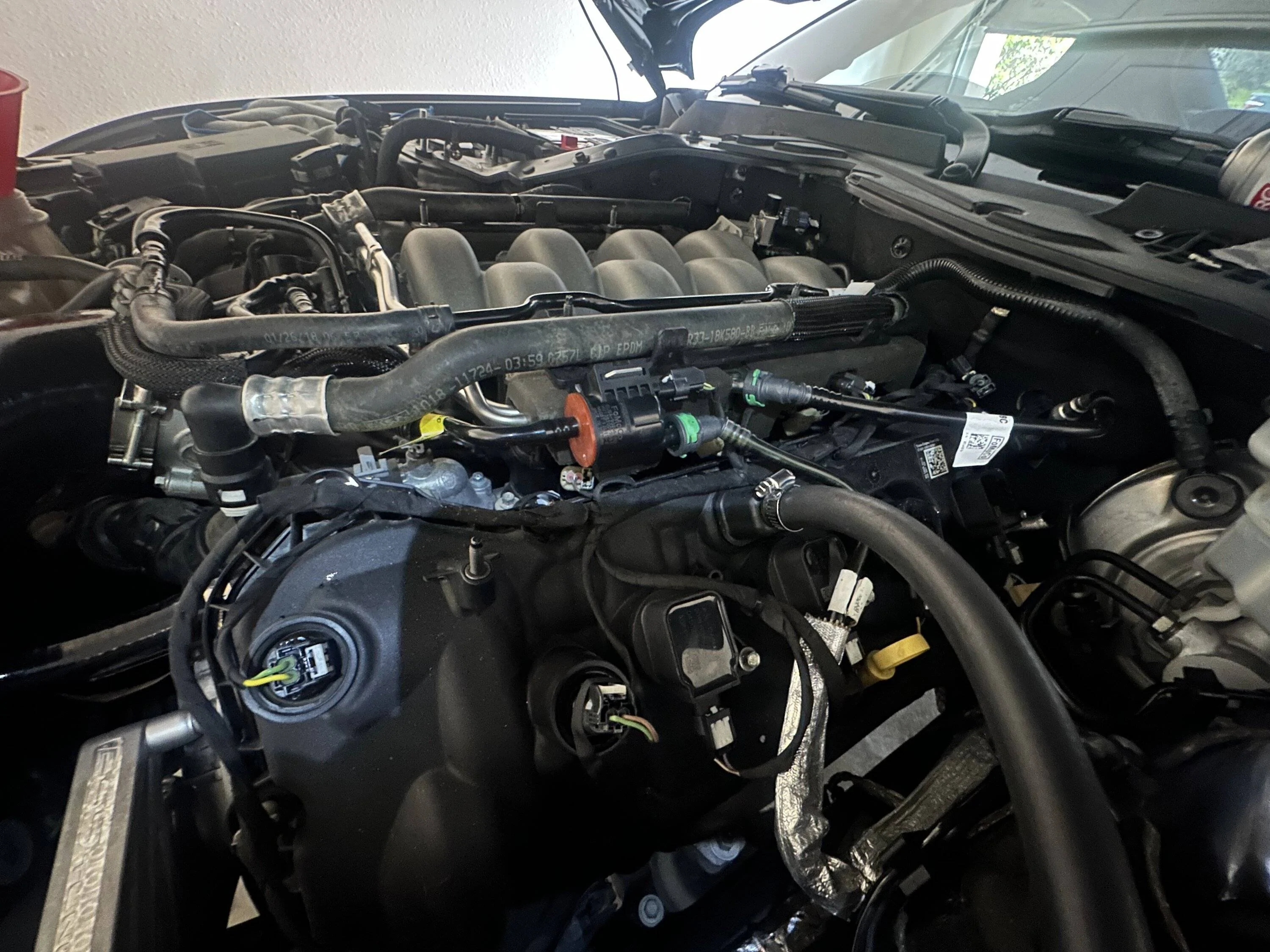

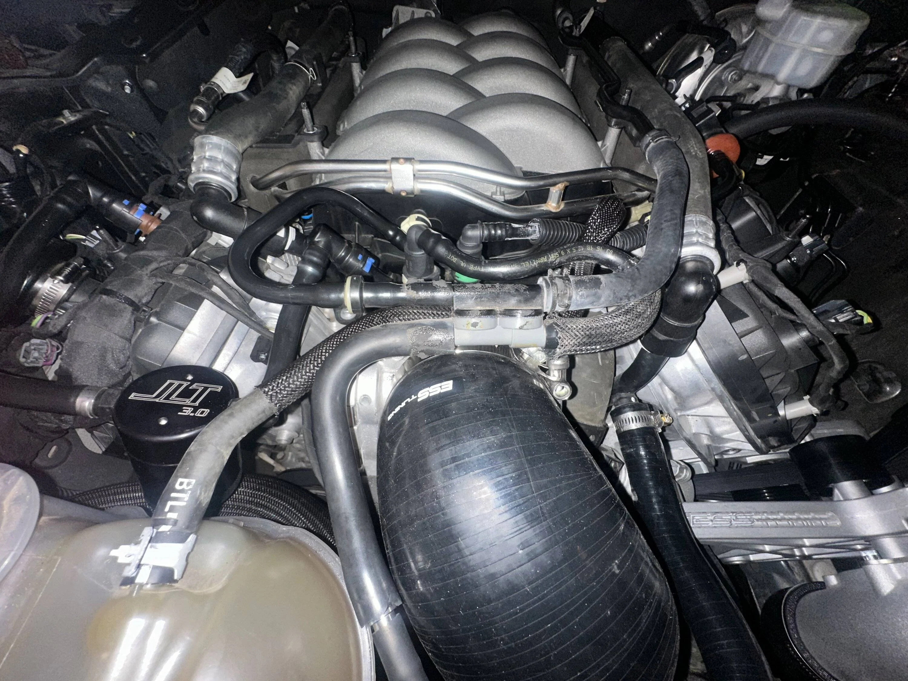

Backstory:
the Base Tune was uploaded Saturday morning after the install of all supercharger parts, injectors and other electronic devices. Car would not hold idle after several attempts and died after a few seconds.
I loaded the restore stock tune, then reloaded the new base file they sent me. Still has the same issue. A short data Log had been sent thru TDN to Lund For Review. They claimed that I may have a vacuum leak or the engine is choking. I don’t see how. This car had an NA Lund Tune on it prior to install and ran perfect….
What I checked:
Boost line to Bypass valve is good and opens in vacuum, all imrc lockouts were installed, no fuel or vacuum leaks. IMRCs installed correctly. All connectors to injectors and spark boots were on snug. Belt has no slippage and is routed correctly. I did notice alot of fuel coming out the exhaust tips and pooling on the ground. I didn’t want to continue in fear of washing out my cylinders with fuel.
What I can replace just in case:
I got a new battery on standby if that is the issue. Voltage level is fine.
Thanks for anyone’s help….

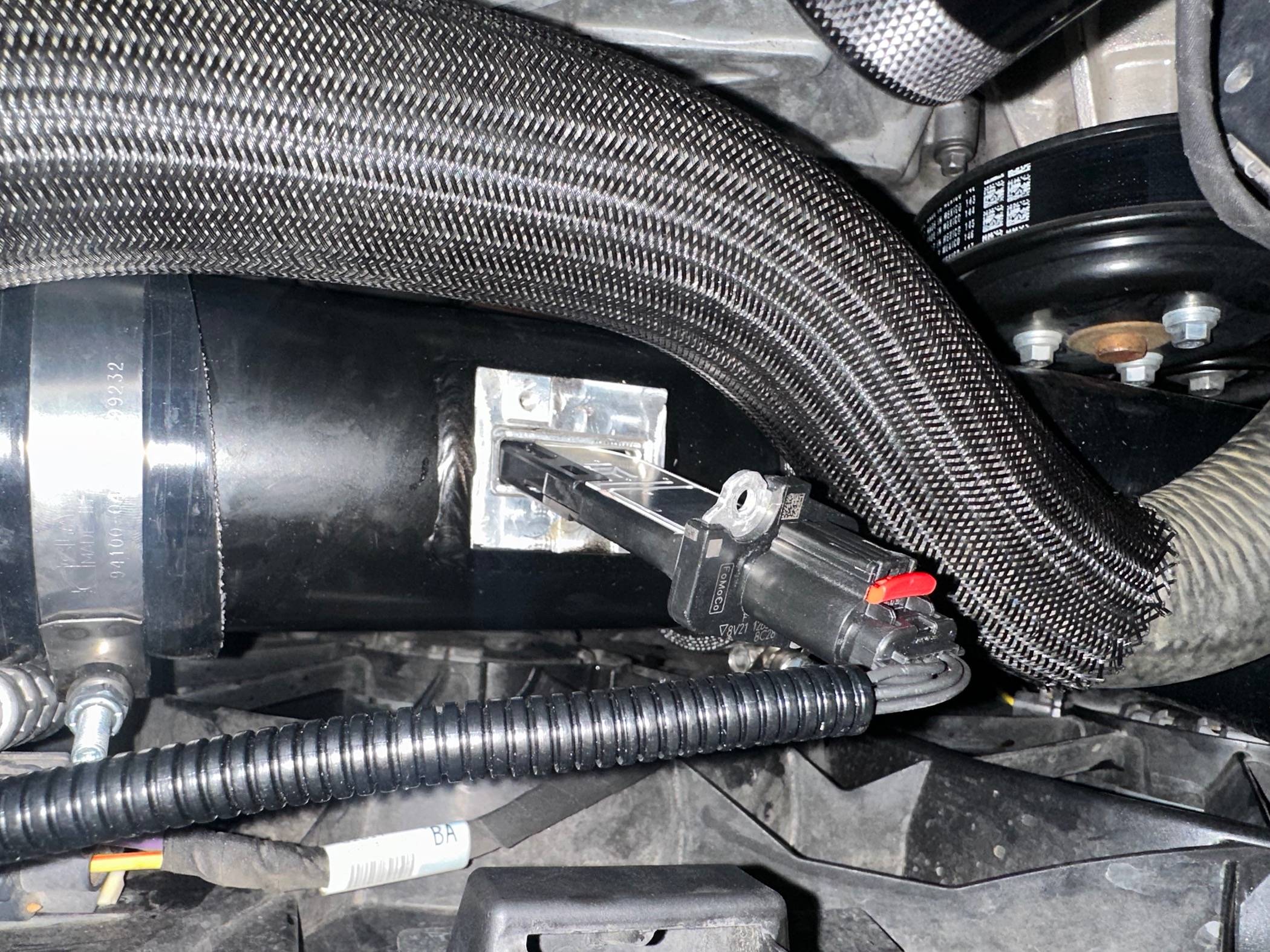

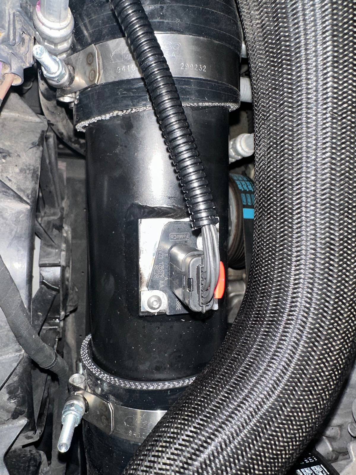

I had those same symptoms when I blew a coupler off. I know you said you checked it all, but make sure that the silicon couplers are all fully attached and the band clamps are tight. Mine was on the intercooler to MAF pipe and it was hard to find it initially.

Thanks for your advice. Everything is good there and all the other clamps are on tight.

Do any of the silicone couplers have holes or damage to them? They do need to get squeezed around some sharp sheet metal; one of them could be damaged, and that wouldn't be apparent.
You could also try pressurizing the system to see if you can hear any leaks.
