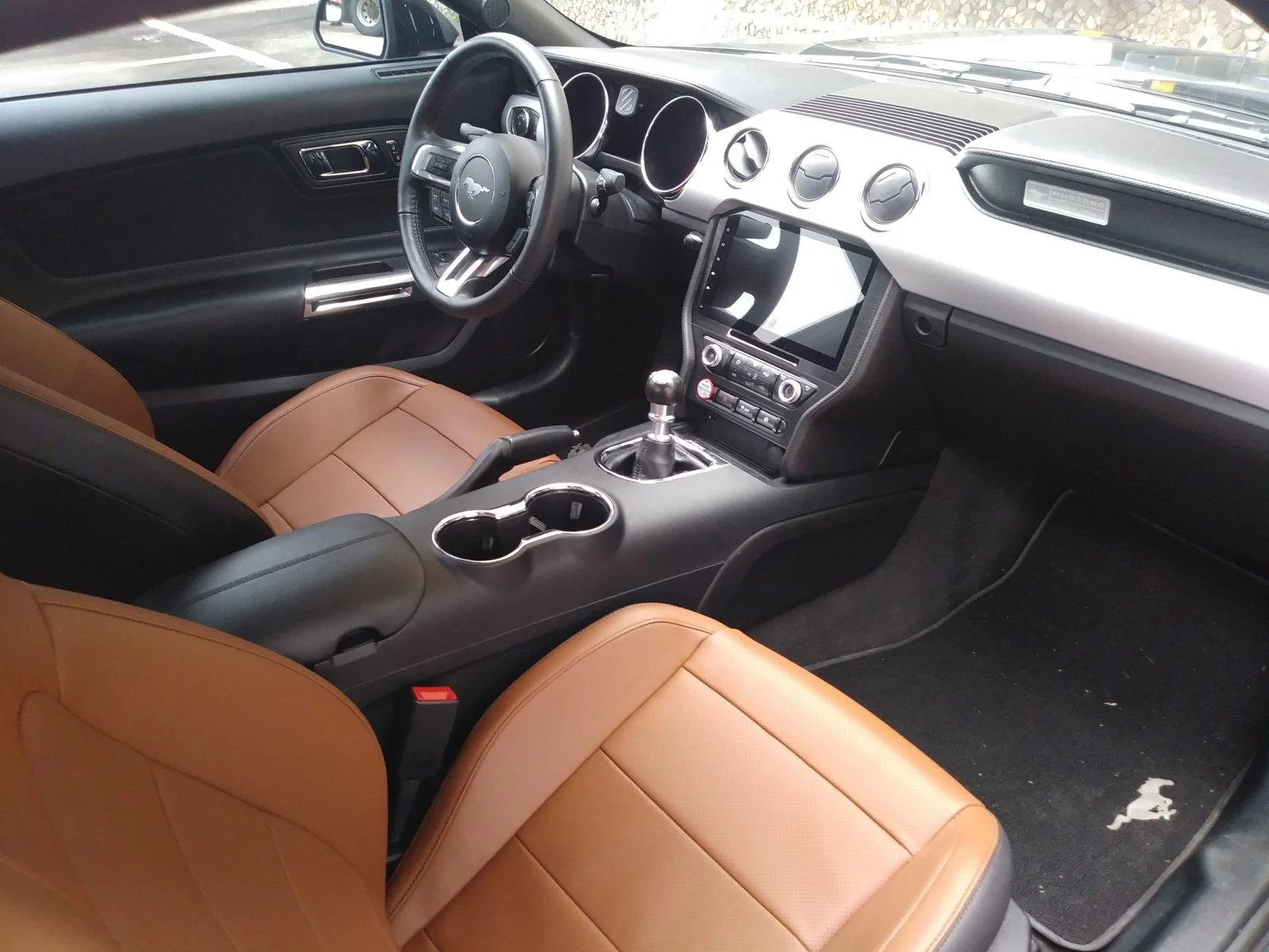

So I got my unit last night and got it installed.
The install was intimidating when you look at all of the harnesses but it was surprisingly simple. I would imagine if you are installing with aftermarket amps, cameras etc. it would be a little more involved, but just hooking it up to my base system was literally connecting the factory harness to the head unit harness and can-bus translator. You also need to run your mic wire and gps antenna but that took me 5 minutes. There is also an extra harness that has a ground wire, power wire and acc wire which was extremely confusing but it turns out it was not needed at all.
I have two gripes currently:
1. I cannot figure out how to get the voice button on the steering wheel to work. When I press it it changes the various modes on the tablet. There is an app on the tablet that looks like it is to program the steering wheel buttons but it doesn't seem to do anything. Hopefully someone figures this one out.
2. Not a major one but it does not auto dim.
If it wasn't for the voice button not working as it should, this unit would be flawless. It completely changed the look of my interior to something more modern. All in all I am very happy and in my opinion it is worth way more than what I paid for it if it holds up to the test of time.
