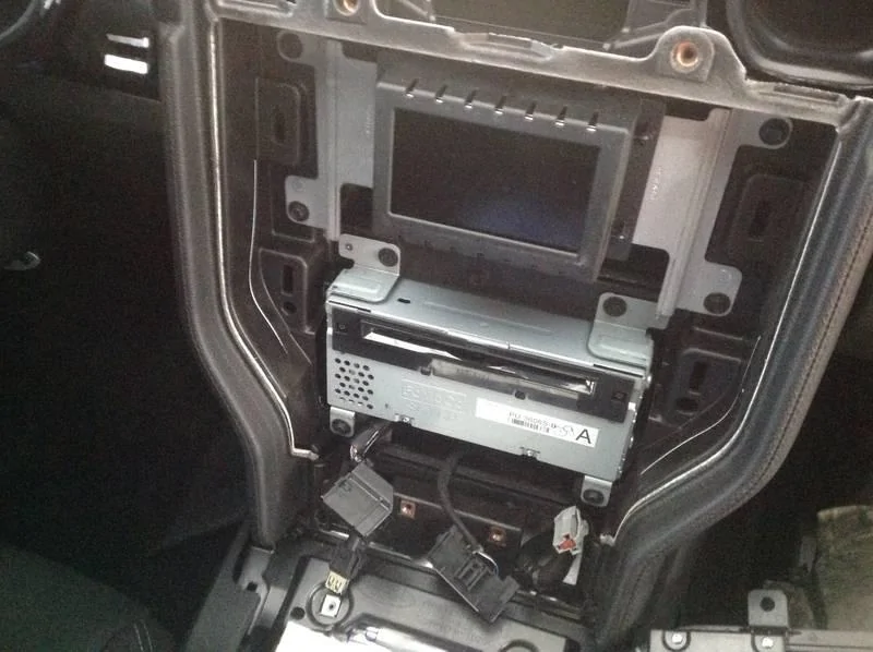

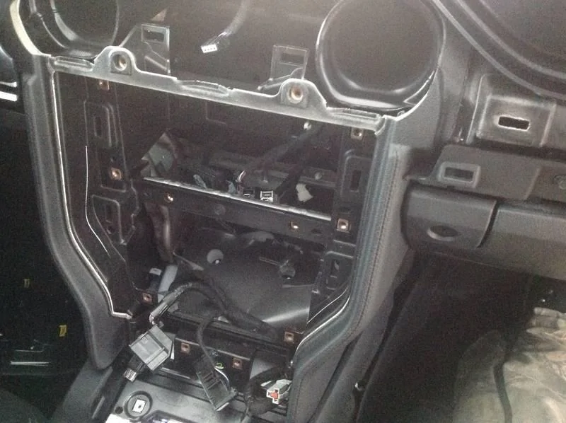

    So far I've taken the base stereo and screen out, and I wont go over that in depth because there're many how to videos on that already. I will go over the install of the unit, showing how to modify the base units control board to work with the new radio display, and how to plug it in and install the OE board to it. It comes with specific harness and plugs made to connect to our cars so it should be plug and play as far as that goes. The hardest part will be modifying the control board that houses the control for the HVAC and the radio. This unit replaces the radio controls however retains the stock HVAC control as well as the lower buttons for drive modes. The radio volume and tuner knob must be removed from the board to make it fit to the new unit. Yes this Android system controls the radio from the touch screen, steering wheel control and SYNC voice commands remain in tact and will work.

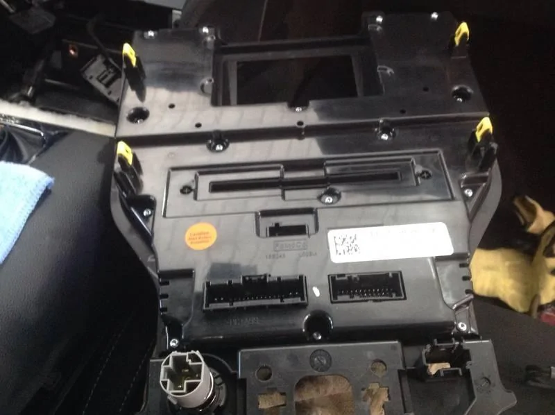

    After the base front control panel is removed and radio and CD player is removed you need to take apart the front control panel by unscrewing the back plastic cover to expose the circuit board and button controls.

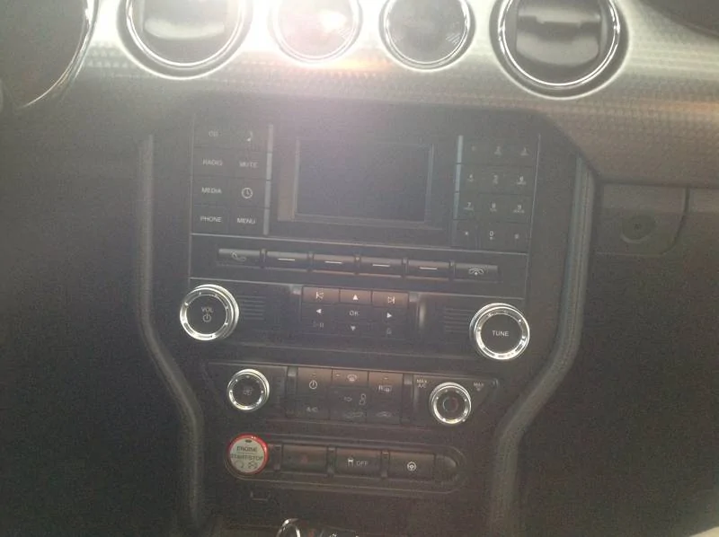

    Here is the base radio before removal, and by the way Seicane asks for you to send them a picture of your head unit so they can very fitment.
    Front panel removed.
    All the base stereo CD player removed.

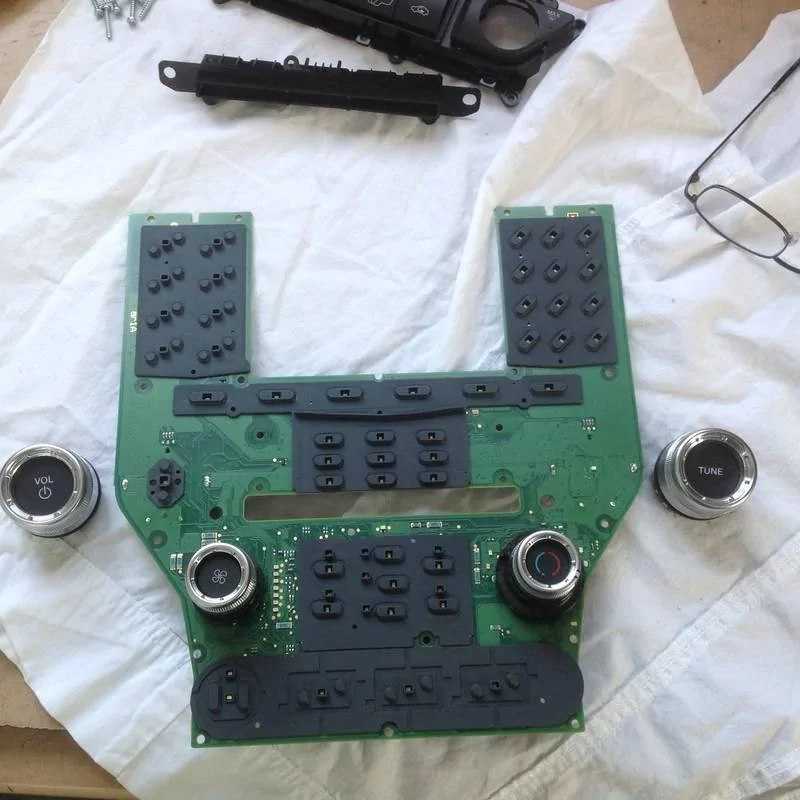

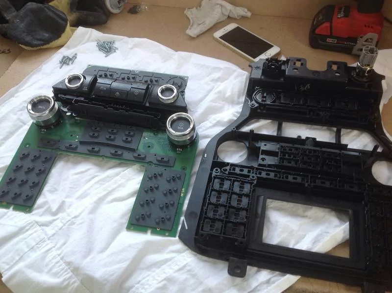

    Front control panel, need to remove all the torque screws from this back cover to expose the circuit board.
    The control board just lifts out of the case with circuit board and control buttons.

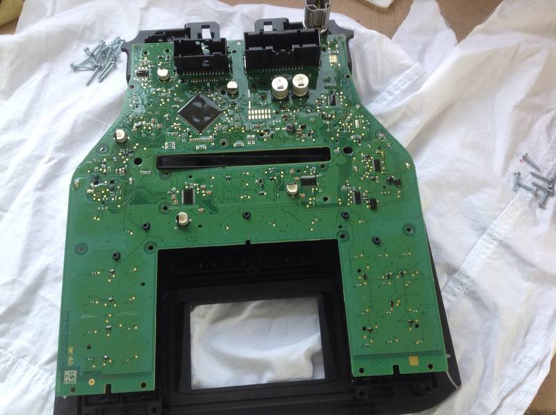

    Here is the other side of the control board with with the plug input that the new unit will plug into.

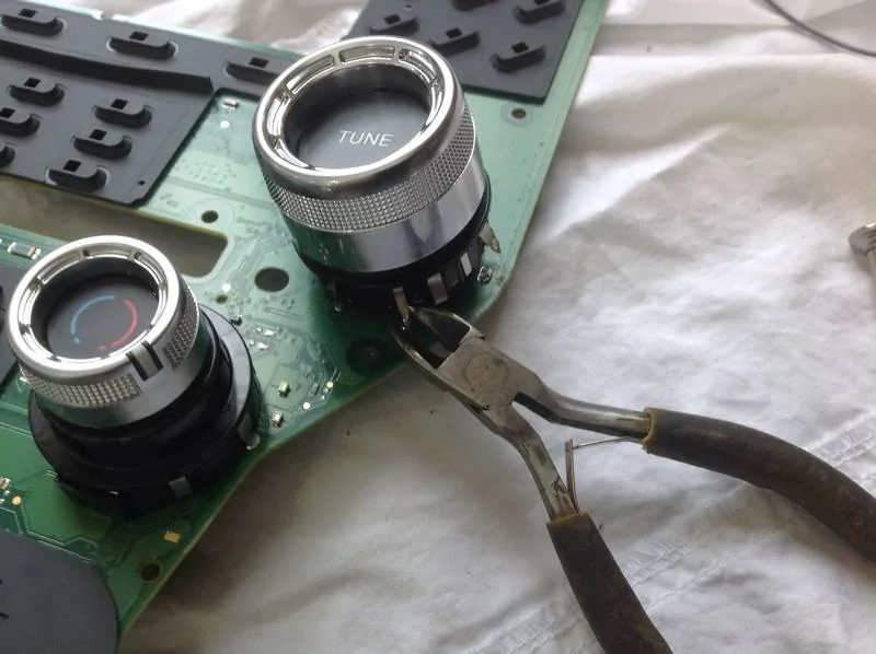

    Now comes the removal of the volume and tuner knobs from the board. Seicane says to desolder them however I could get the solder to come loose so I clipped the contacts.
    Here is the board with the knobs now removed, this will allow the board to fit in with the new unit. Since the upper part of the board fits hehind the 10.2" display this know need to come off. Again the radio will now be controlled from the new display touchscreen
