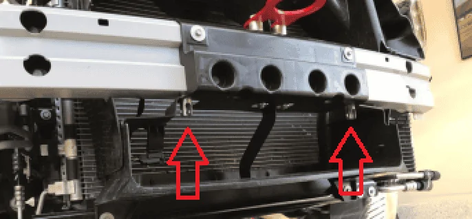

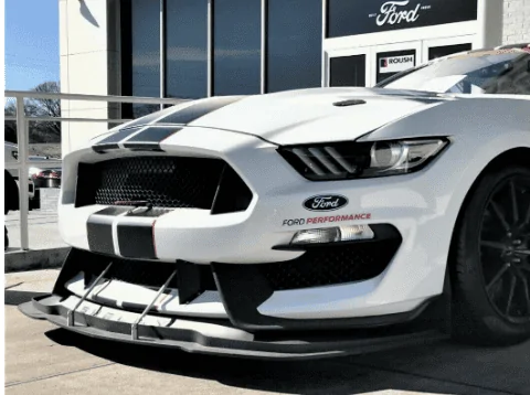

If you are looking into chassis mounting one, below should give you some idea.

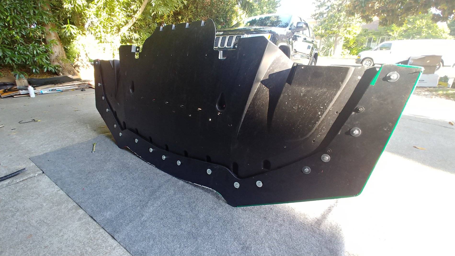

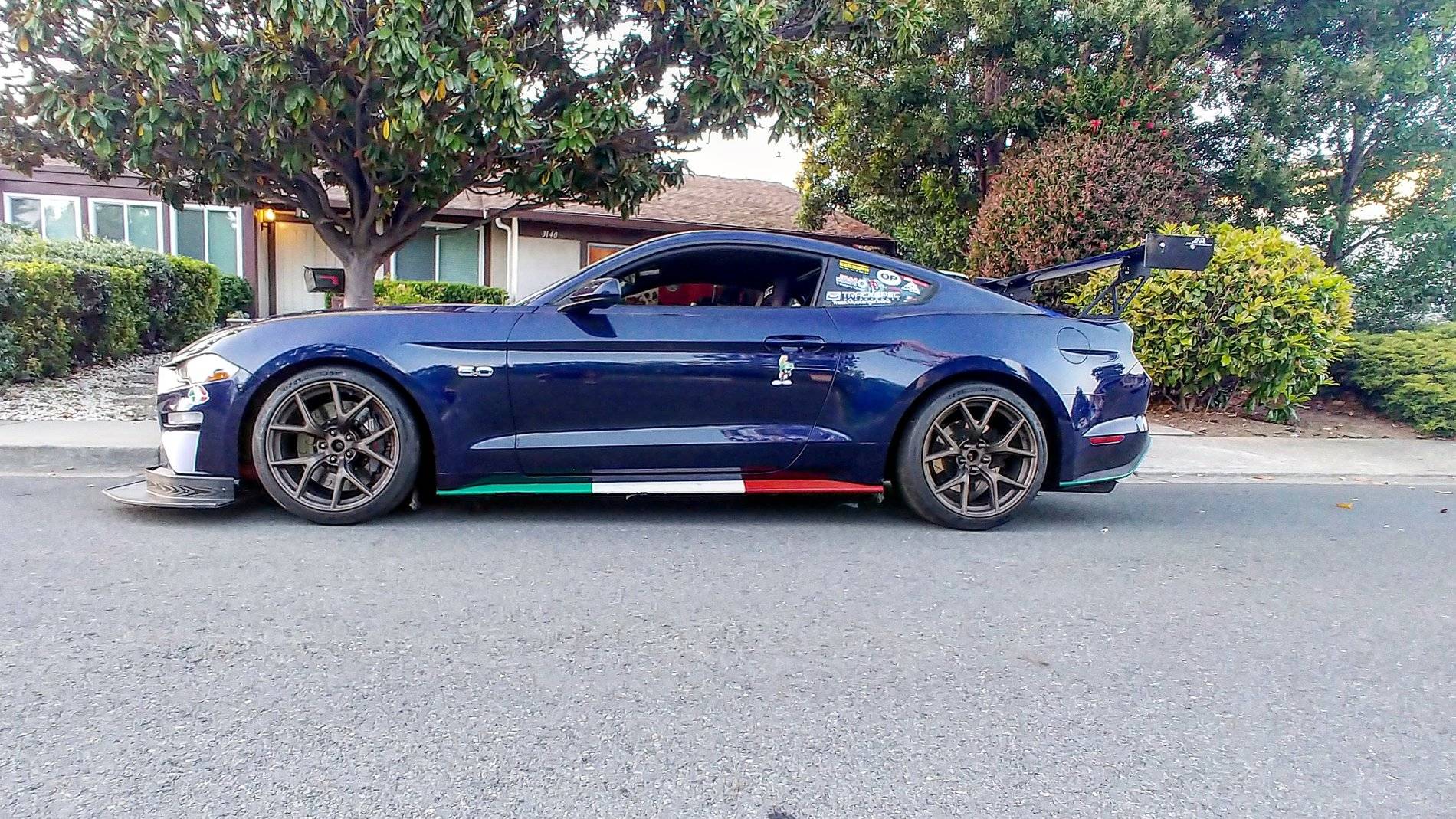

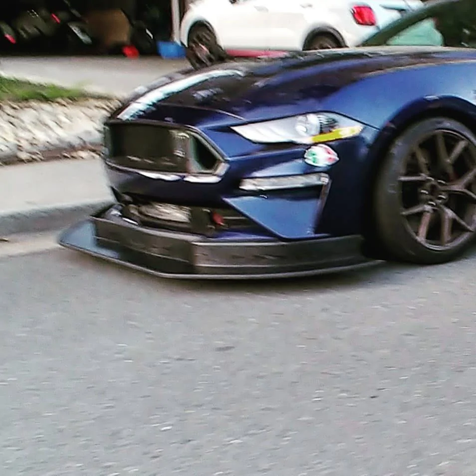

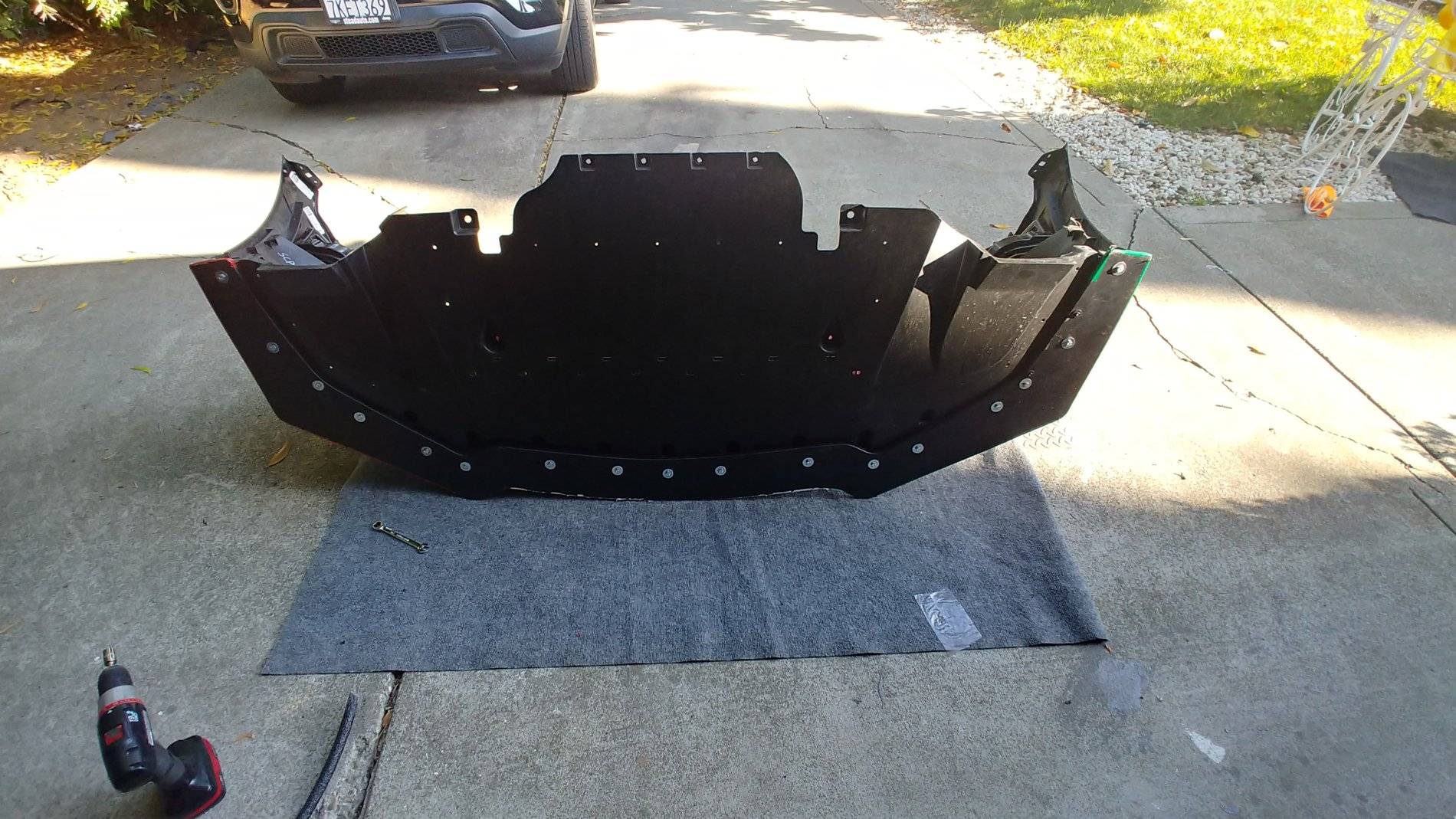

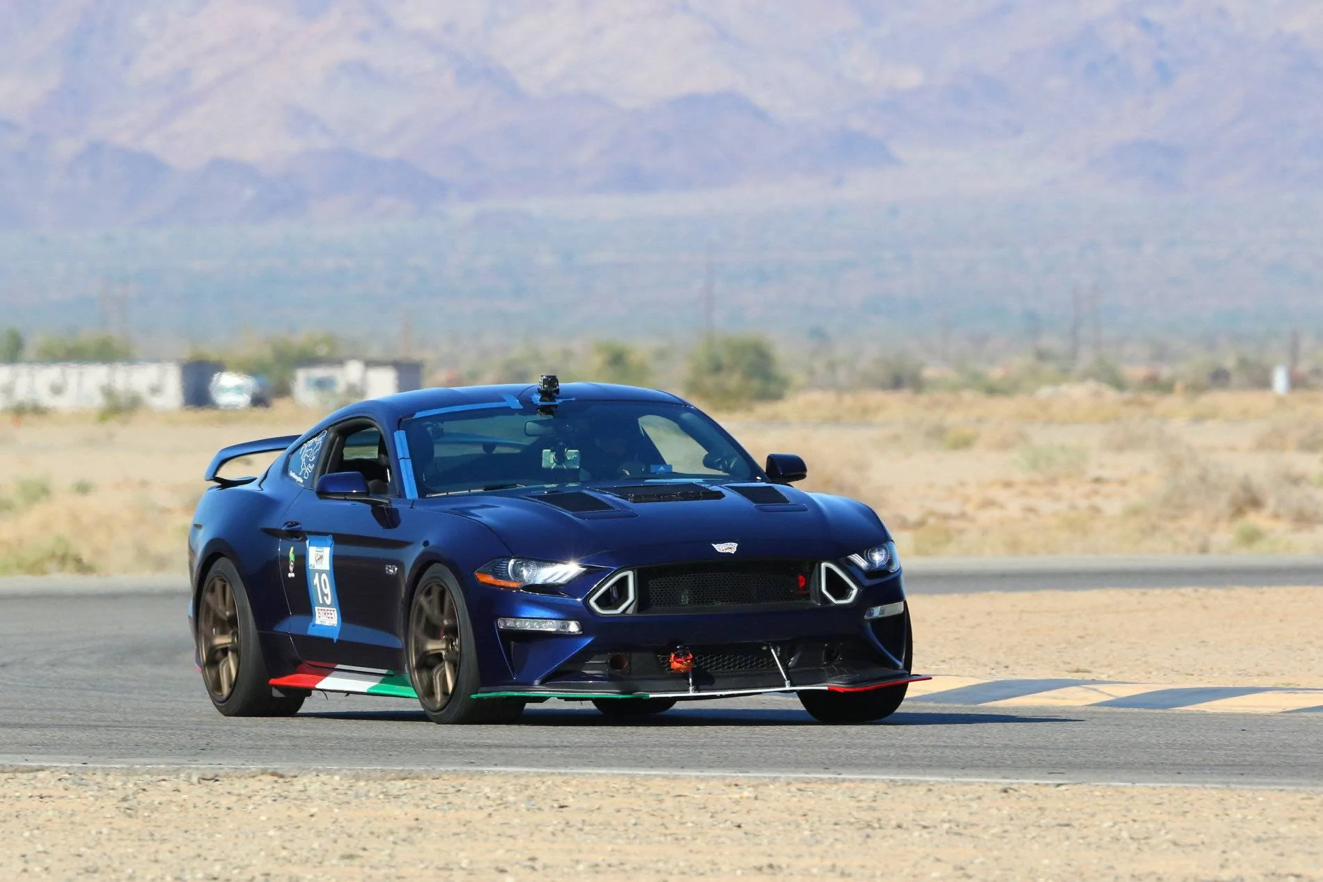

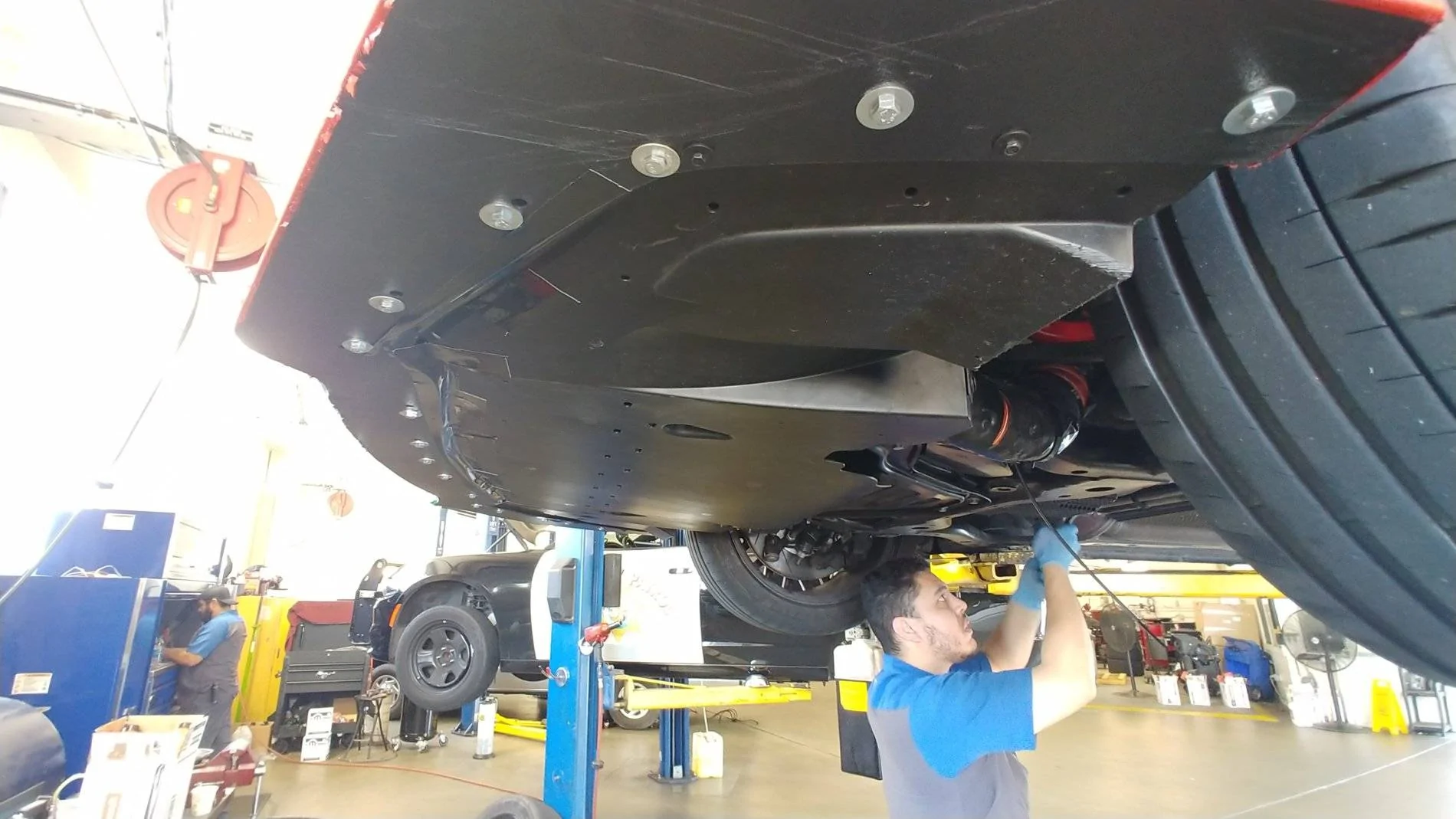

Sorry guys for the late reply sometimes I don't get notifications. I personally believe that a ZL1 addons is a great splitter lip, but I did reinforce it with bolts. I ran almost a year without rods, and I did have some light deformation on the side due to the down Force generated. Nothing to big to fix
I substituted the lognuts and rivets with a of some Bolts to o reinforce the oem splitter / lip connection. It worked great.
now as you can see from the pics I added some chassis mounted roads that will allow me a better angle of attack it also a better stability at high speed. Feel free to contact me for more information.

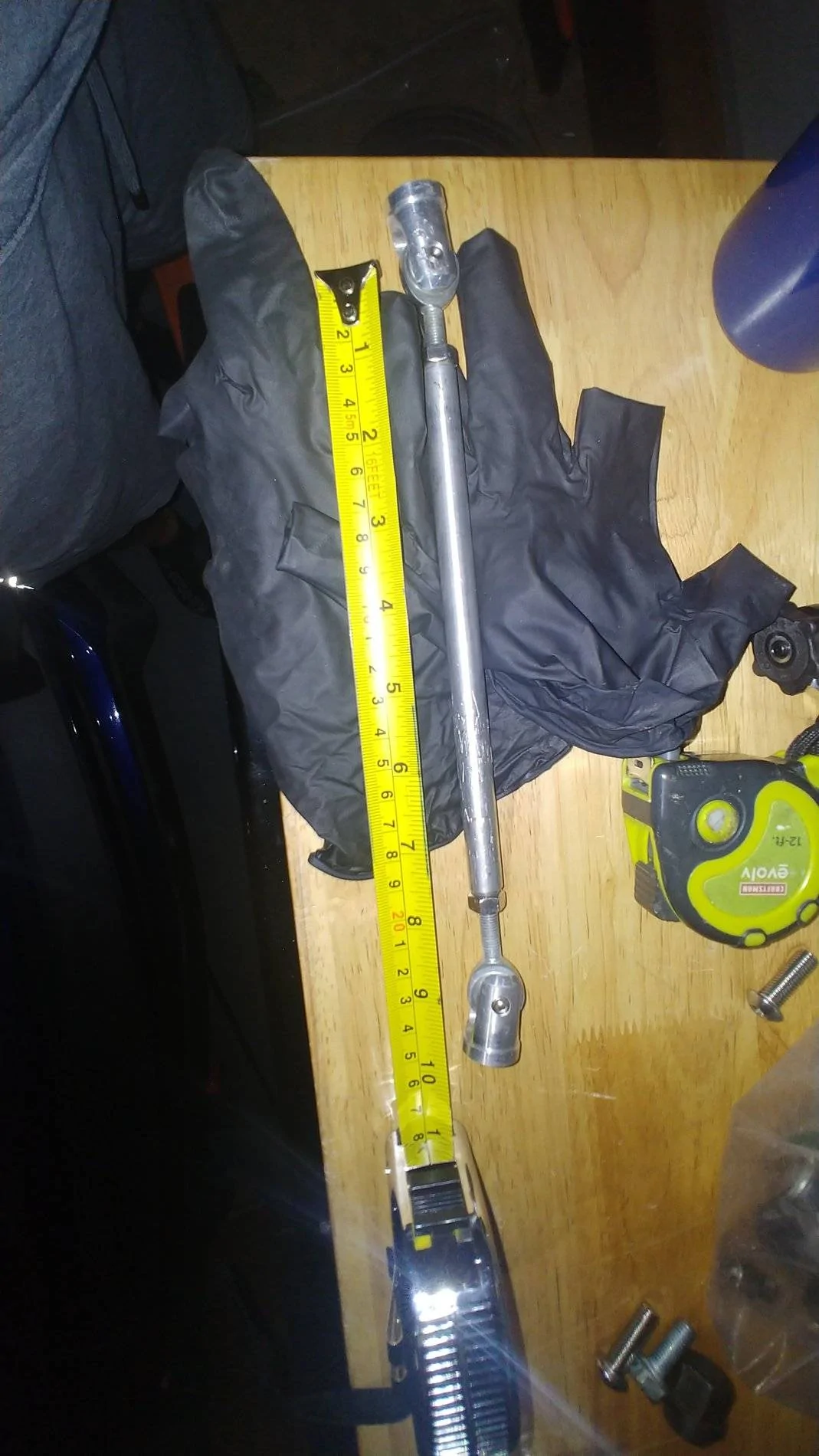

Brother/fratello,
Those rods you installed how long are they? I installed that 777 G.T. 500 replica bumper on my 18, looks good but is F...... weak... I can’t stand it

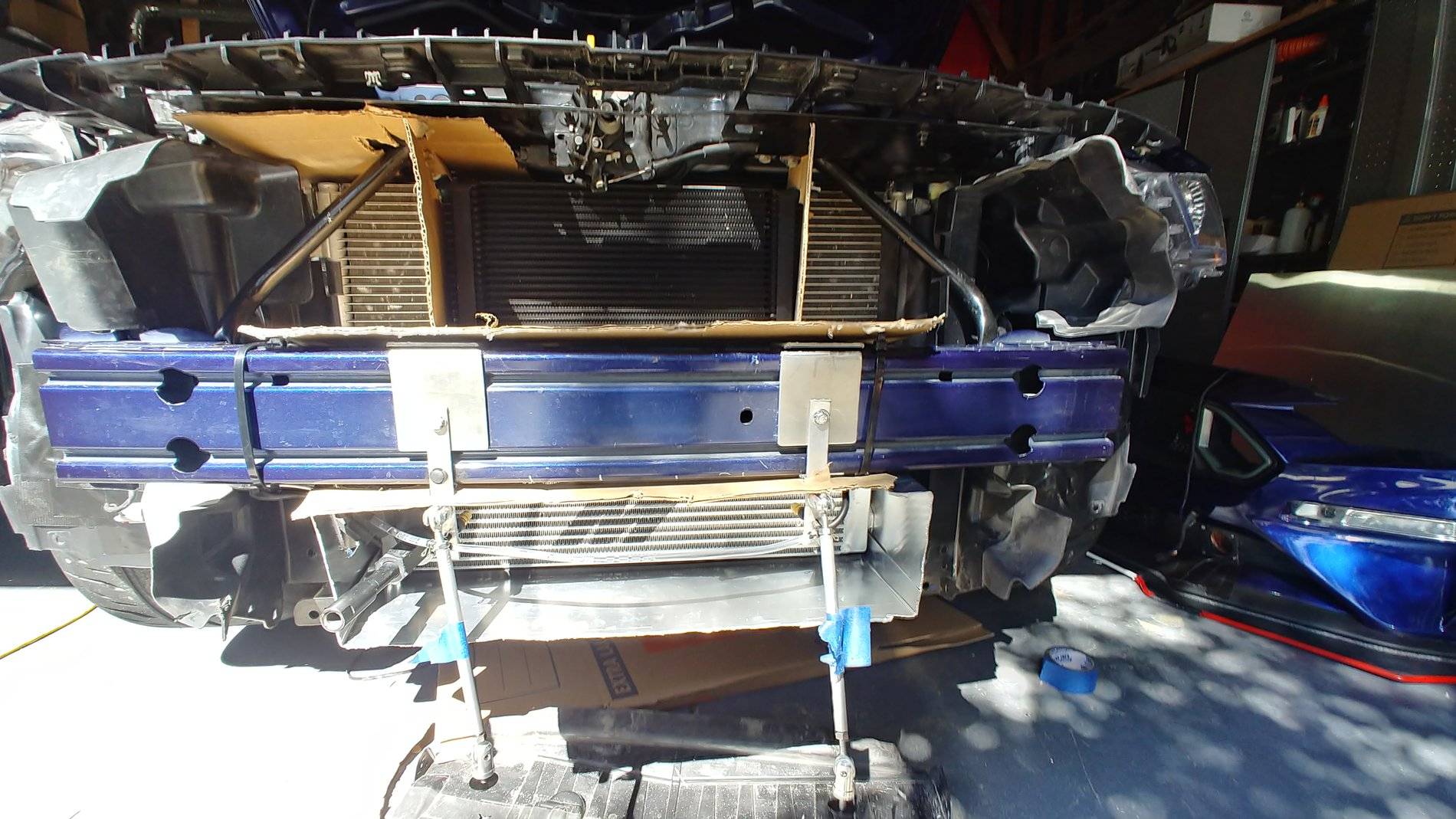

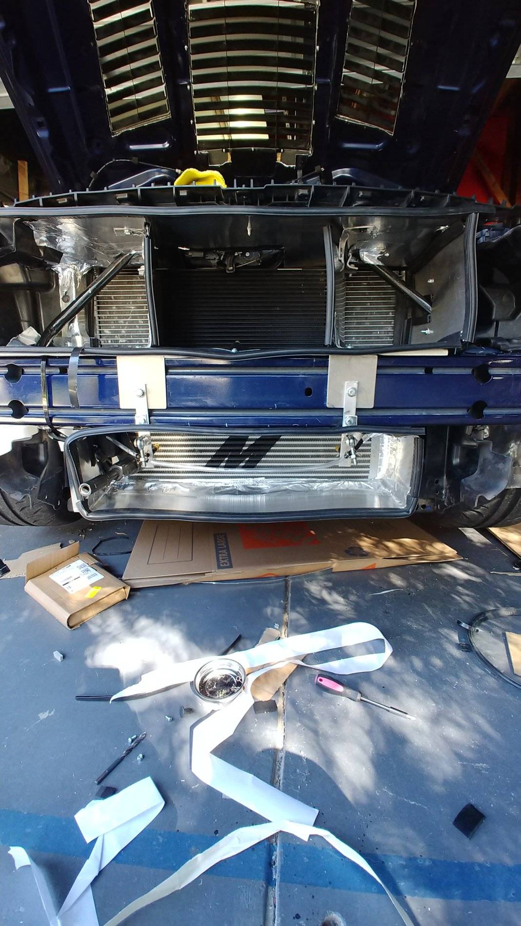

Remember..you need to attached those to the chassis. The plastic bumper thing is useless.
I use the holes in the crash bar and did extra 2 holes just under. Put 2 nut rivets andattached a alluminium bar. See the pic.

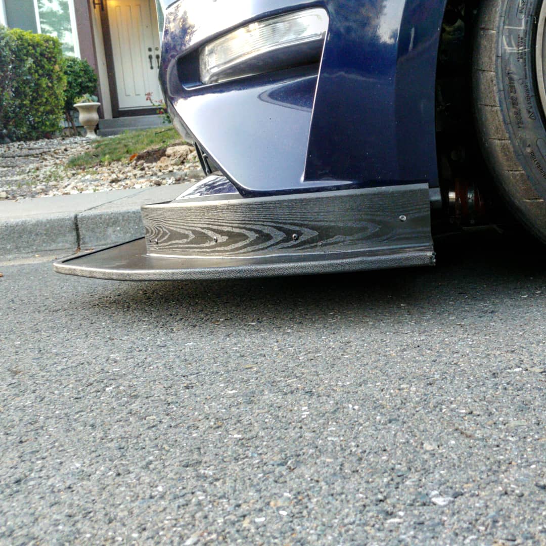

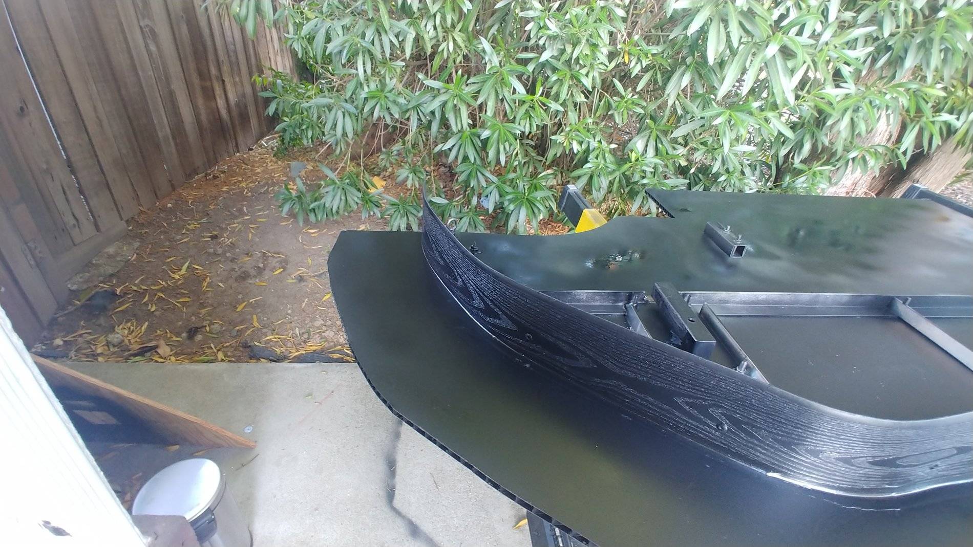

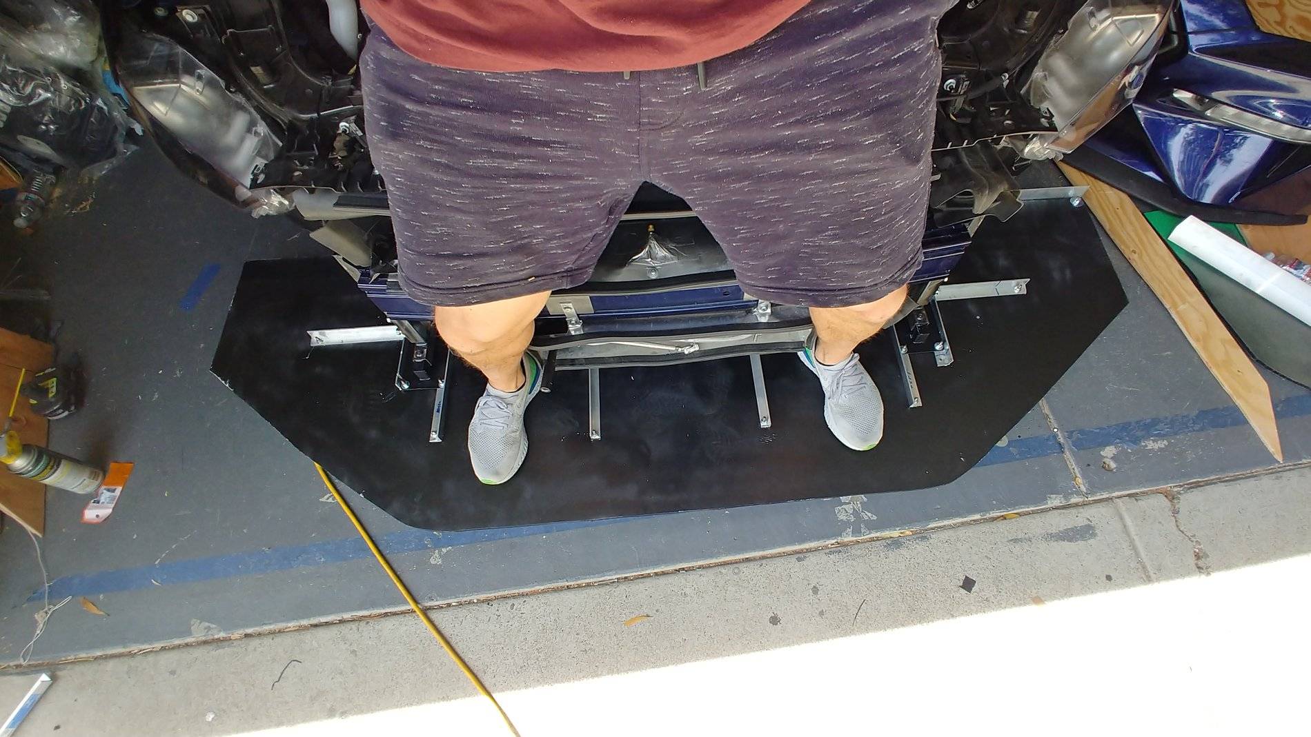

I went radical by the way.. :)
Home made. Fast install ( 1min) and release
Perfect for the track.
Awful for daily ( that is why i can disassemble in 1min lol ) :)

What is that made out of? Looks like some waffle material?
Also you should check out the quick video that AJ Hartman made about the trailing edge of the splitter and how it should be shaped. Adding that weather stripping/trim is having adverse effects on its effectiveness.
