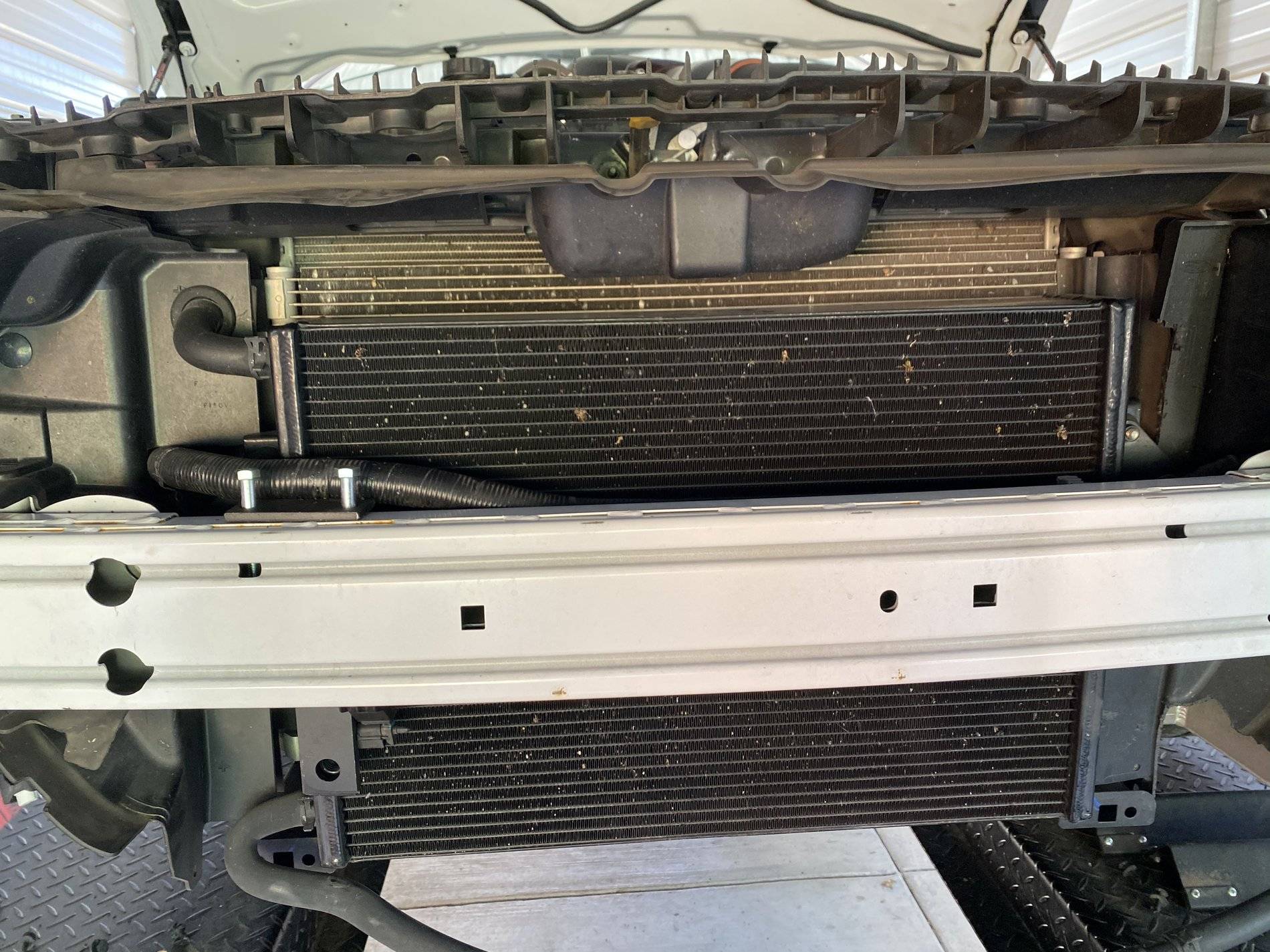

Anyone installed the passenger side one on a PP GT with H/E?

Heat Exchanger

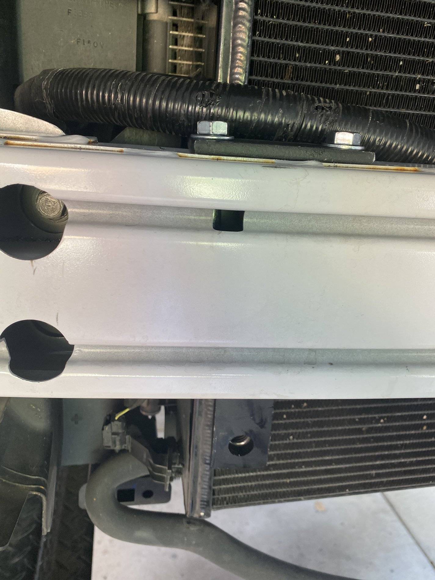

You'll need like 1/2-3/4" between the back of your bumper support and the H/E in order to squeeze the tow hook there, depending on if the tow hook mount plate and the H/E overlap.

If I have time, I look at it tomorrow. I have my doubts if it's going to work.

The Whipple H/E has spacers. I have the VMP triple pass H/E so it's right up against the crash bar. The crash bar is bowed out so there is space between the H/E and crash bar in the center. I have ordered the ZL1 receiver to mount in the center.
