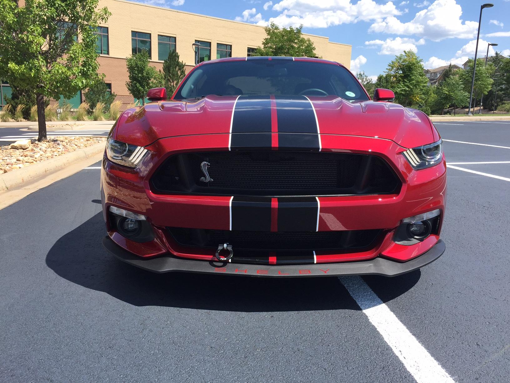

Got tow hook installed last weekend. not too difficult once you get the belly pan off and see what you're working with. Would be nice if ZL1 Addons would include the nuts and not make you have to go to the hardware store.
