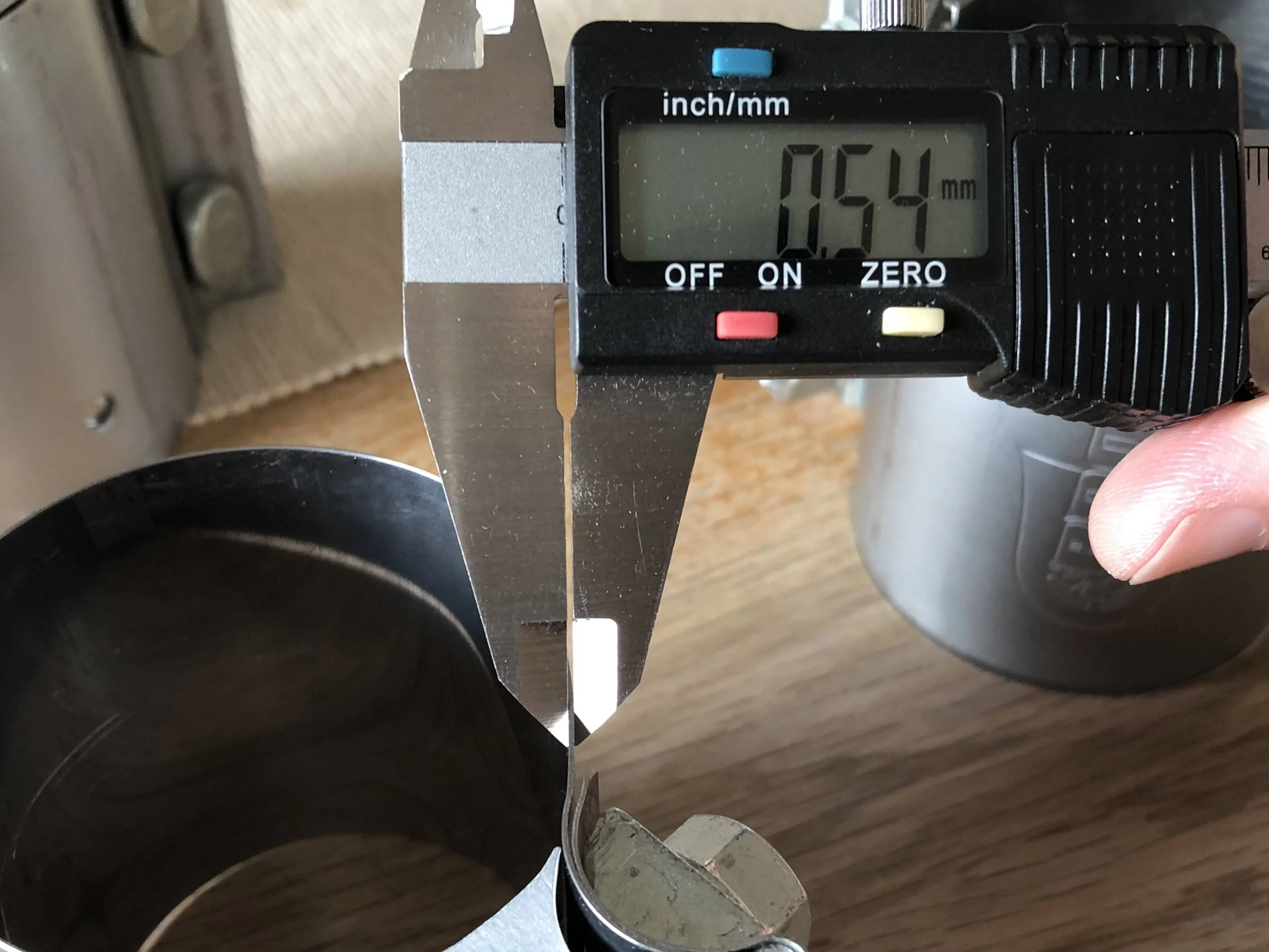

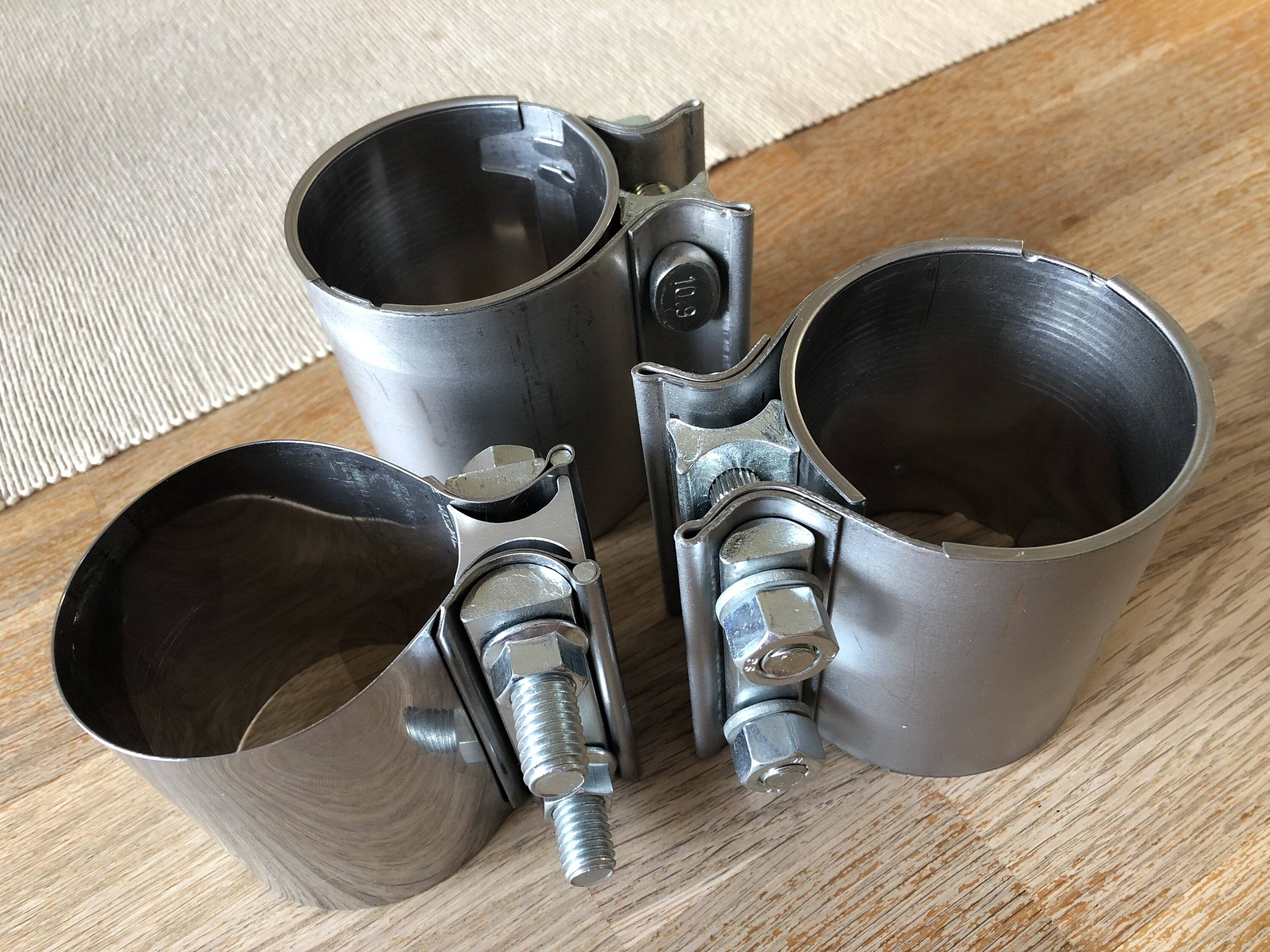

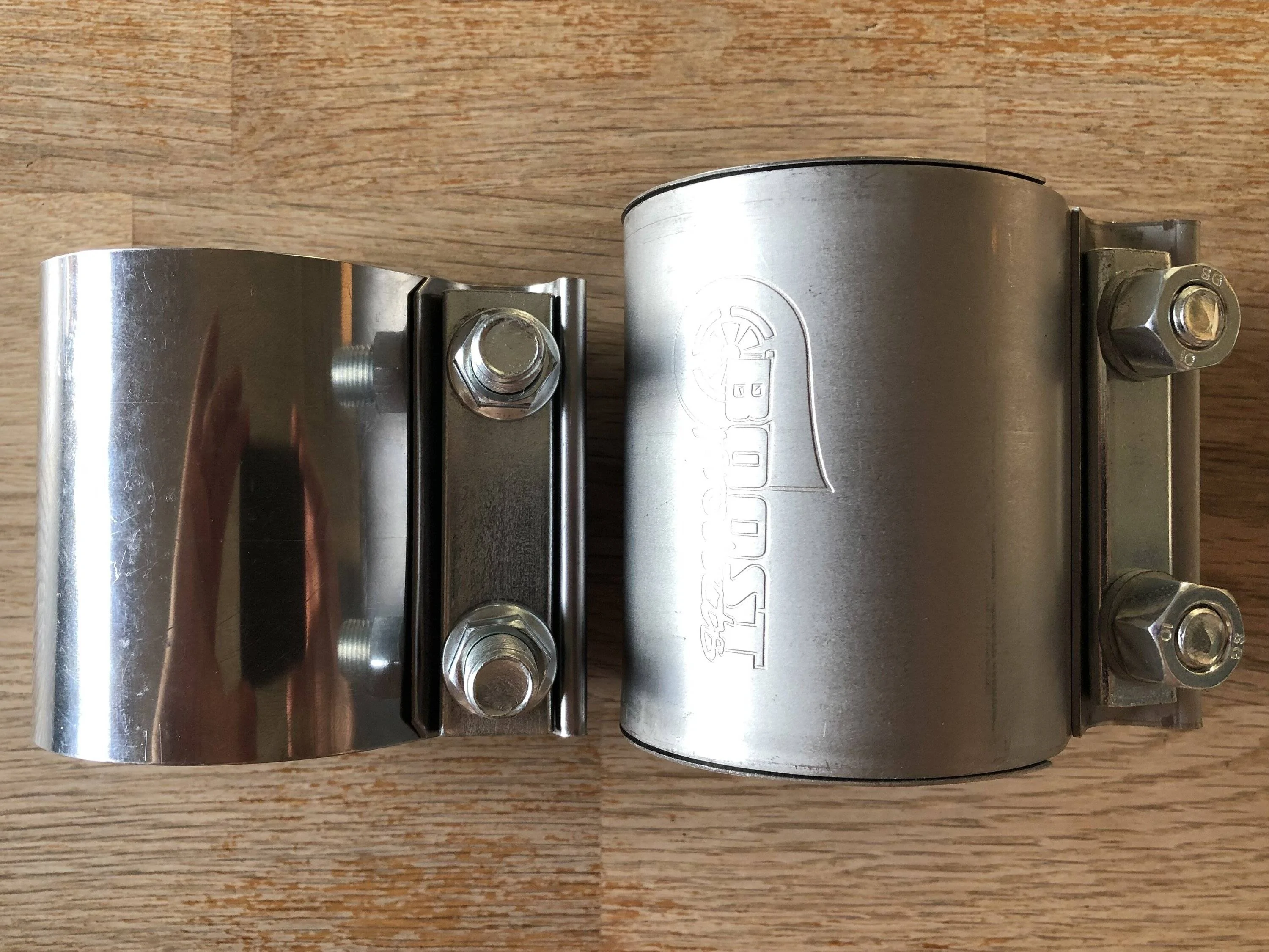

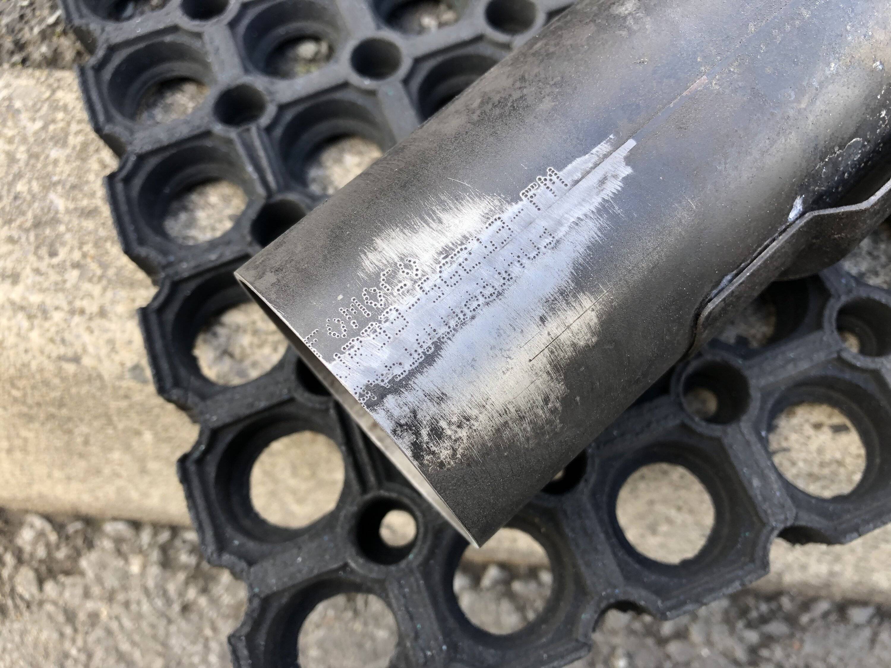

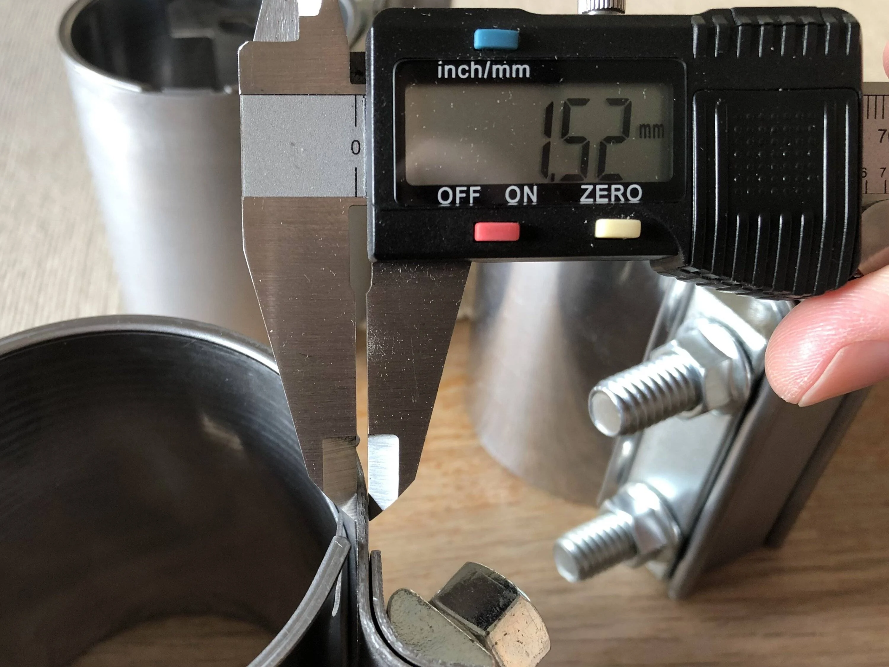

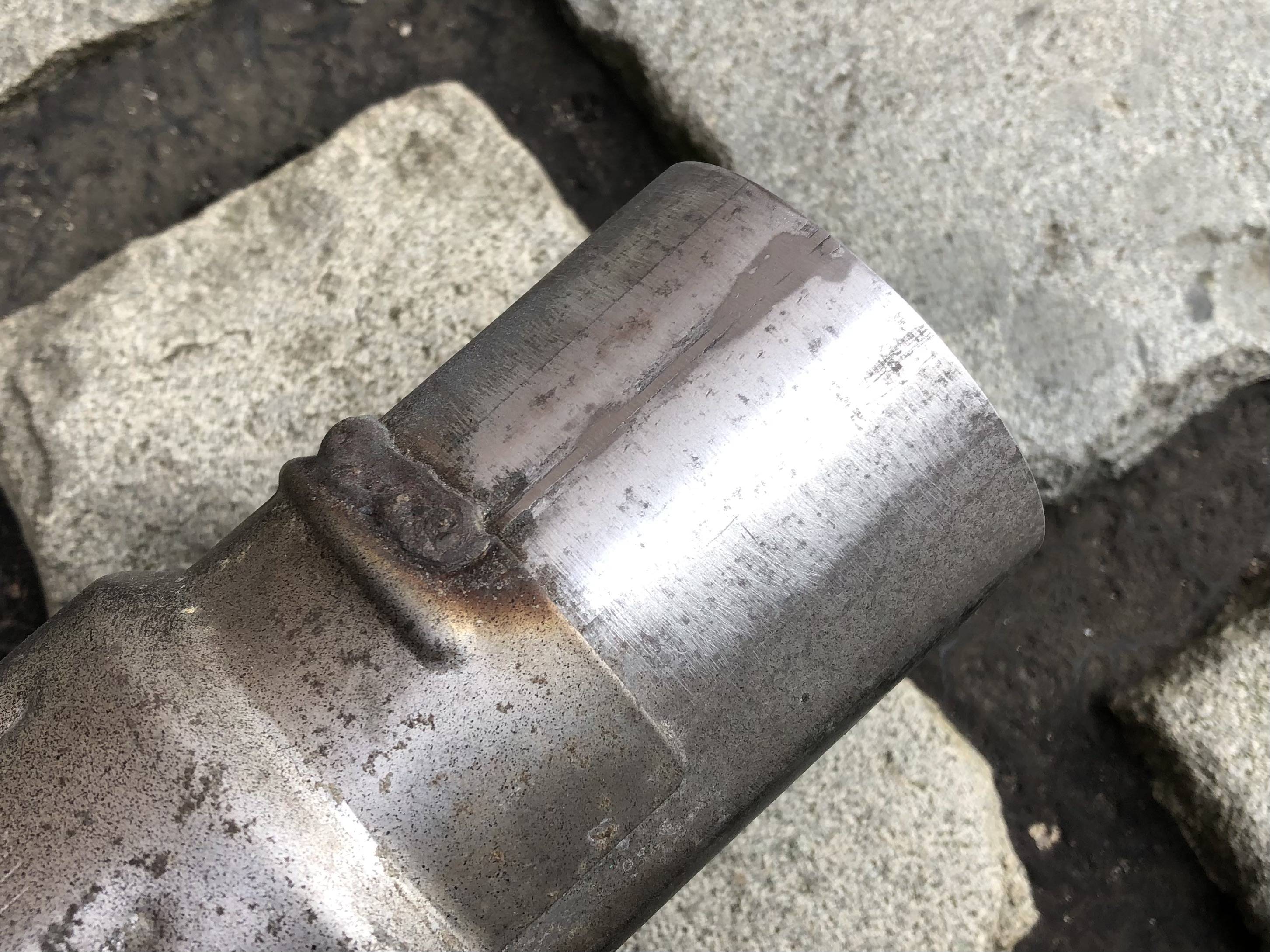

Remember to check your pipes for irregularities or rough weld seams that could affect clamp effectiveness and / or sealing :
Use good clamps - comparison photos :
