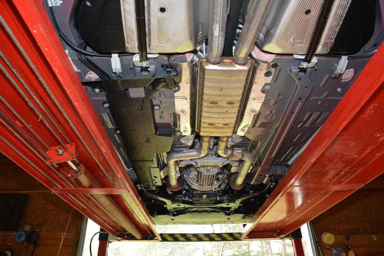

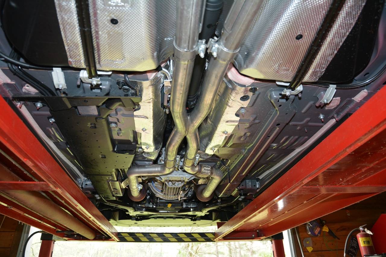

Paper work said hour, reality 3. proly an hour if done once before. Me, 1 hour wrenching 2 hour familiarization course
Got lucky cause I notice the X pipe has a top side and bottom side, before the bolts right on happened.
5.5" rear cut is exact, space is tight, jocking the tail pipe into the rear of the X pipe. Not impossible just be prepared, for it to fight you some.
Use a torque wrench, makes a big difference in the way the clamps draw everything together.
Last: Advisable that it be done on a lift, I doubt this install is possible laying on ones back under the Mustang.

10-4 on the ps wire, knocked mine loose, unplugged. If I were to do one again I'd remove it....
FruityJudy
I found installing and sunging the front clamps of the X, held it in position, easing the tail pipe installs.
Take my word for it I tried to leave all points loose, and fineness the assembly together.
That made things worse, took about 5 sec to realize that was not happening.
A little more on the 5.5in cutoff could ease assembly, would not take much.

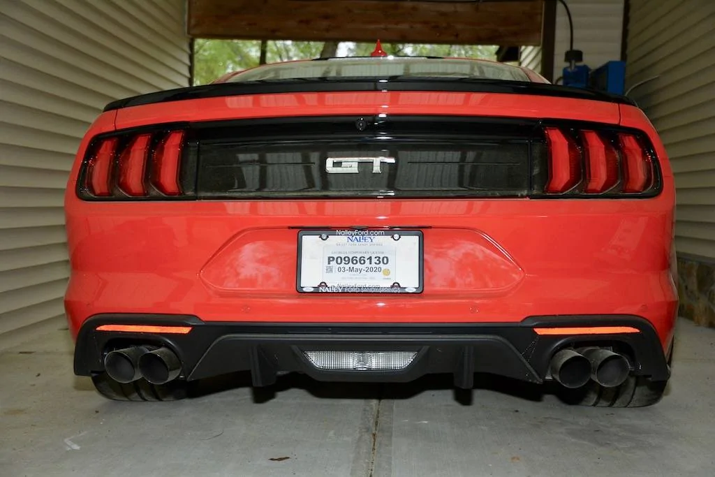

Let's see your tips. 80 percent of mid pipe installations leave their tips cockeyed or misaligned.
You are correct grasshopper, grade my work
