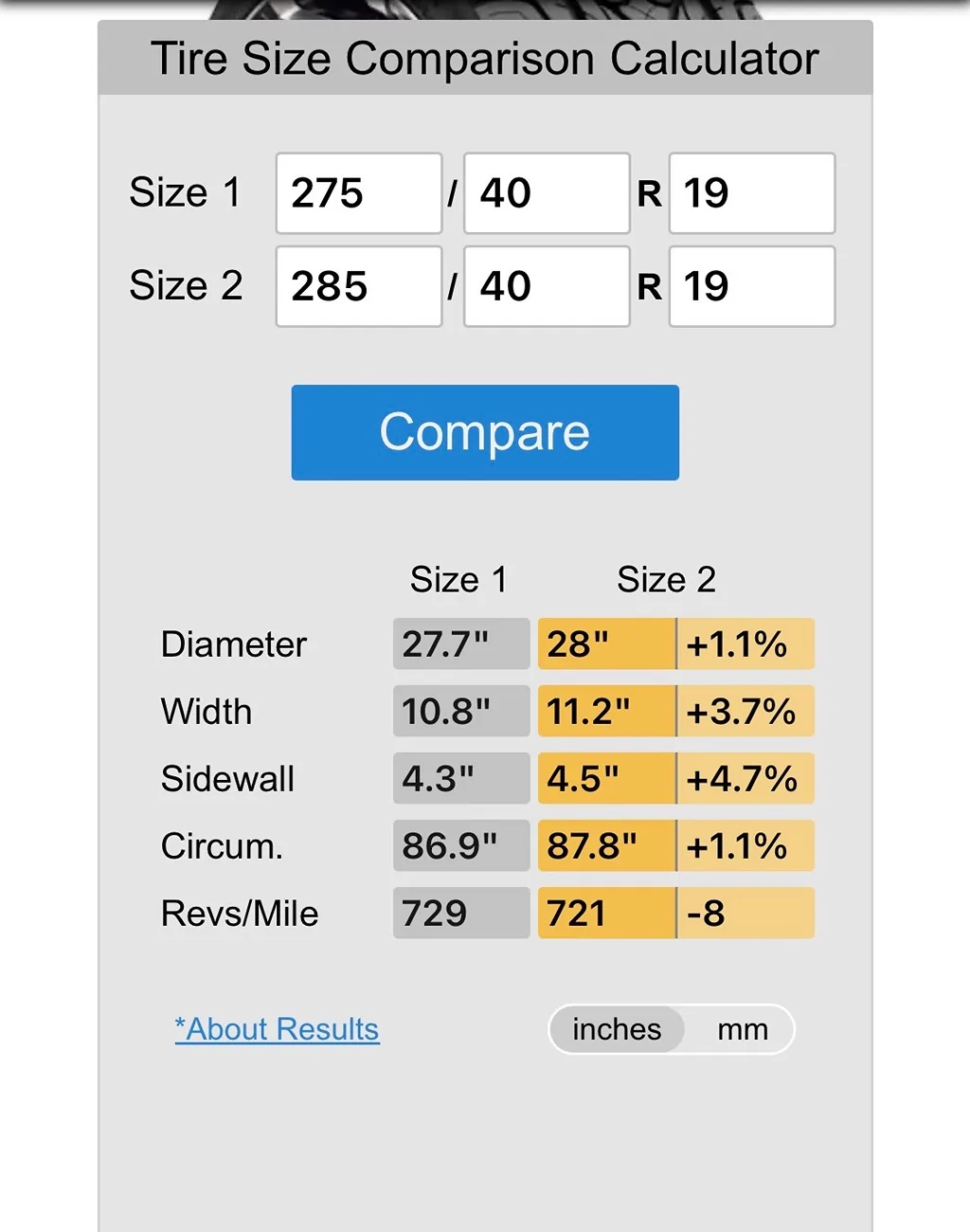

If you’re using the stock wheels, just go 275/40 all the way around. 285/40 isn’t a common size and it’s a really tall tire.

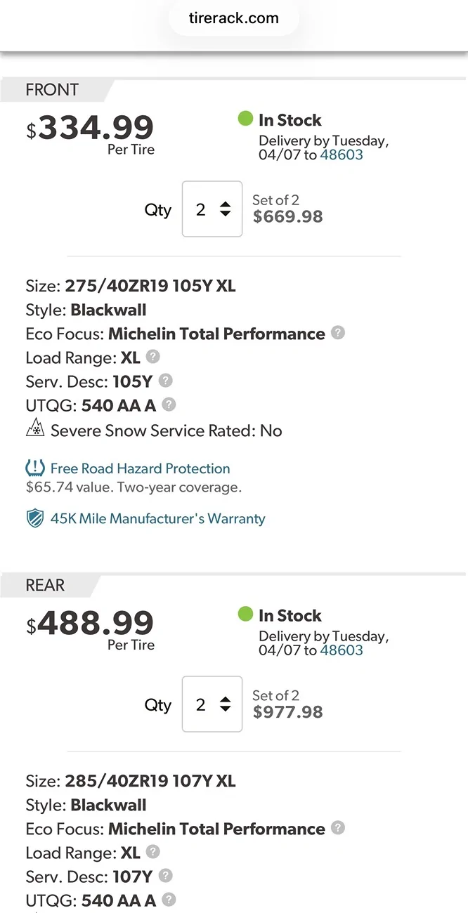

It will be just fine. I have 275/40 all around on 19x9.5" on my S197
I thought about 285's just to be a hair bigger, but then you can rotate them, and I couldn't find a drag radial in that size. And there really isn't much max performance tire choice in that size, looking on tire rack. Michelin has Pilot Sports, PS4S, Bridgestone has two Potenza, but that's it.
lastly, the price jump between just that small difference in sizes can be huge depending on the particular tire

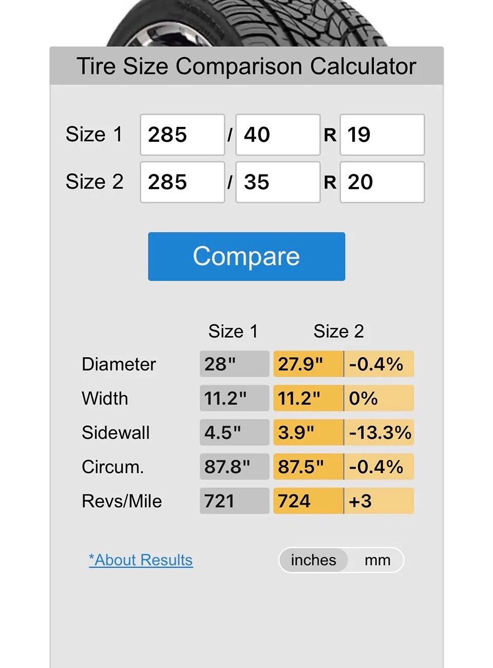

What’s the difference if I put those sizes on the wheels I’m getting?
really tall?? It’s negligible

Depends on what the stock tire was.
Some cars might have had a 305/30-19 in front which is only like 26.2" tall.
