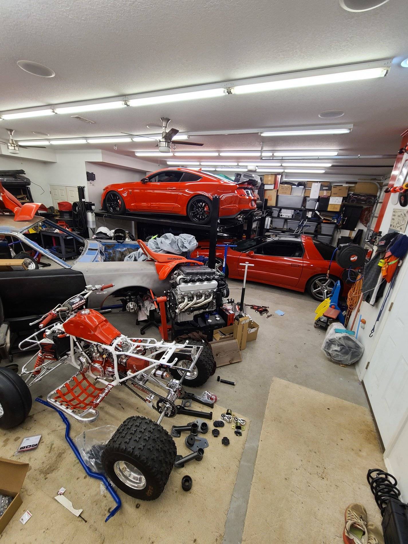

Well this weekend i put a set of eibach gt350 lowering springs on the front. Well.....I likely will be taking them off, and i have not even driven it. Actually it looks awesome but realistically it would be hard to daily drive without destroying the front splitter. The front splitter is 3.5 inches off the ground and the measurement from ground to top of wheel arch is about 26 3/4 - 26 7/8 and I have not even driven it. So likely it will settle some. Pictures below. i haven't done the rear yet as now i am debating on what i want to do.....for sure going with CFTP springs on the front.

Yeah its about 6" from the wall, but appears like it is touching. My lifts are mainly for storing more cars as my car habit has outgrown my shop size. So i have 2 lifts nestled close to each other and close to walls which isn't optimal for working but they see 95% storage time and 5% work time so it works. CFTP springs and new wheels/tires ordered so i will get everything swapped back out and make it driveable, 3.5 just wont work. My shop is total cluster bomb right now as i don't know how to work on 1 project at a time, i did introduce the new girl (GT500) to the old girl (trans am) hopefully they get along while i am away......

What an amazing photo, (thanks for the "forum" full size image too,) Tony and I salute you on your OCD storage style <grin> It's impressive for sure. She looks quite safe and happy on the top bunk. :-) I sure do love the Red of Race.
Your shop is larger than my garage but MY OCD put up lights about as closely-spaced as yours. <smiling> The wife thought I was nuts so I won't show her your photo. But hey, you GOTTA have good light, don'tcha?
I think the exposed engine and the disassembled quad caught my attention first. Only been on a couple, years ago and that one looks like a BLAST to ride!
