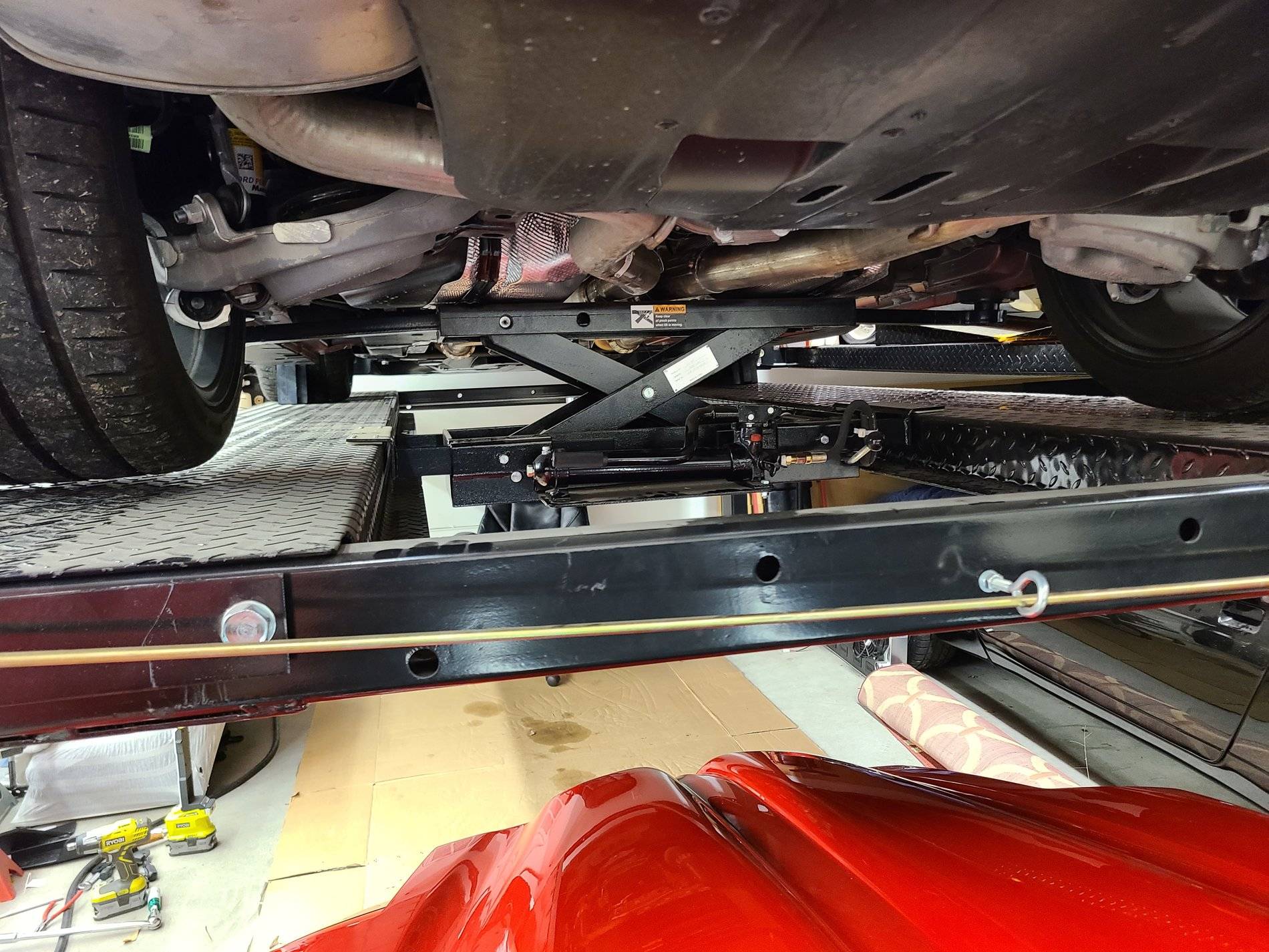

Will start the rear spring install this weekend, along with BMR suite of products, diff bushing lockout, cradle lockout, cradle brace. Also plan to install steeda vertical links and steeda rear sway bar. 1st time i have used the sliding bridge jack on my lift and working pretty nice, not as nice and roomy as a 2 post but should work.
