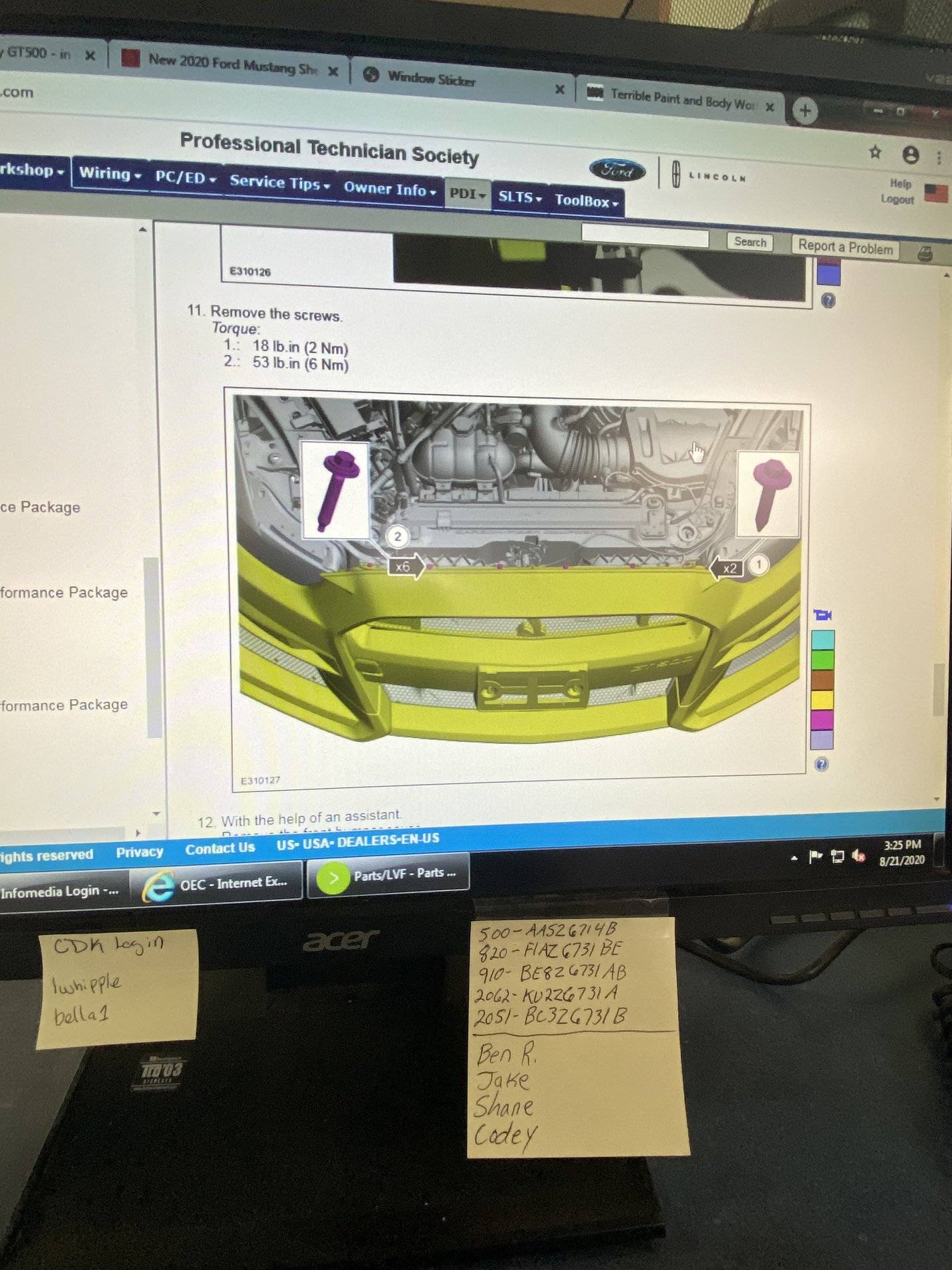

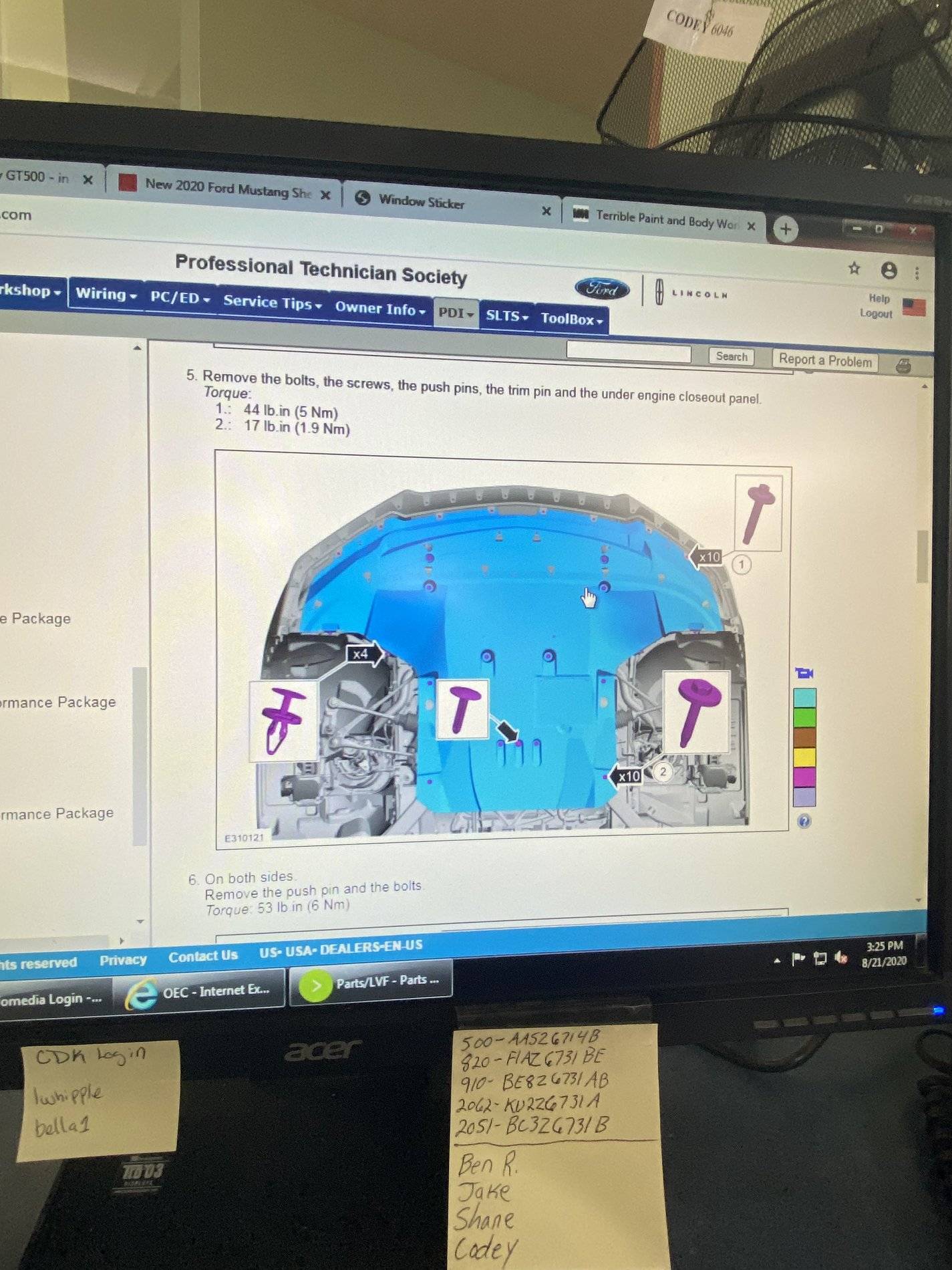

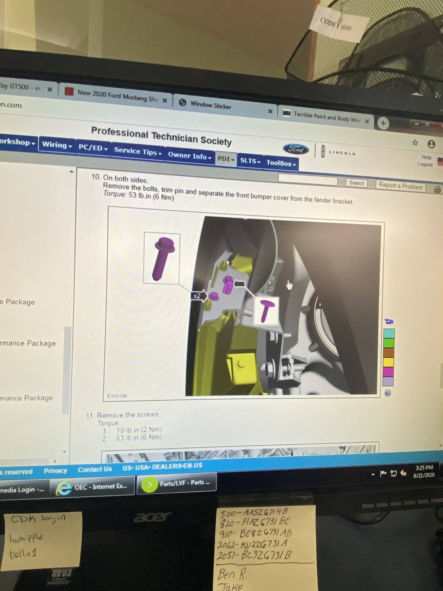

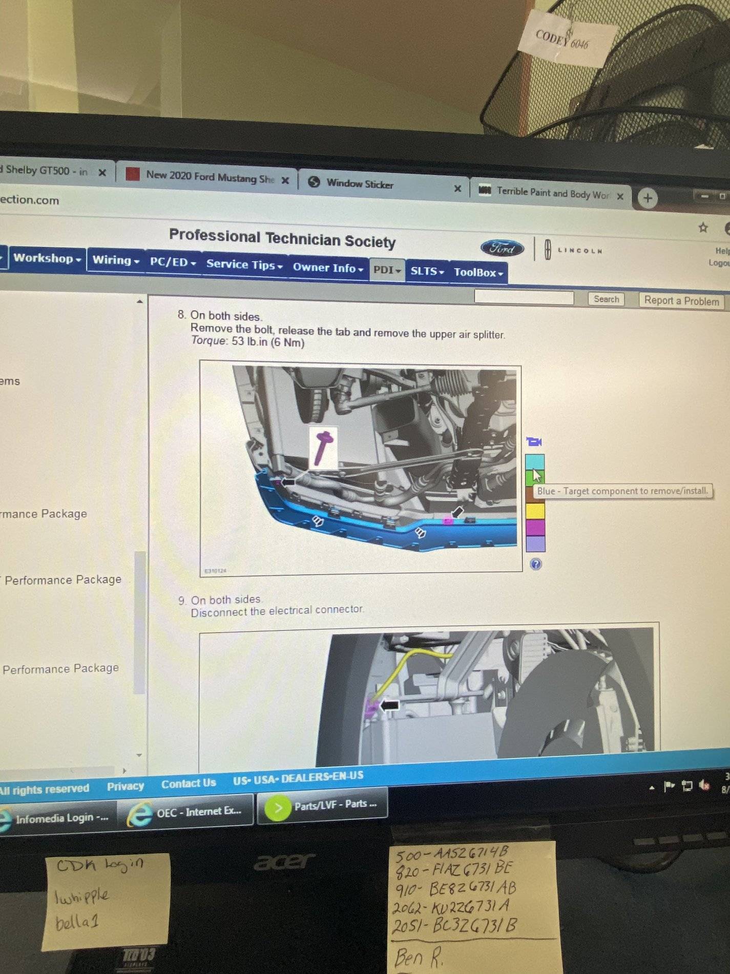

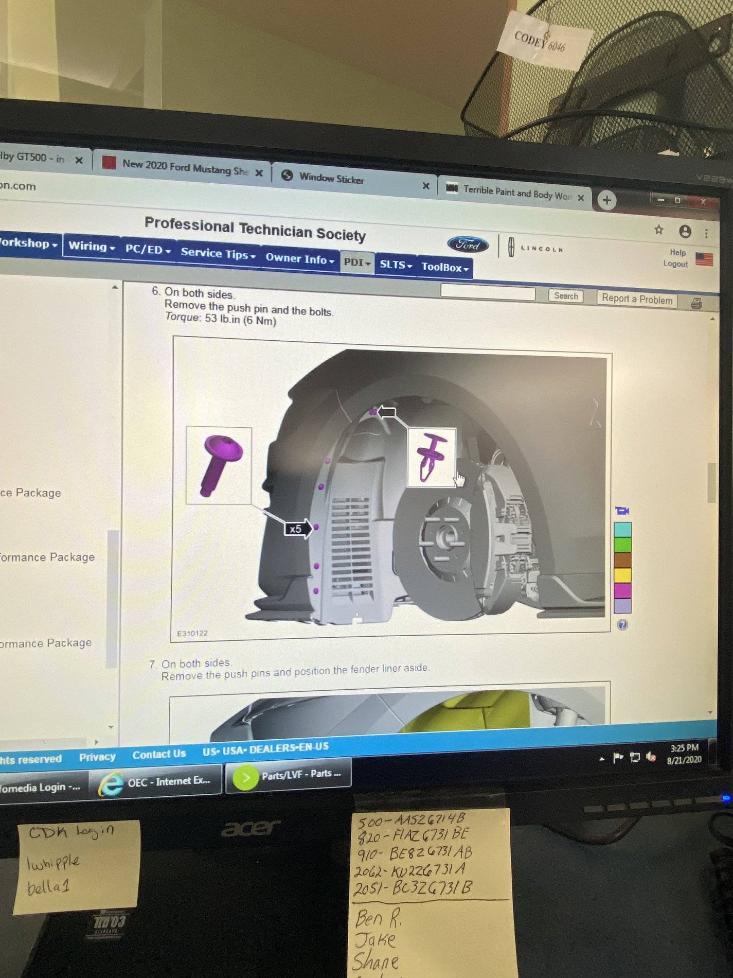

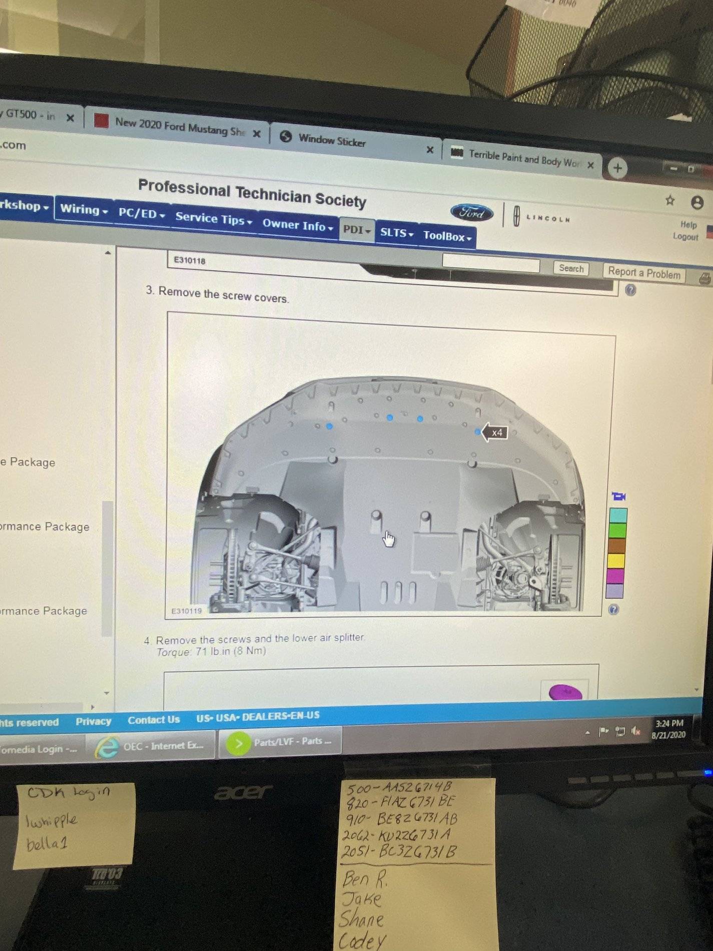

I went to put the winglets on from the handling package today and the body shop put all the bolts for the splitter in the wrong locations. They also over tightened everything. I got underneath the car and there are a few hex bolts missing and at least two that have stripped heads. :angry:
Does anyone have the part numbers for the bolts that hold the winglets on? Also the instructions for the splitter install? The dealership parts department can't even find them in their system.

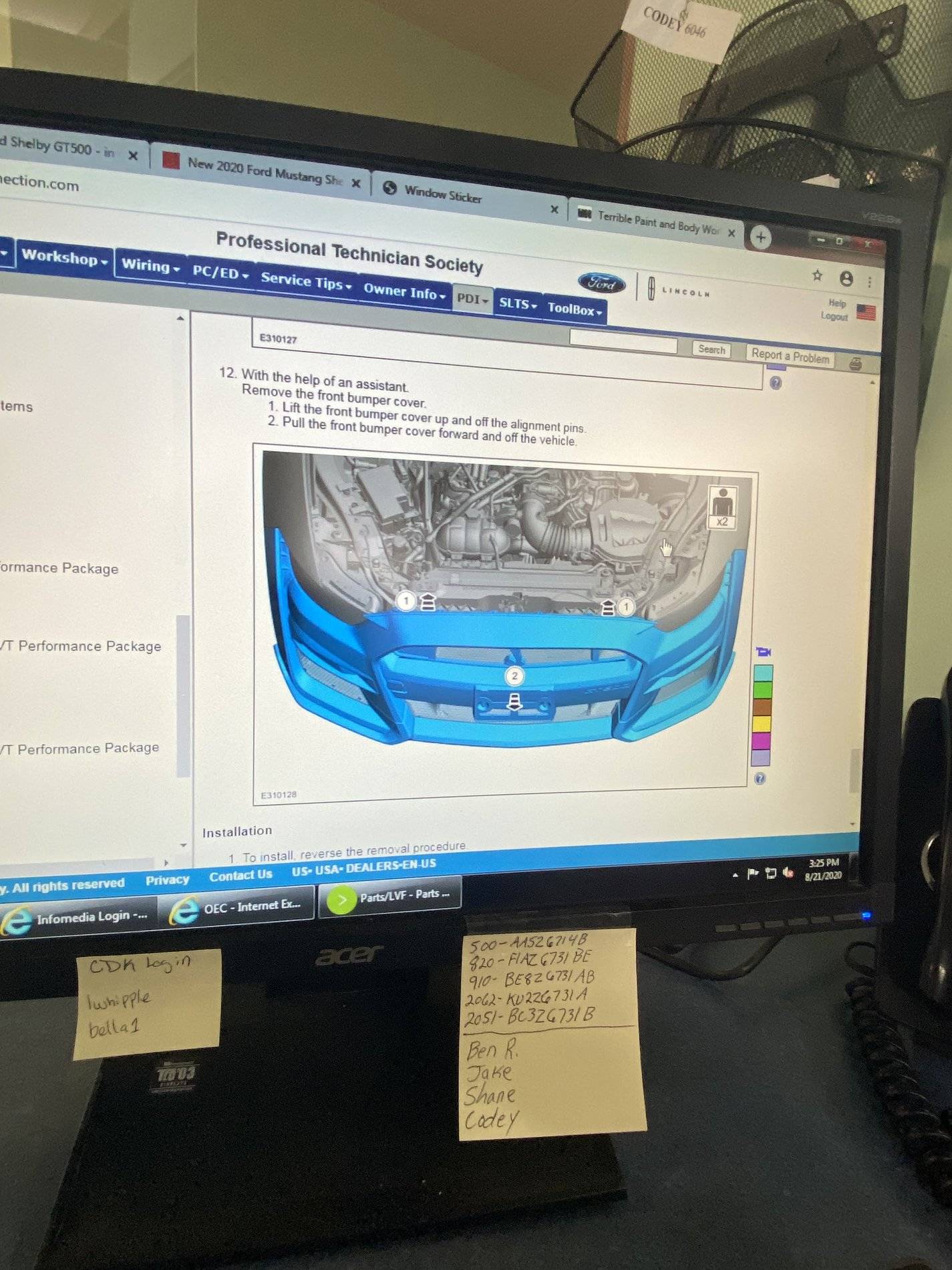

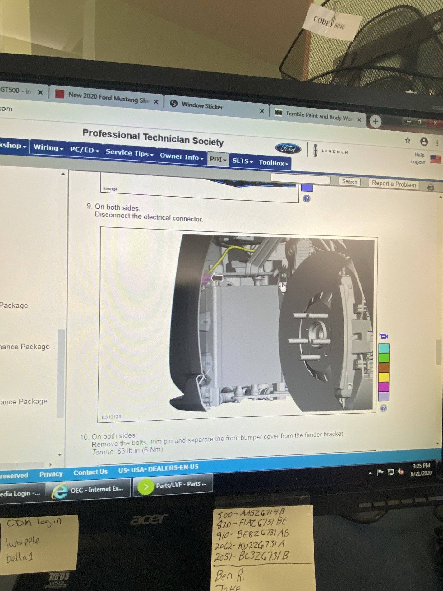

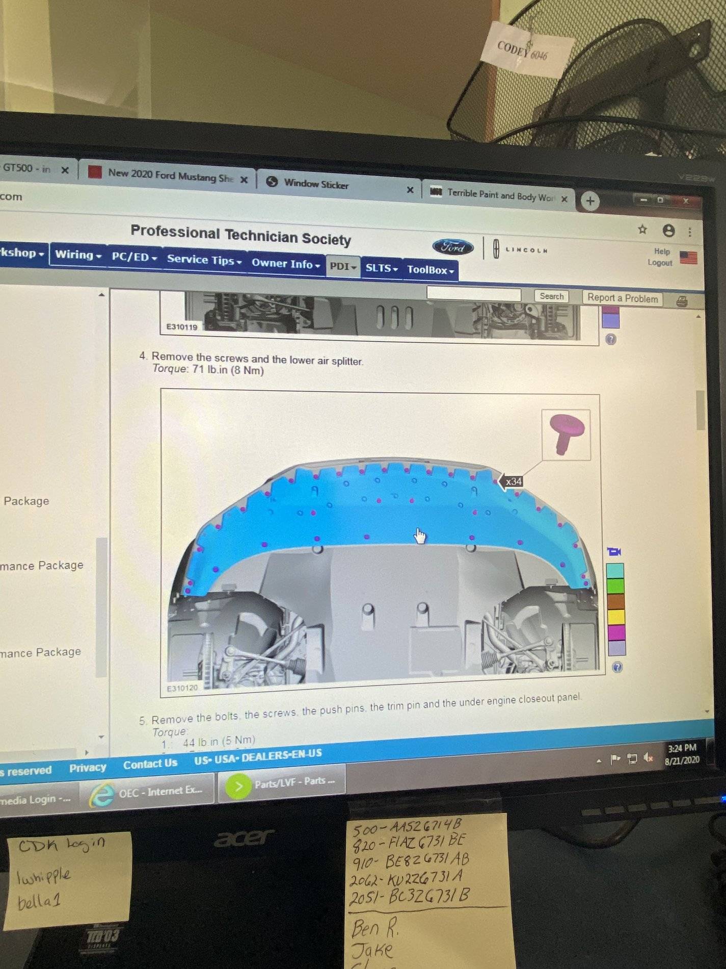

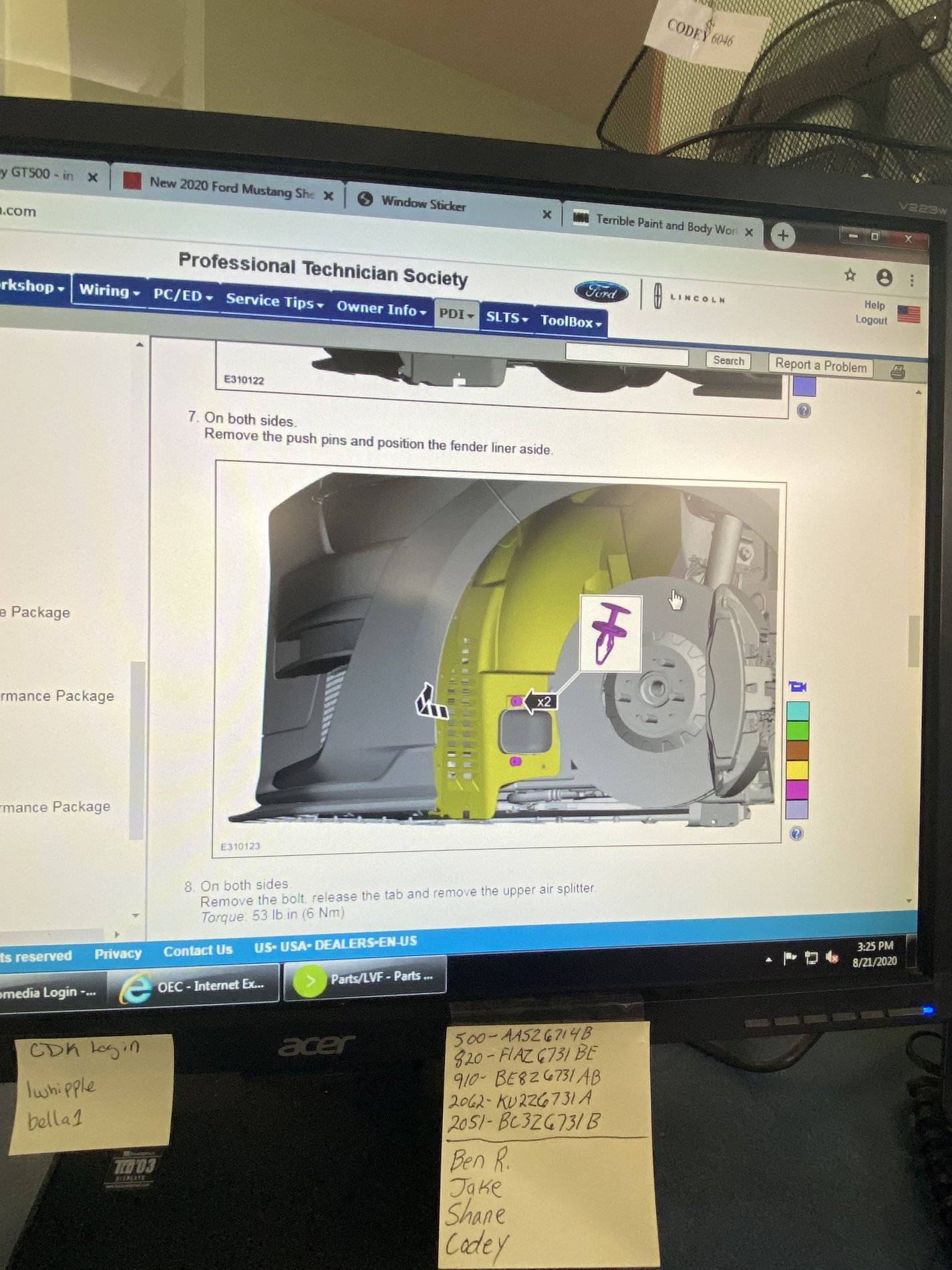

Here you go.
W711581-S450
W716195-S450B
you need one of each underneath per side.
Nuts- W520802-S307. 3 per side.
Bumper cover/splitter install and removal:

Here you go.
W711581-S450
W716195-S450B

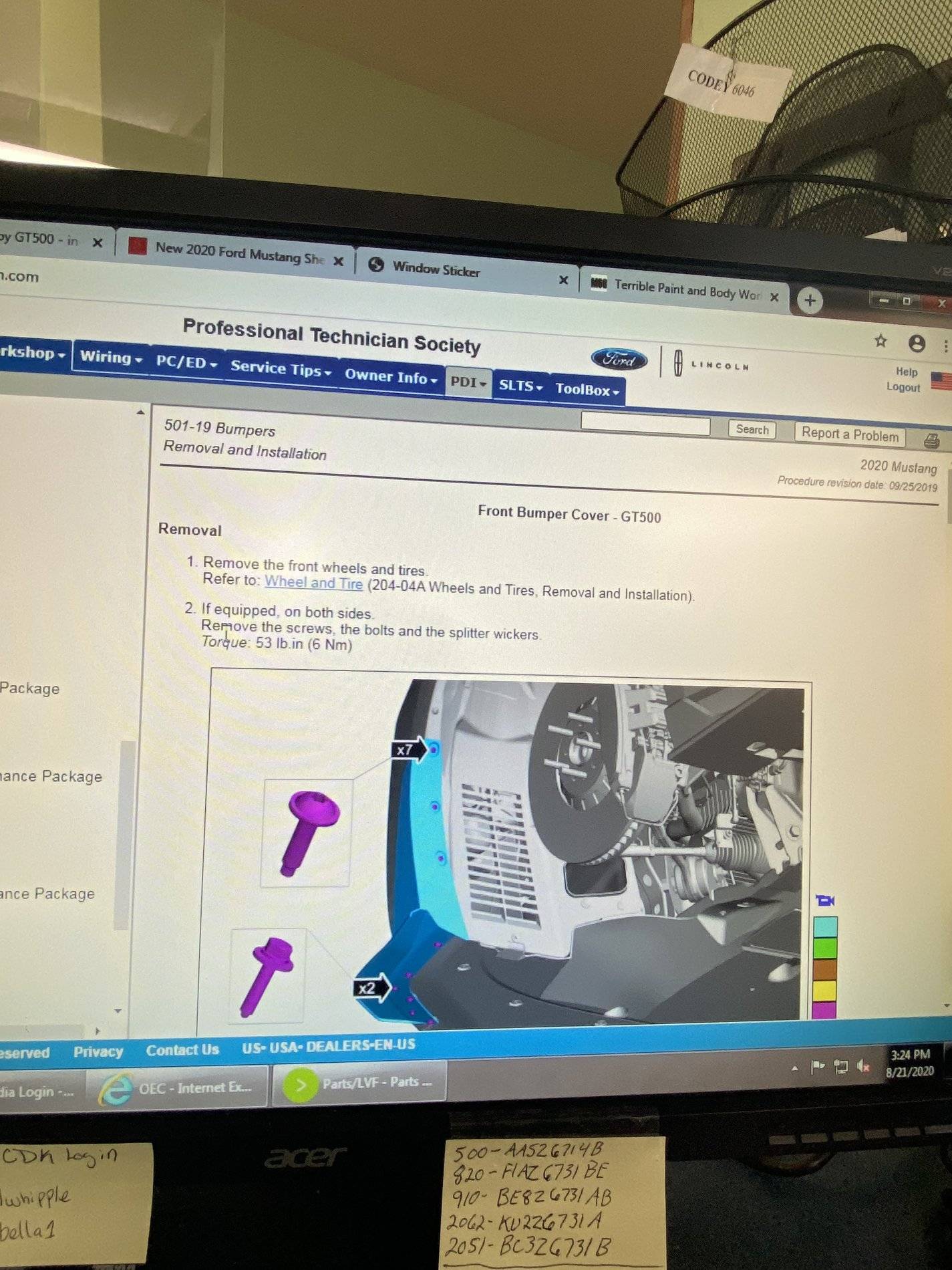

Thank you! What website is that from? The last hex bolt I need is the one from the first picture that needs 7 bolts. It is not showing up in the numbers you posted.
That’s from PTS which only dealers have access to. The parts I listed were just for the wickers. If you need those too, I’m fairly sure it’s going to be the same as one of the 2 I listed. Ford uses those 2 bolts a lot.

I bought a used 2019 GT350R with 171 miles on it. I checked under the front splitter and some of the bolts were missing. Got the bolts from my local dealership and a video on how to install the splitter properly. I swear the PDI techs don’t seem to follow instructions very well on these Shelby’s. There were a lot of early GT 350 with the front splitter installed improperly. They had large gaps because the tech didn’t snap the splitter in properly before they tightened the bolts.

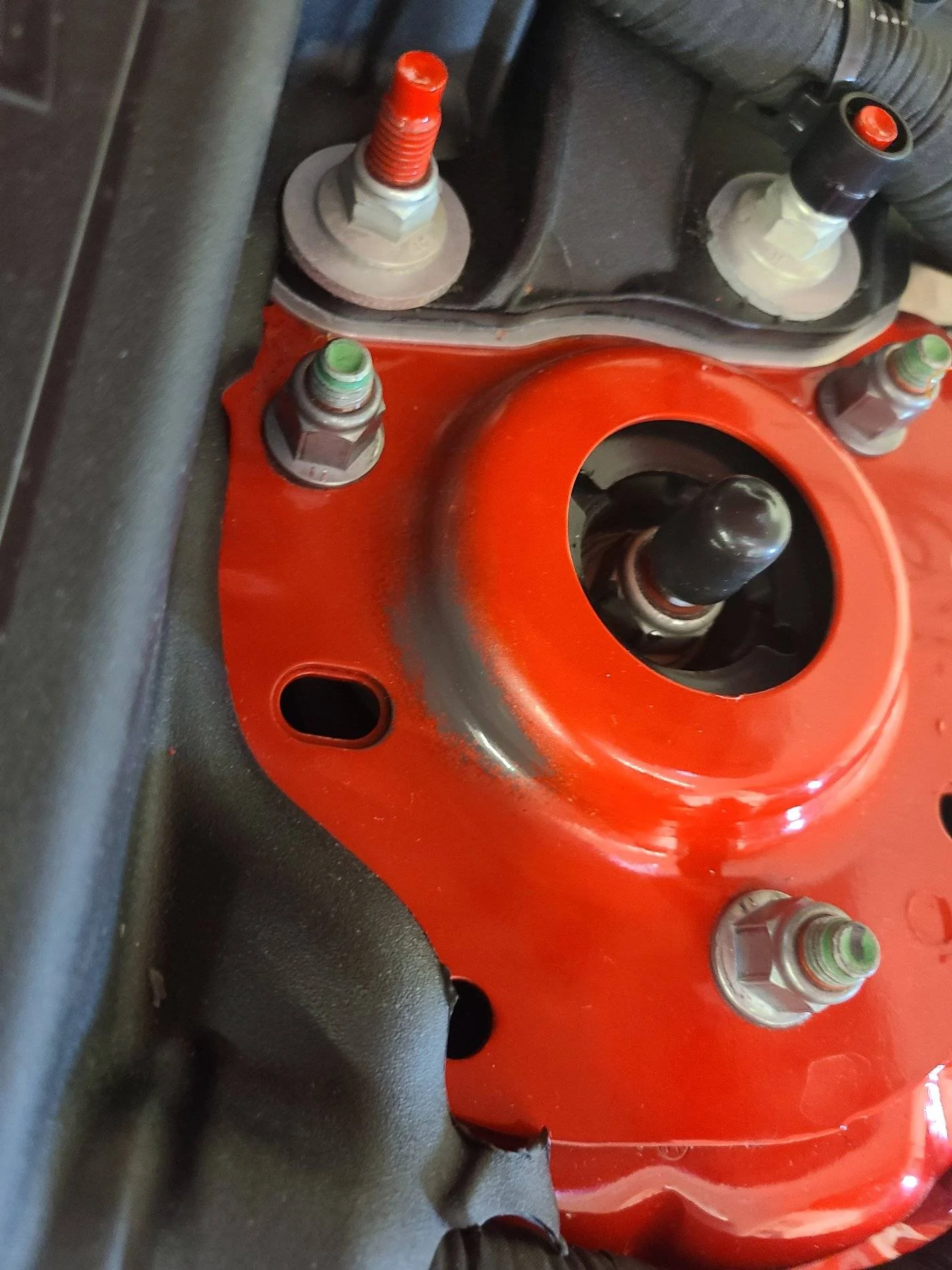

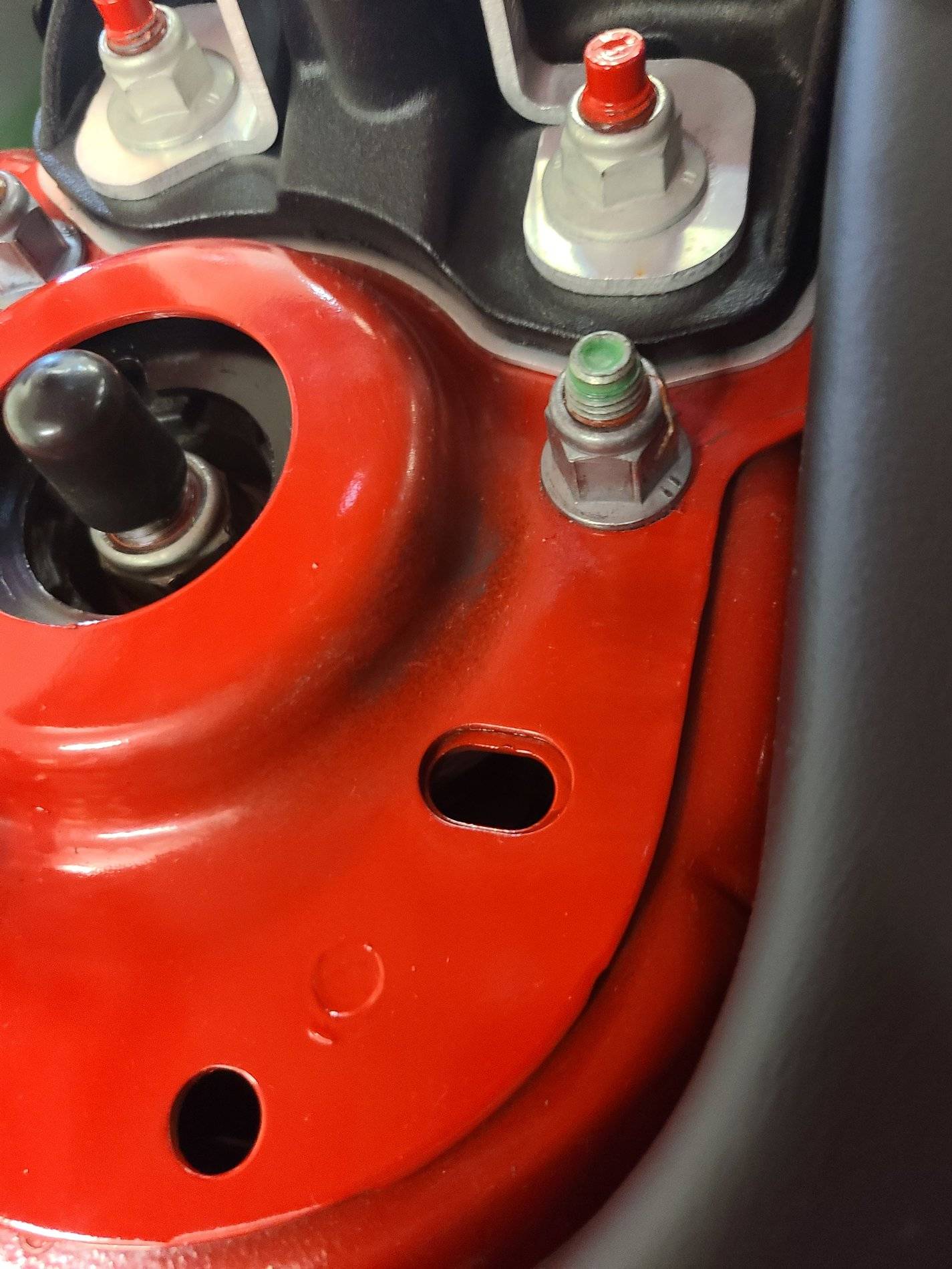

So i was installing my strut cap covers which use a few 3m adhesive velcro tabs. So as i have done a million times i am prepping the area around the front strut towers. Using regular old rubbing alcohol , YES i am sure it is just regular rubbing alcohol. AND WTF the paint on the back side of my strut towers wiped OFF. Seemed to be isolated to the back side of the strut tower, both sides did the same thing. Luckily the missing paint is covered by the covers but makes me wonder what the hell is going on.
That area doesn’t receive the protective clear coat. You can most certainly rub the paint off with cleaners.
protraxduner
Jan 22, 2018
939
693
OK
2020 Shelby GT500 Race Red
clear or no clear, paint should not rub off like that....unless there using water colors.....
