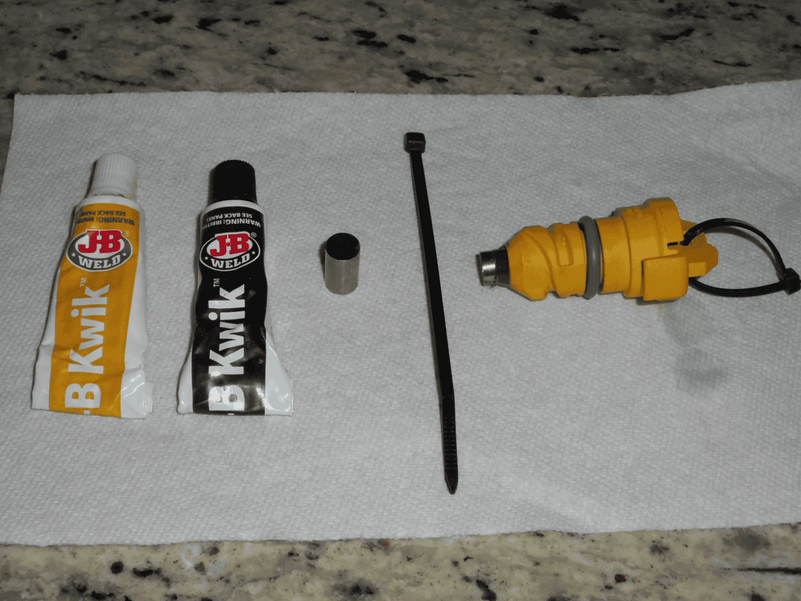

OK Boys and Girls here is a DIY project for less than $5.00
Your original Oil Pan Plug, A $.50 Magnet, (1) Tie strap, and some JB Weld Quick. Drill a small hole in the tab on the Plug, install the tie strap ( Adjust to your finger size), Epoxy the magnet into the hole in the end of the plug. Presto a Magnetic, Removeable Oil Pan Plug. Why in Hell spend $50.00 for something you can do yourself?

No freakin' way would I trust a rigged magnetic drain plug to keep my engine safe. I'm pretty certain such a thing poses more potential harm to my motor, than any perceived benefit.

I would have to agree with you. Guy spends 40k dollars on a vehicle and is worried about $50 for a magnetic drain plug. I understand people wanting to work on their vehicle, but don't hack something together ON A BRAND NEW VEHICLE...
It would be different if you crafted another drain plug from a CNC lathe or something similar.

What if it came apart? What if it hurt the sealing integrity of the plug itself?
I understand wanting to craft and fab something, but that's a rather critical part.

The other nice thing about the $50 one is that it doesn't have a tendency to break like the stock plastic one.

To be fair to the guy, JB Weld is going to hold, particularly if you scuff up the magnet first. I would use a brand new plastic plug to make sure there was no oil residue preventing a bond. There is no load on the magnet, just vibration and heat. I'm not going to do it, but JB Weld is good stuff and is probably going to hold very well. Regular drain plugs are $10. My experience with JB Weld is it can get brittle over time, so you should probably just use a new plug every 20K or so.
I would ask what the purpose is? To pick up metal shavings, or so you can see them when you drain the oil? If you just want to see what's there send it in for oil analysis, cut open a filter, or run the oil over a magnet as you drain it.

Stick the magnet to the side of the oil filter and swap it to the new filter when you change it.
The filter catches any metal anyways. I guess the idea for the magnetic plug is to catch any metal shavings before the oil heads to the filter, so you know if there is an issue.
This.
I've stuck magnets to the side of filters for decades. Beats trying to clean the thin, slimy swarf off the end of a magnetic drain plug like those on some motorcycles, and be sure you get it all....
For the record that is a Brand New Drain Plug and yes I scuffed it before JB Welding. I have been drilling out the old steel ones and epoxy magnets for years. I still have two or three in my parts drawer. These were from the 70's never failed or broke. The UPR is the same exact drain plug just up graded with metal ears. I have also been putting speaker magnets on the bottom of oil filters for years. In any event it was a dull Wednesday and that's what I did.
Is that correct?
To be honest, I do not use a magnet for engine oil since the filter will pick up any and all metal. Also, magnet will only pick up ferrous particles.
I have used magnetic drain plugs in transmissions and differentials since the do not have a filter and over time can have ferrous particles in the oil.
