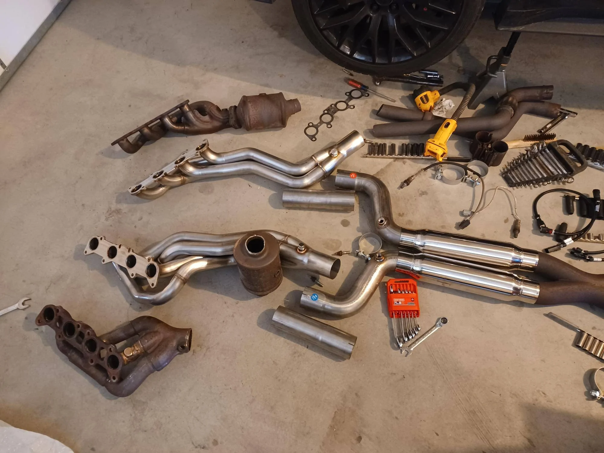

Hey, you'll be replacing cats sooner or later with FI. Mine just went out. Spent 700 on Stainless works LTH/Offroad's Mine got clogged up. LT installs SUCK for sure it took me 8+ hours on jack stands. Friendly tip if you do end up doing LT's install do yourself a favor and just remove the passenger side motor mount its not worth it time wise not to. I fought it for hours then still ended up pulling it out and them boom i was done in 15 minutes. You'll gain some power and if your replacing OEM/Cats anyways go the cheaper route with LT's. "Emissions" can be fixed, it isn't hard. I didn't do it for the power I did it so I'm not replacing cats anymore. Now down the road If i want to tune for more power I have that ability. Also where the factory connect is, I just cut the reducer off and put a set of resonators in. Boom I have the beautiful sound of LT's no drone its not any louder and its 3" all the way back.
