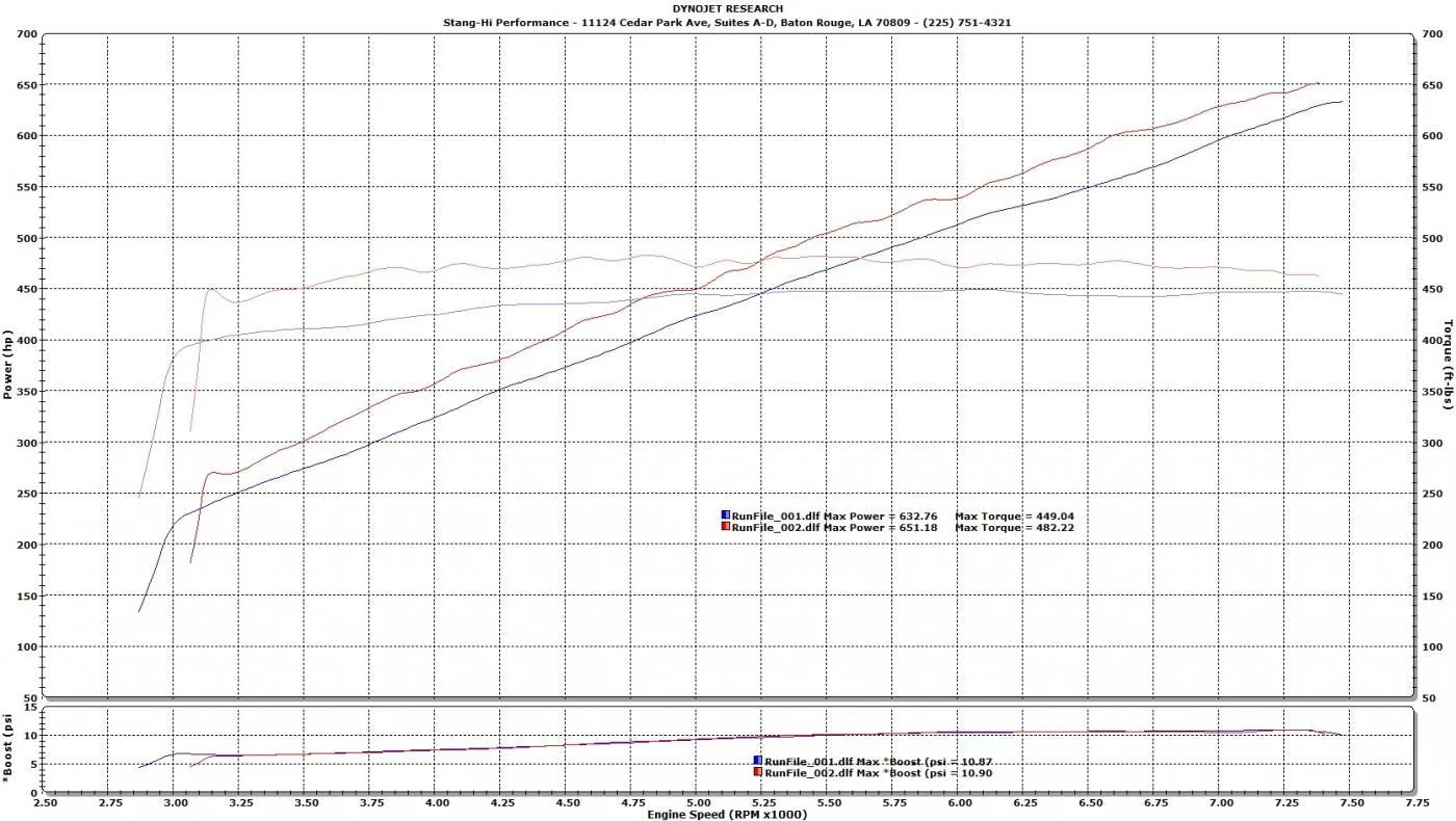

I just picked up my car from Stang-Hi where I had the new Whipple installed with the latest calibrations from Whipple as I want their warranty. Cody at Stang-Hi gave me a great deal and even better earned my trust and offered great service which is key when you are about to drop that much money on a car you have already have about 40K in.
I have to admit I have been reading a lot on this site about Whipple and how great the drivability is with their tune on the auto but reading didn't come close to how good it actually drives. I was blown away, Whipple has it down and on a very conservative tune, stock car other than Magnaflow catbacks my car dynoed 651 rwhp and 10.9 psi boost on a warm day.

Whipple dyno
1st pull 3rd gear, 2nd pull 4th gear
About 85 ambient temps with car hot, I'm satisfied :)

Car drives amazing and 651RWHP, 482 RW tg I will be smilling for a long time :) Call him up I'm not getting any commission.
