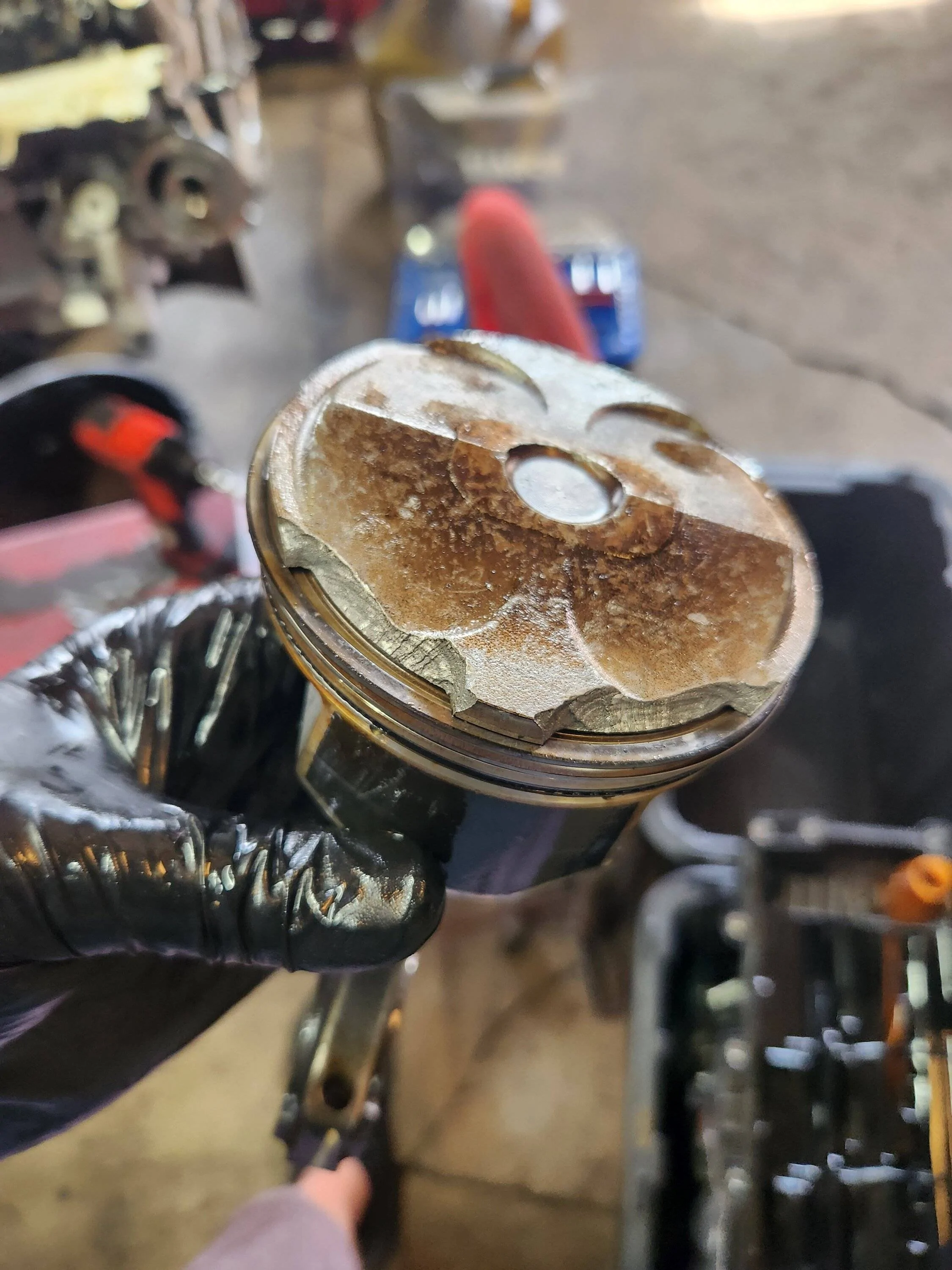

850 on E is doable with the listed mods. 700 is really doable on 93, just watch doing back to back runs on hot days. That top ring gap is very tight and gets tighter the more heat you put to the top of the piston. You do it enough times and bad things man...
Wow yea good advice, I know at some point down the road I may have to cross that line but would like to not have to do that for a little while. I’m guessing the 700 on 93 power level is much harder on the motor that e85 at the 850+ mark.

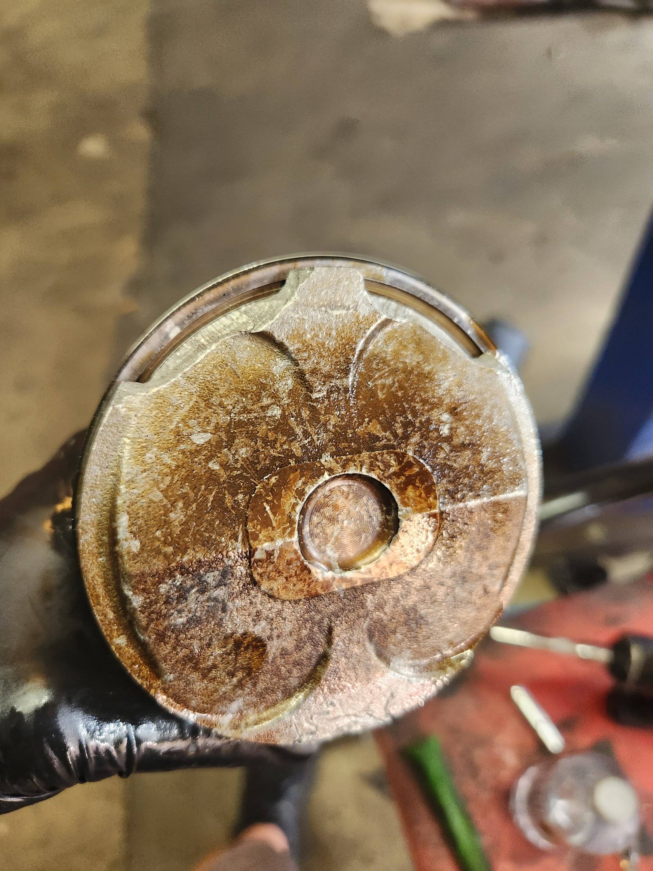

That piston wasn't damaged by knock, that's from the ring gap closing because of the heat of combustion building up.

2018 Mustang GT
Perhaps. I think it would have taken a little more than a splash to have saved me that day.

2018 Mustang GT
I know one thing, I gapped the new motor for boost and I will run it 99% of the time on at least e70 so it won't ever happen again.
