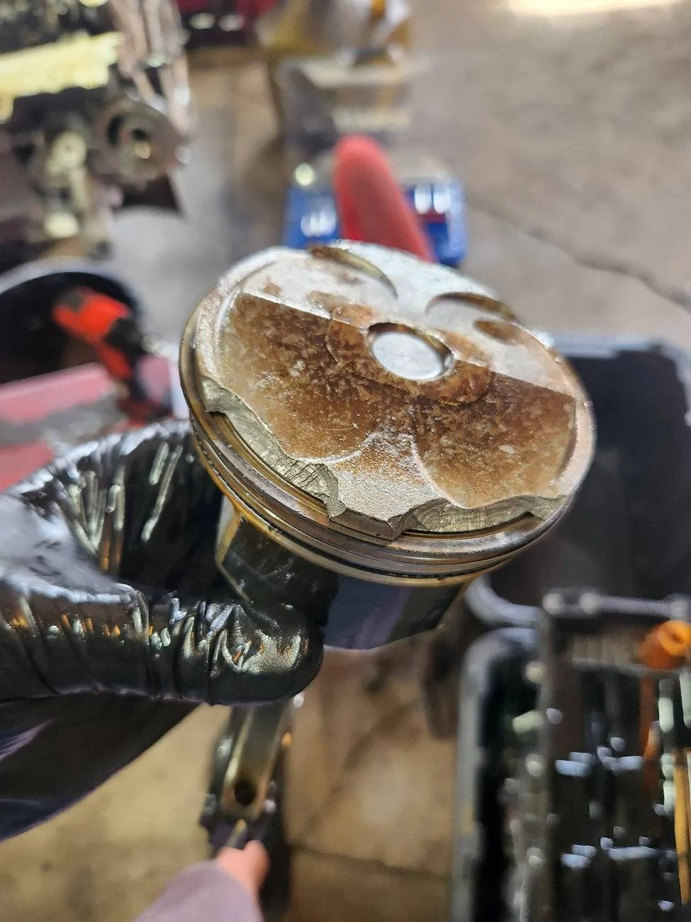

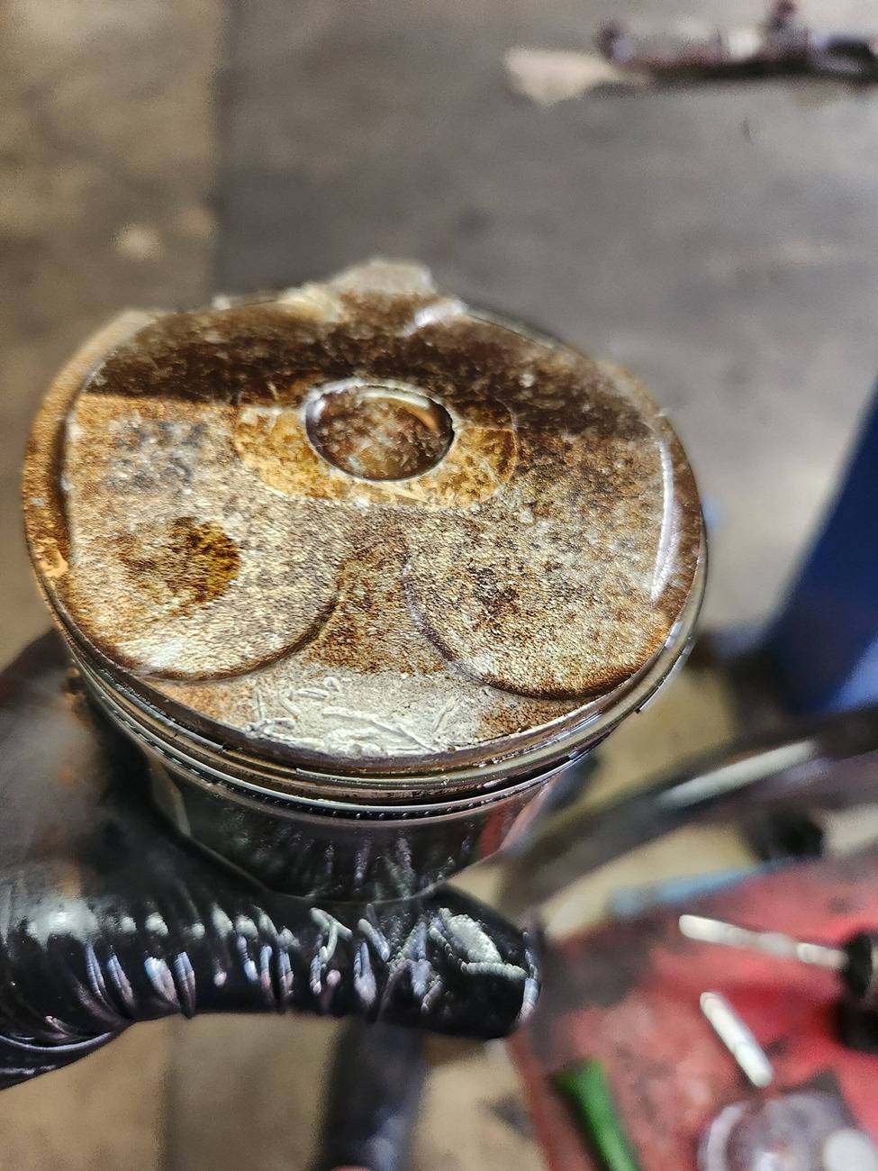

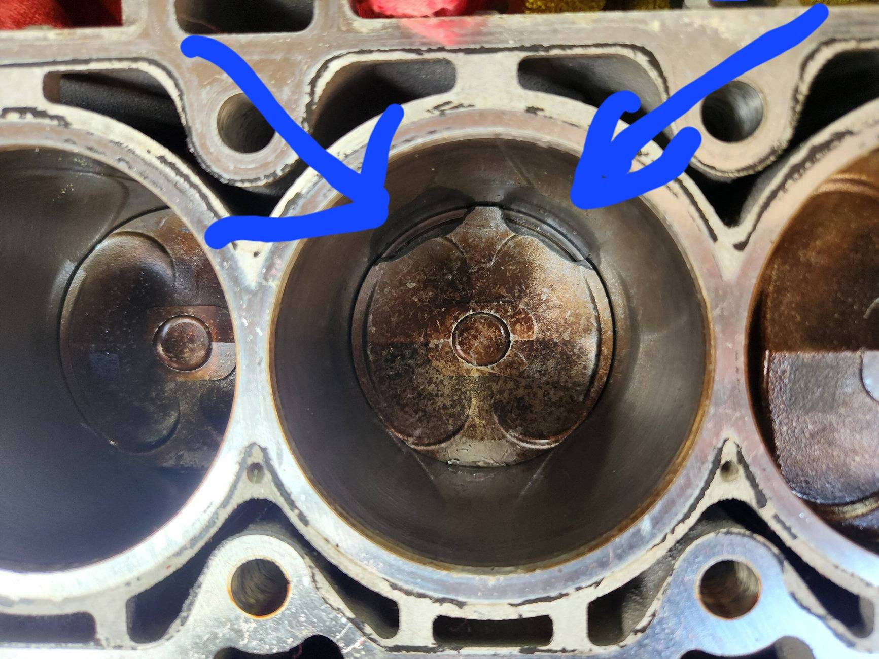

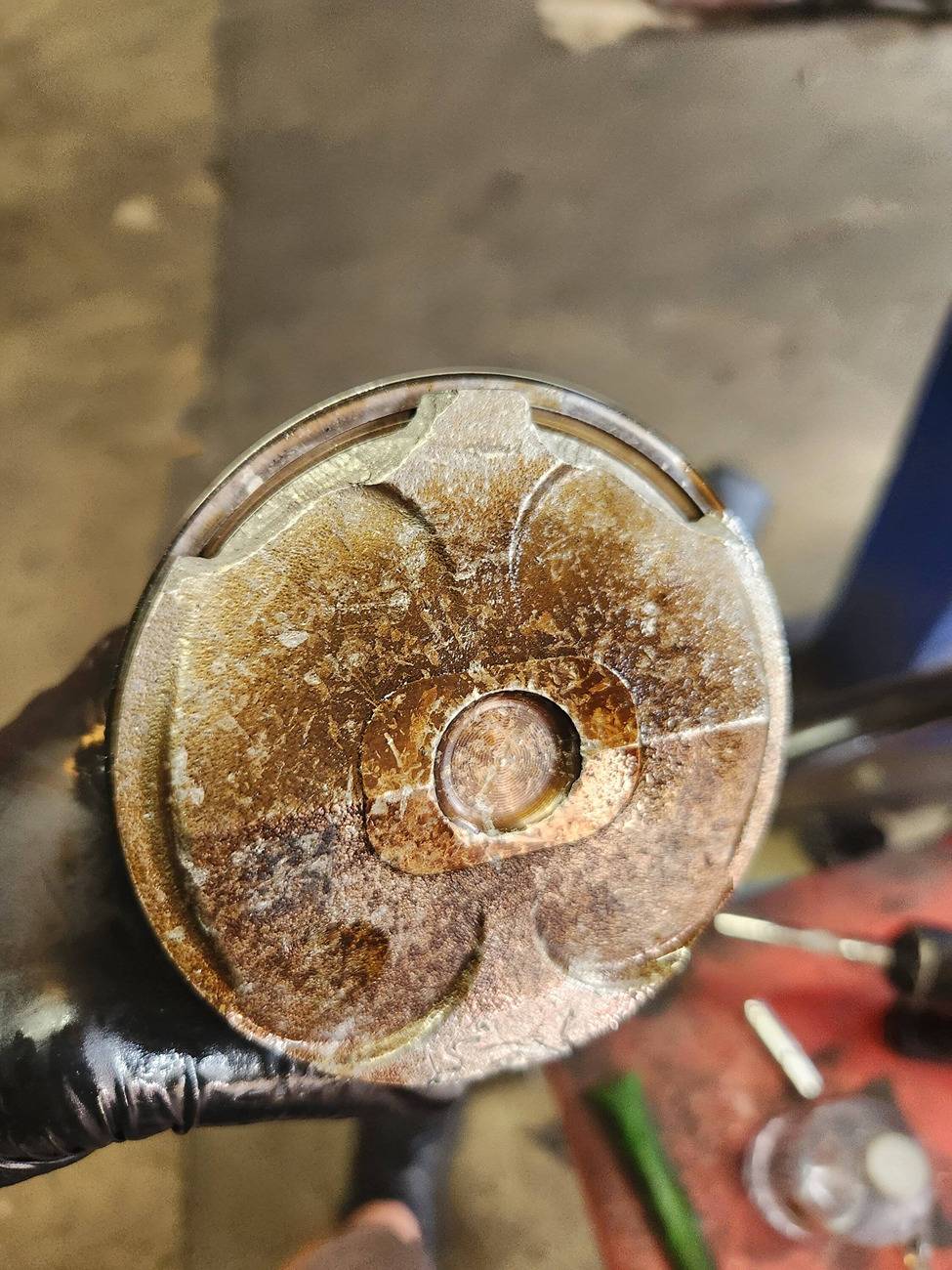

It depends on your tuner and what he does with timing and knock. I will tell you, do not run back to back to back pulls without giving the pistons sufficient time to cool if you have stock pistons with stock ring gap. You will be putting it at a serious risk of ringland failure. I get that yours is a 2.9 and mine isn't, but the principals are the same. Heat and compression on 93 octane can be bad. Ask me how I know...

@HKusp how much boost and what power level were you at when you experienced the ringland failure?

I was on 93, the 3.875 pulley at 12ish PSI, probably 750ish WHP based off of air consumption numbers, never dynoed, and I was certainly north of 17* of timing. EngineerMike was playing with my tuning a while back and he saw 21* North of 7000rpm if I recall correctly. But the failure was done on back to back to back highway pulls running 2 GT500's in 100*+ temps.
