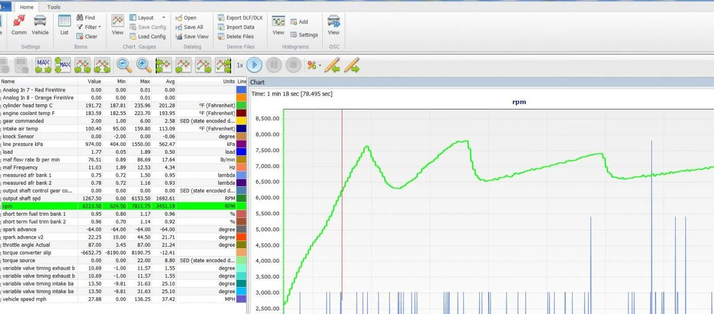

here is a graph from one of our 9 second runs.
the graph starts where I launch the car foot braking it, so this is from a complete stop,
just under 1 second into the run, you can see the rpms are already at 6223 rpms.. that's less than 1 second from a complete stop.
a roll would be even less, and , this is an auto car with 4 gears to 1 to 1, a manual has 5, so the gears are even tighter and would be less time.
on the shift, the car never drops below 6300 rpms... 6300........................
our vortech car, and the prochargers, make peak torque, closer to where it's needed for a run.
if your racing, 95% of what you need is from 6000+ those are just the facts with racing.

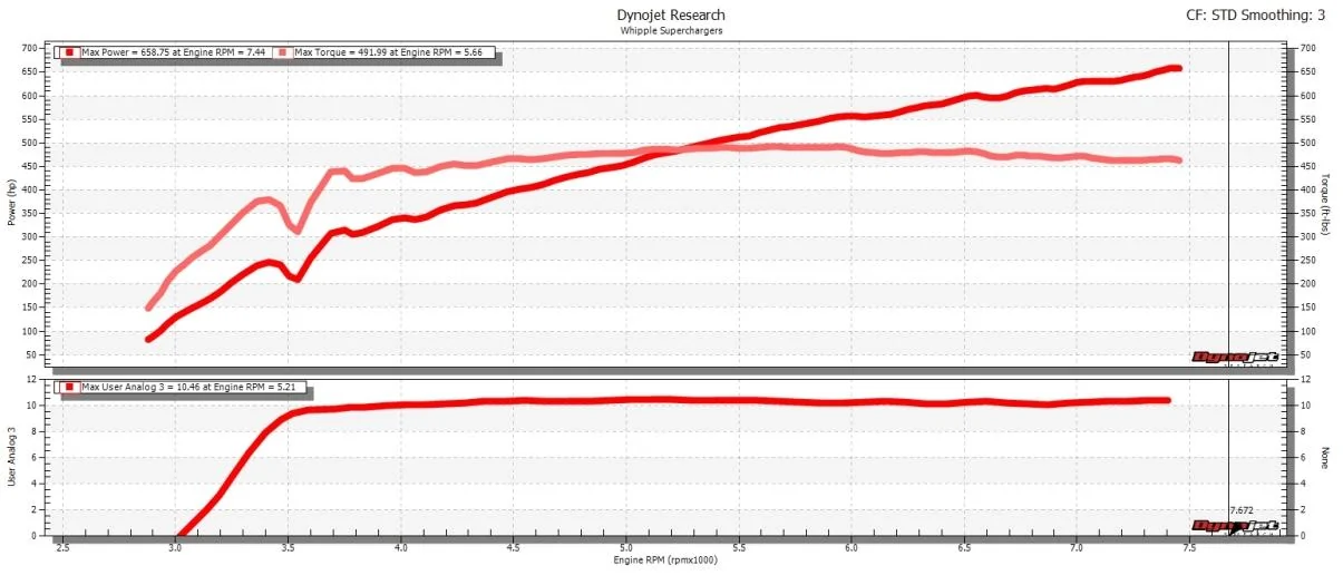

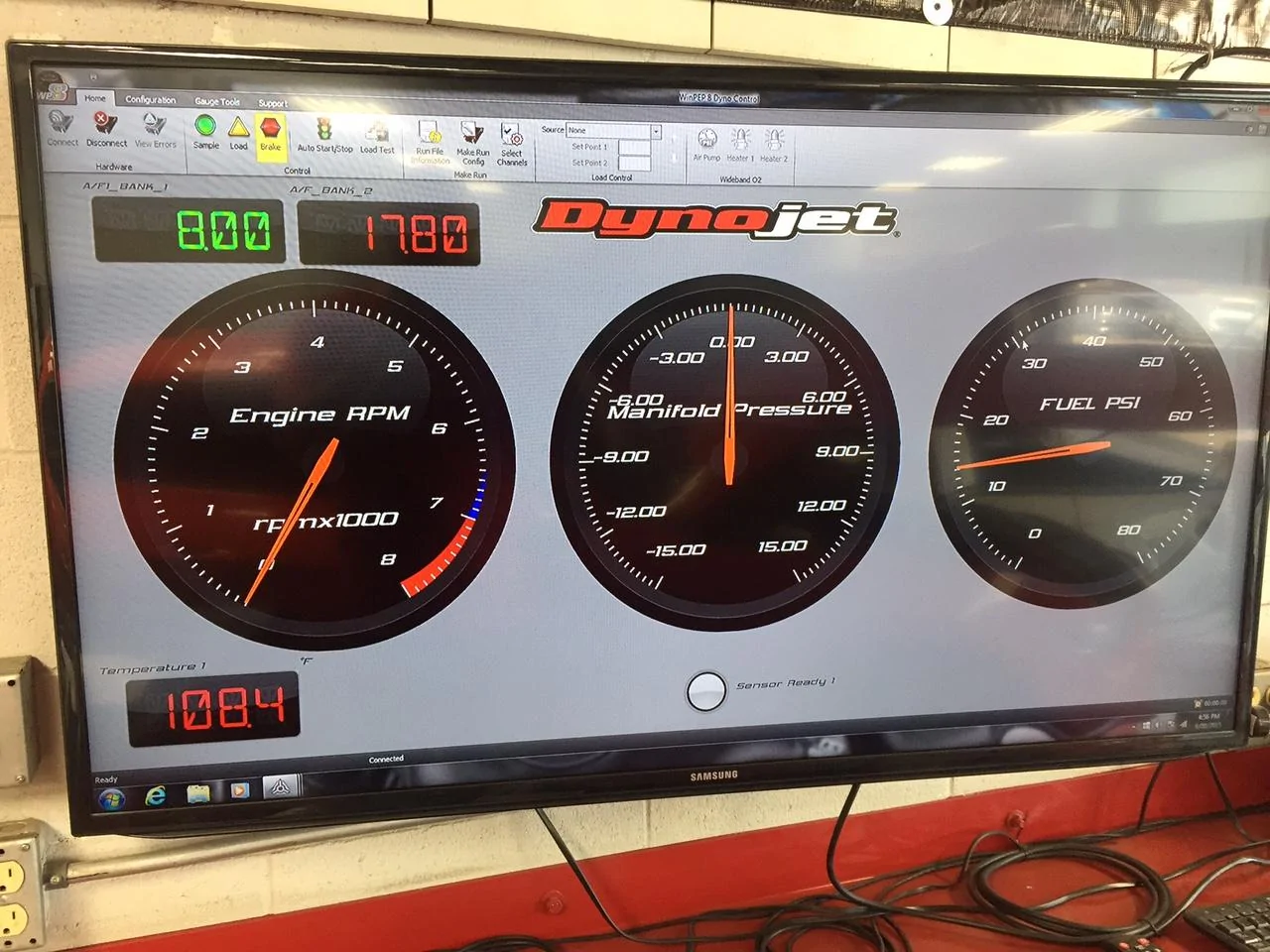

100% stock vehicle, 350 miles on it, testing today, 108.4deg F in the dyno room since Fresno is like the Sahara desert today. Don't mind the dip at tip in, got some wheel slip. Take a look at the boost curve.

I would love to see 4 pulls and the IATs at the end with a 108.4 ambient.
Seriously, not poking. I think that data would be beneficial.
Which throttle body was this with?
