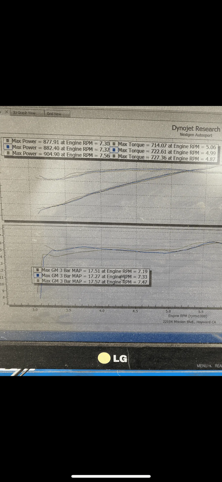

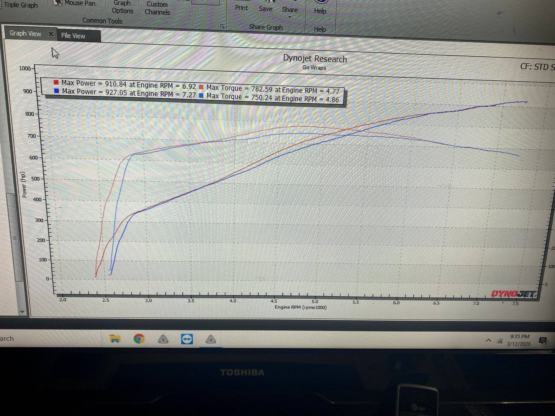

Do you have before and after dyno graphs?

I have both graphs from my phone. I thought i uploaded them already with the OG post.

Who did the tuning on these combos?
Also, do you have better versions of the graphs? There’s a lot of detail missing.
I emailed them for email versions of the graphs, as i was suppose to get them right away....
Lund Tuned on both setups.
Wouldve been nice to see the VMP pulled up near 7500 like the whipple, looked close.
The VMP was pulled to 7500 and the Whipple was pulled to about 7350 so its either way the same.

Nvm. I thought the lower graph with the 910 and 927 pulls were both the VMP and Whipple overlapped
Haha no problem, ill post the computer versions when i get a chance if they ever send me them.....
