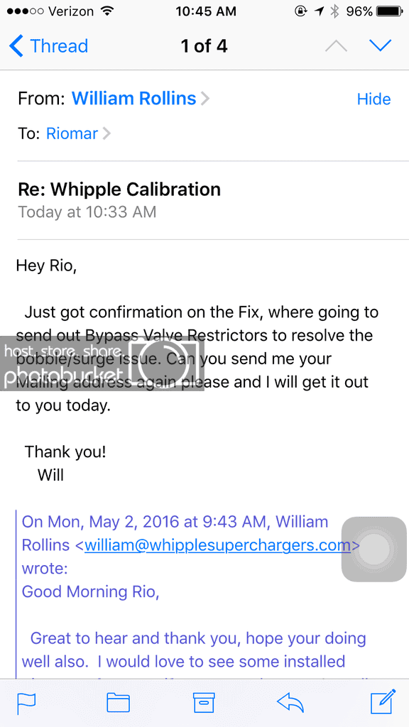

    Whipple always comes through. Emailed last night and comes back with a solution today. Hope this works out

    Been around the block a couple times on this one. It’s an enigma in that some cars have and some don’t, but it’s related only to manuals.
    The restrictor didn’t work, neither did the decals to fix it. Mostly this is due to calibrations issues associated with carb compliance for cat protection and inability to lower when power enrichment comes in. Unfortunately they can’t moves those numbers enough with violating the carb standards.
    In my experience it all went away with PBD calibration.
