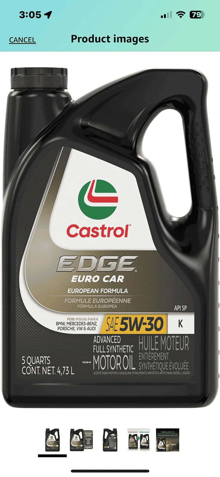

Thanks for sending this…
I’m thinking to go with Castrol edge 5w30 for the summer ?.
