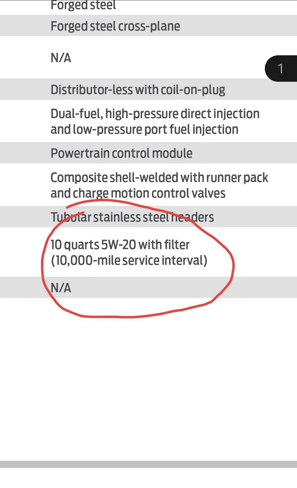

My 2022 oil cap says 5w30, but Ford updated their spec to recommend 5w20
At operating temperatures the Delta between the two viscosities is nearly non-existent. I stop just shy of saying there is no difference, because obviously there is. It's just miniscule. But small differences can have big impact on car with very tight tolerances.
And of course the mpg conspiracy theorists have a different idea
When did they update to 5w20 again? They switched from 5w20 to 5w30 mid-yearish 2021 and was 5w30 for the remainder of S550. Did they go back to 20 for S650?
Nope, it's stayed 5w30 since 21. It's what I use now, I even got the updated oil cap lol
All I know for sure is my 2022 came with the oil cap saying 5/30 and the spec sheet from Ford also said 5/30. But I checked the updated spec sheet again a month or so ago and it now calls for 5/20
Where's that at?
