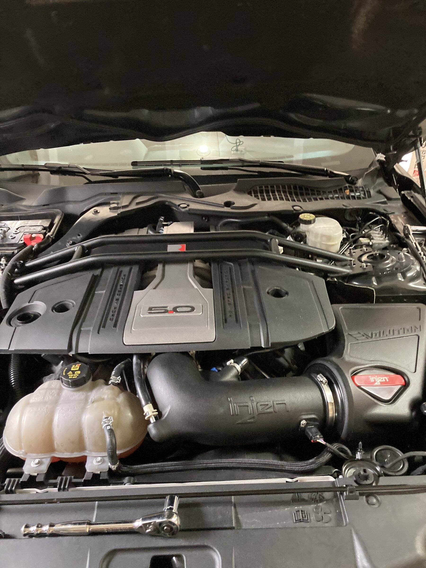

Injen Evolution. Looks great , great sound under heavy throttle, tune coming soon.
