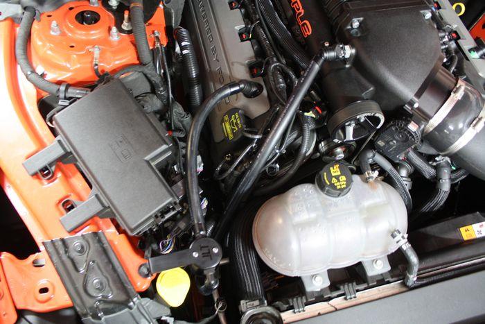

One of the recurring comments I read was that folks would prefer to have the JLT mount to something in the engine bay.
Are there any plans to add this feature?

Would be a nice feature. Without a mount, it looks like a dangling Transformers nut sack.

It's possible, our whipple kit(P/N: 3030P) is remote mounted and may work on a N/A Setup.
However to put this in perspective, the can weighs about 7oz empty. There's over 14k of these passenger 5.0 kits in circulation since 2012 between the original and the 3.0 all using that same OEM hose for mounting.

I'll be honest, that's been a continual concern of mine. I figured a good bump and the can might slam into something. But that puts it into perspective that since 2012 nothing like that has happened.
Would I be correct in assuming the added weight has also not caused any of the hoses to crack/break/fail over time as well or is that something to keep an eye on?

When the can's first released in 2012 we had to revise the fittings we used as they wouldn't stand up to the heat and oil over long term exposure. That was addressed in late 2012, early 2013 with glass filled plastic fittings.
Non-issue since then, you'll see once you have the can in hand how steady it is once installed. That hose is pretty sturdy.
