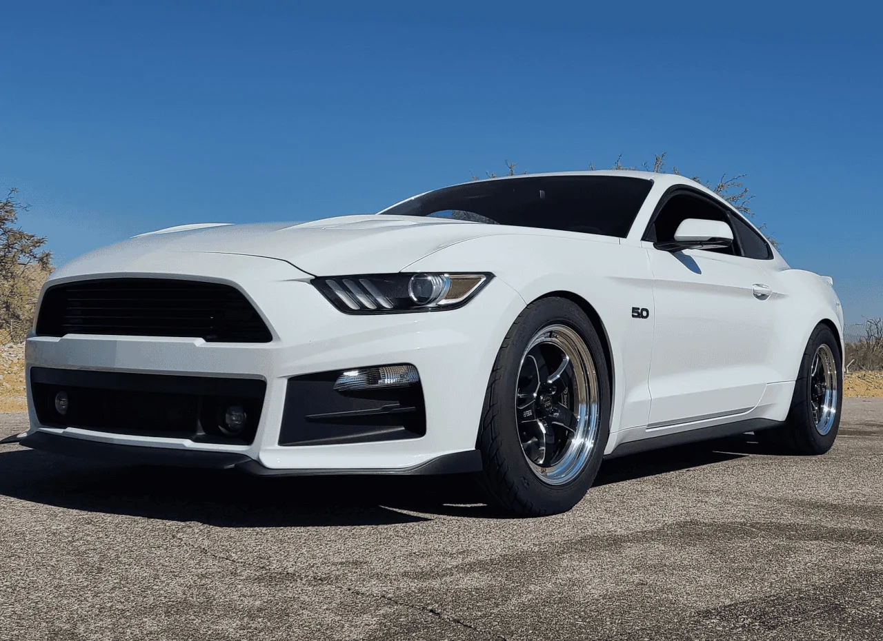

Steeda drag springs using factory PP1 struts and shocks with Procharger weight up front. Was somewhat concerned it may be a bit low in front but its not the case. The stance/rake in my opinion looks just right and the ride and handling are perfect for my needs. Front doesn't scrape driveway aprons or parking lot speed bumps at all.
