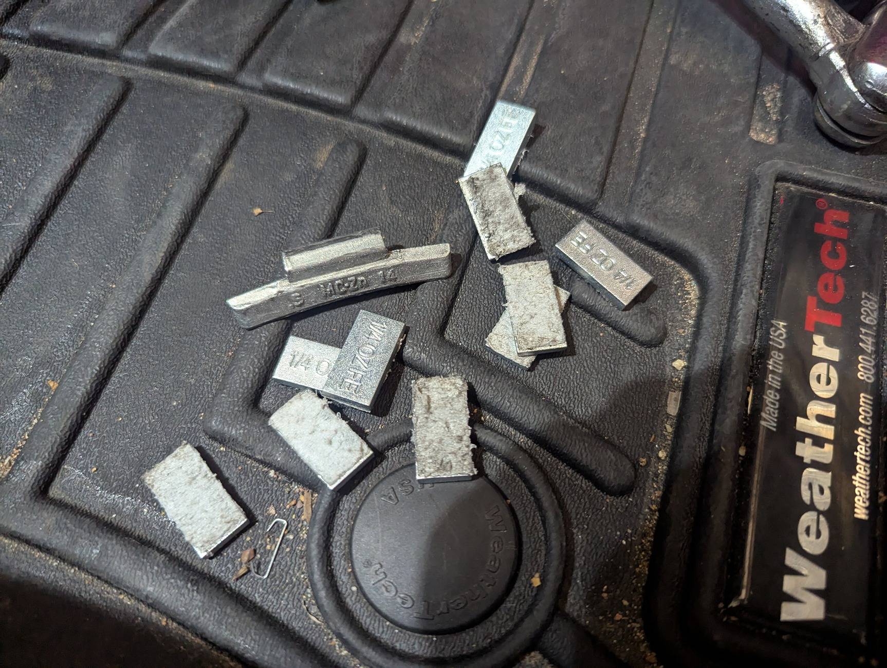

I took the wheels off of my car and brought them in to the store in the morning, came back later that day and picked them up to take home and put back on the car. I noticed that one of the wheels had a fair amounts of weights on the inside for balancing but also noticed that there were additional clip on weights on the inner rim. Odd but whatever.

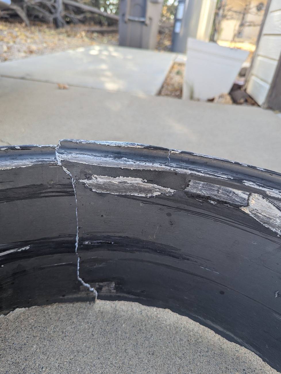

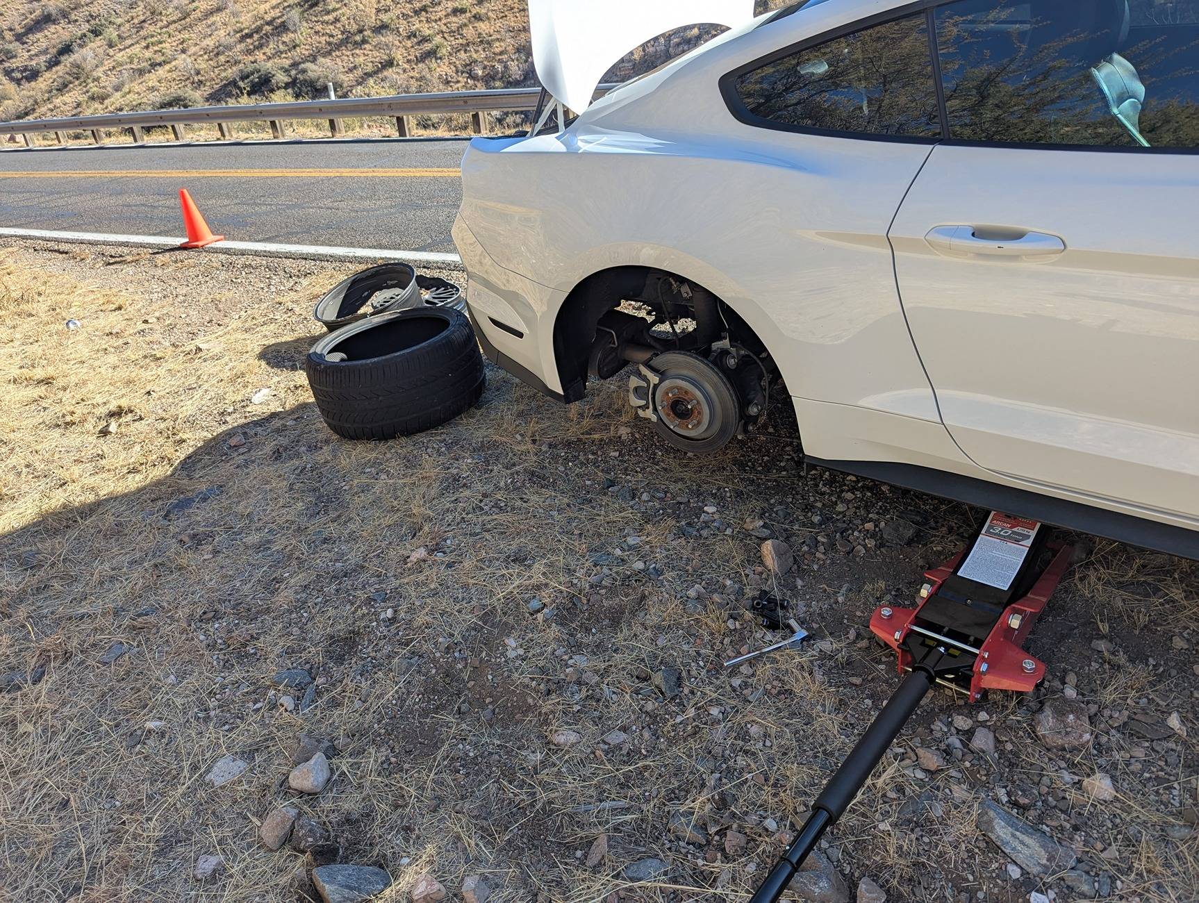

Drove the car approx 100 miles that weekend and when going 40-50mph, right rear wheel left the chat. It's possible I got off the side of the road where the asphalt was broken, but definitely not far enough past the shoulder to hit any rocks/debris (mountain road).

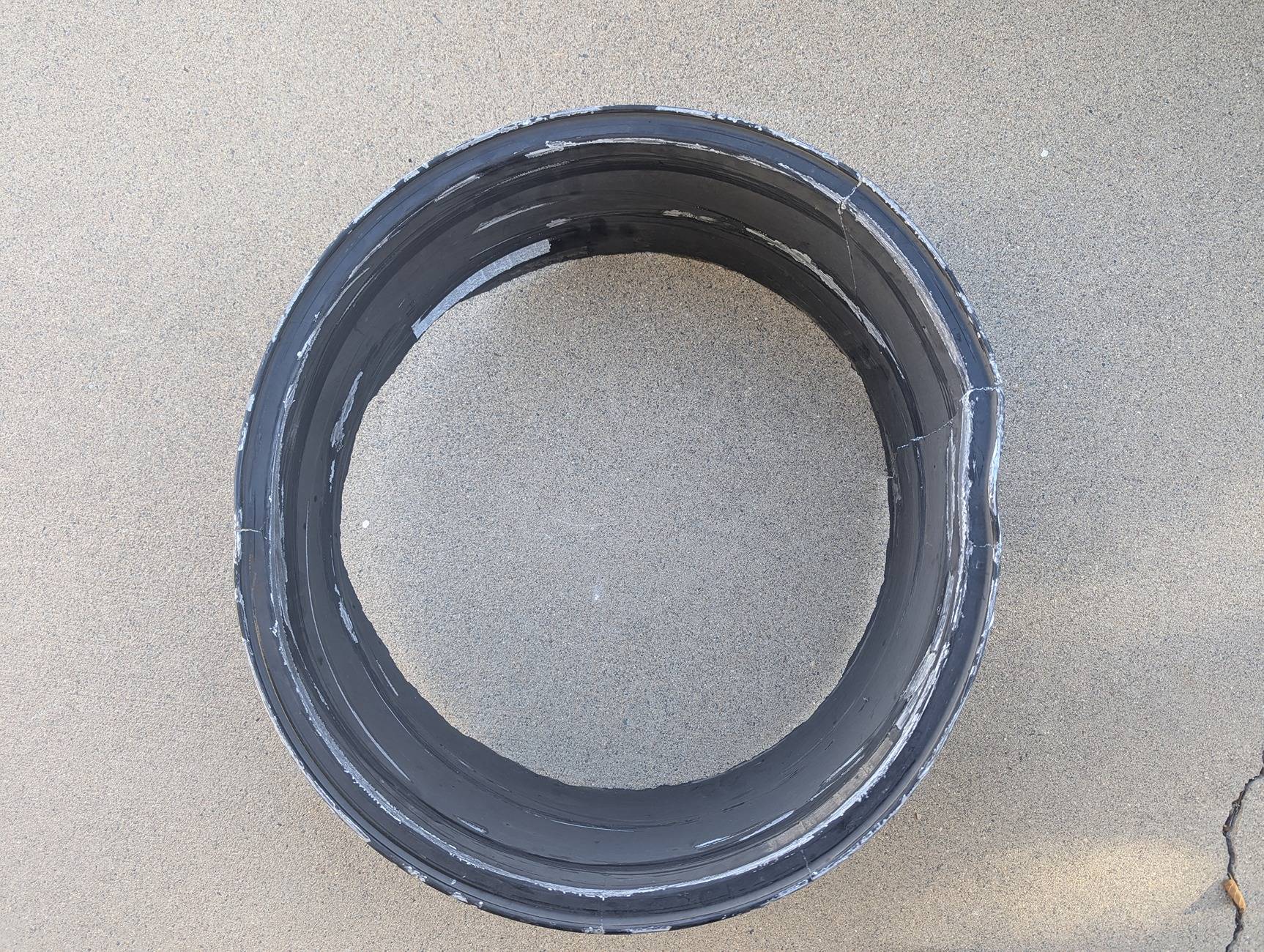

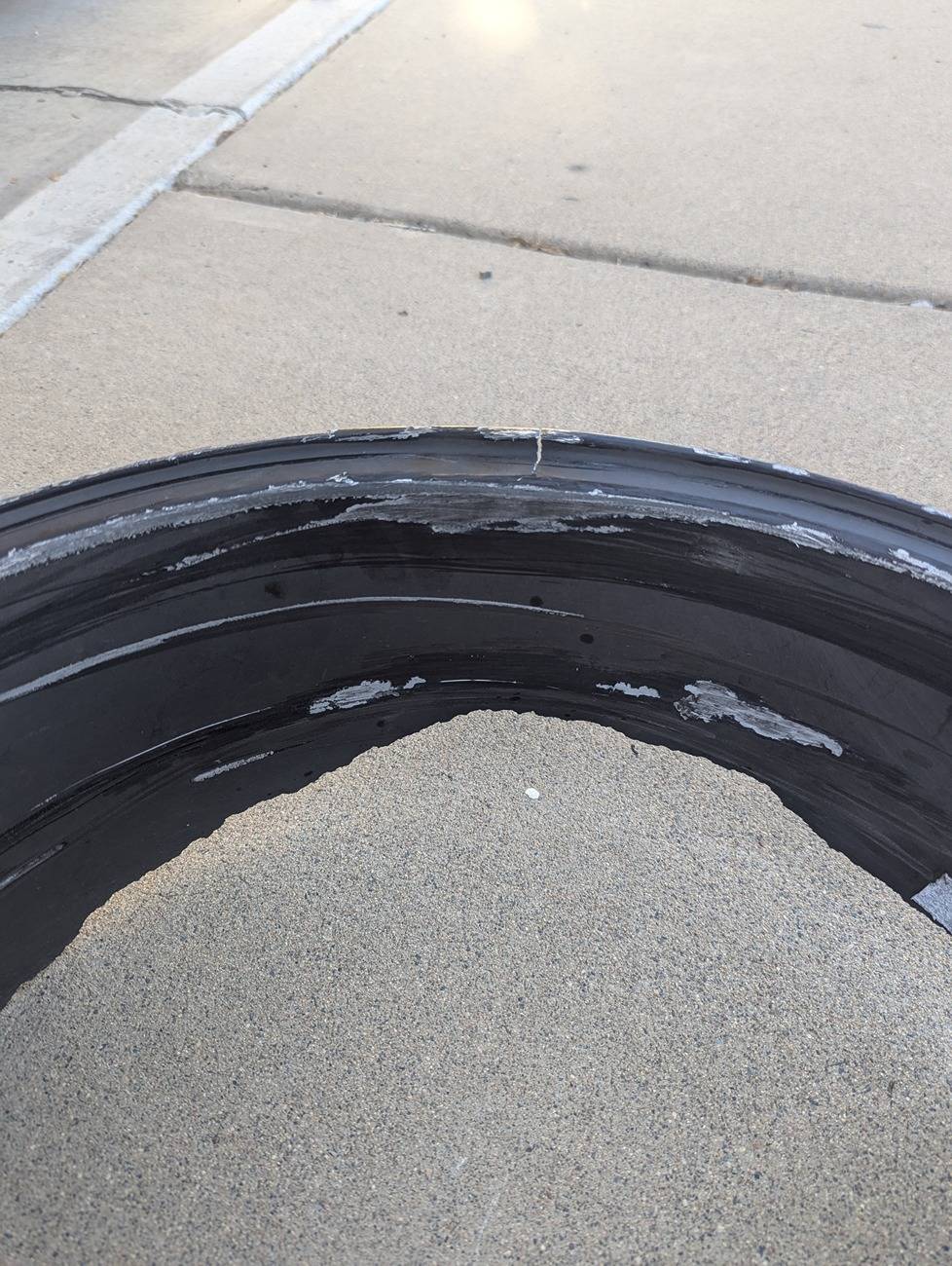

Drove another ~200 yards to get off the highway so I could pull off. Wheel was split in half, inner portion bouncing all around and the outter still on the hub. Got it all removed for another wheel to get put on and noticed two significant dents on the inner portion of the rim, exactly 180° across from each other.
The question: just pure dumb luck that the poor wheel hit two different hard objects in its life, one of them here recently, and they just happened to be on the opposite end? Or is it possible that shop damaged wheel when dismounting/mounting the tires and used a bunch of weights to balance it out?
Pictures attached, can zoom in on top pic to see both pieces of the wheel. Last pic is all the weights I could find when walking the road back from where it happened.

For those who have had experience with dismounting and mounting tires, are there any processes that could bend the rim inwards?
If they used a bar and the rim as a fulcrum, sure. I'm guessing the failure process began at the tire shop.
Anything is possible but I can't think of any way to bend a rim mounting a tire with a modern tire machine.
The fact they let the tire go out of the shop with all that weight tells me that whoever balanced it is very new or just doesn't give a shit.
That looks to be a pound of weight, there was most likely a defect in the tire and that along with all the weight shook the rim apart.
Some of this is on you, you should have gone to the manager when you saw all the weights on the wheel. The shop should have said we can't balance the tire and left it off the wheel.

Is it possible the tire shop damaged it? Sure, anything is possible. Also possible that when the wheel let go, it hit something on the way out and dented it too. Like others said, if they needed that many weights, something was off to start with and they should’ve at least notified you.
It also could be that the wheel was starting to fail prior to taking it to the tire shop (again, the weights seem to be an indicator something was amiss) and it finally said ✌ out. Scary stuff

That QTY of weights is totally unacceptable I would go back to the shop and ask to see the CCTV of the install or demand compensation that should have never been released.

If there had already been a tear, the tire would have been deflated.
If the rim had already been out of round before, they should have noticed this when fitting the new tires if they did it right.
At first they should run the rim on the balancing machine to see where the heaviest point is and then match the tire with its heaviest point against it. This way you need less weights.
By the way that are not many weights (if lead free) for cheap rims and tires!
The OEM do need more in many cases!
Of course, the rims may still have had an unnoticed defect.
The small wash out in the road may have been the last bit that was missing to failure.
Do you have pictures of the wash out / pot hole?
Conclusion: I don't see the tire shop to blame with the informations we have, but give it a try, asking is for free.
