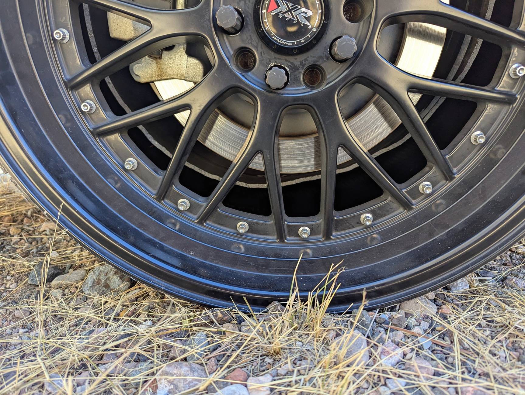

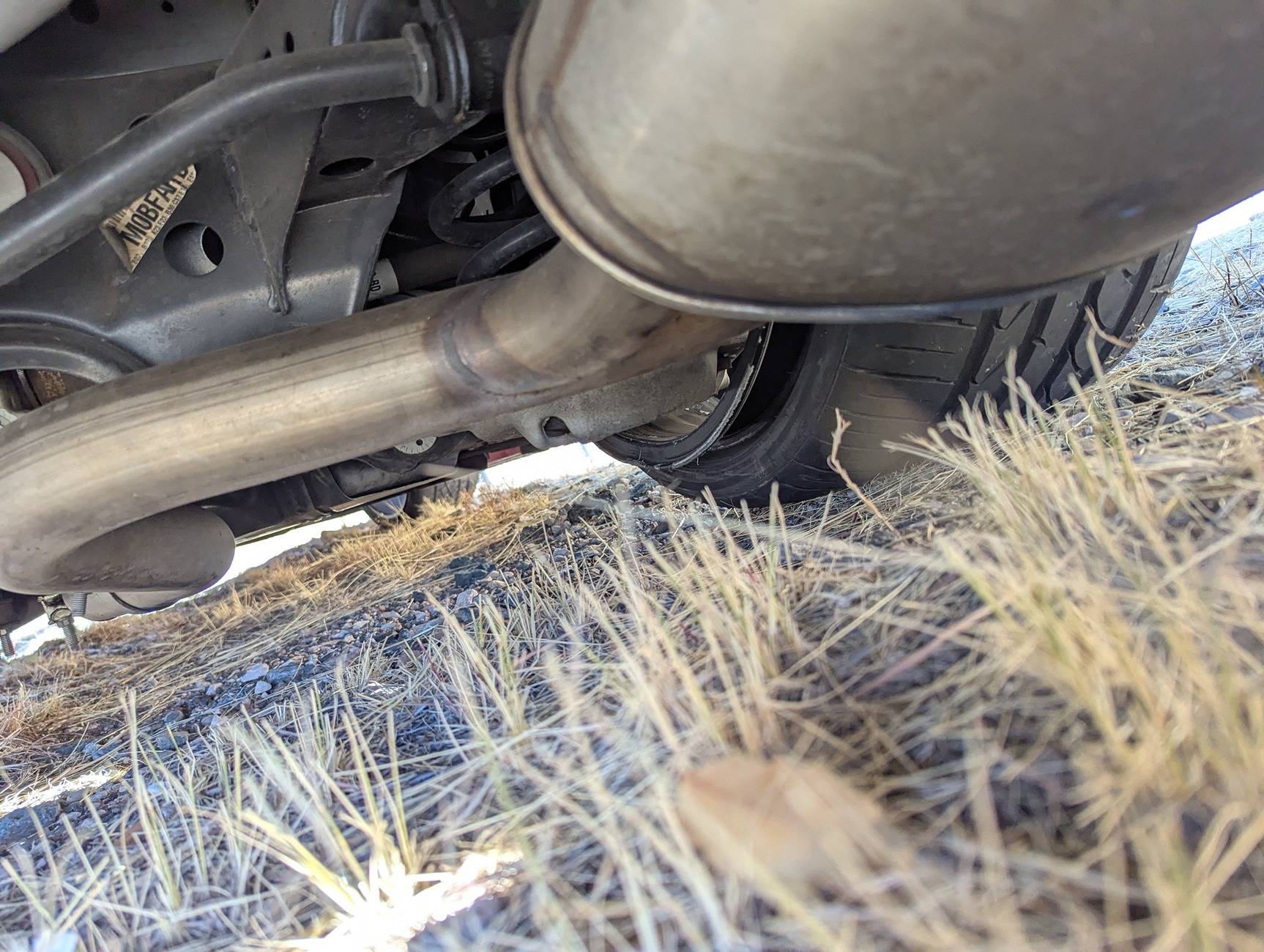

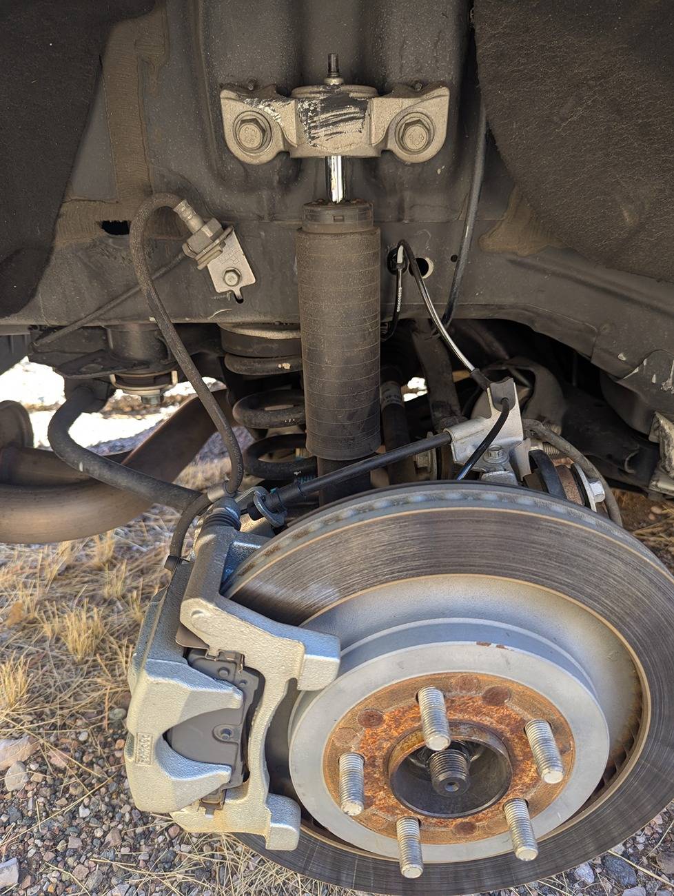

I don't think the tire blew, though we may define that differently. The tire itself appears to be perfectly fine, visually speaking. The wheel let go, separating down the barrel into two pieces. The outter part of the wheel remained bolted on the hub and that was the part I drove on for a few hundred yards.
The loose and inner section of the wheel bounced around and got beat up, beat the shit out of various things in the wheel well, which the the tire did as well. I'll post a couple of pics to maybe better show what I'm trying to describe.
I haven't heard of the QC issues of the Atturo tires, but I'm not on other forums. Definitely possible the tire itself was a contributing factor, I'm not ruling anything out. I went cheap with the tires because I am planning on getting a new set of wheels next spring and undecided if going 19 or 20" but I couldn't continue to run the G2 as they were getting even stupid slick.
Check the tire side walls and see if there is any signs of an impact . And if you need an upper shock mount , I have and your welcome to it . If your this way today bring the tire and let me have a look at it .
Sorry, I was looking on my phone and I thought the picture of the wheel was the tire ripped in half
Definitely looks like that wheel just had a catastrophic failure and wasn't cast right, you're right that the tire had nothing to do with it.
And unless the tire shop used a grinder to score the wheel where it failed I don't think anything they did would have caused that.
