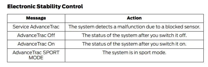

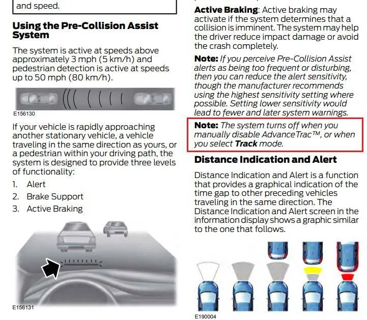

https://owner.ford.com/tools/account/how-tos/owner-manuals.html?year=2020&make=Ford&model=Mustang
Select either the on-line version, or the PDF, then search for the word AdvanceTrac. You'll find a few matches.
For instance:
or:
Also, try to disable it in your car and see what the instrument panel says. :)

Vlad, you are exactly right. And, when I disable ESC in my vehicle it does say ”AdvanceTrac off”. But that’s it! Nowhere in the sections on TC or ESC can this be found. I think you’re right; Ford is looking to get themselves sued over this. Something this important to vehicle control should be much clearer and easier to find in the owner’s manual. And I can assure you that nobody at Ford you can get on the phone knows either. I’ve been trying for weeks to simply find out officially if Drag Strip driving mode automatically disables TC as it does in Track Mode (the TC Disabled light does not come on in DS Mode like it does in Track Mode) and they can’t even tell me that.
