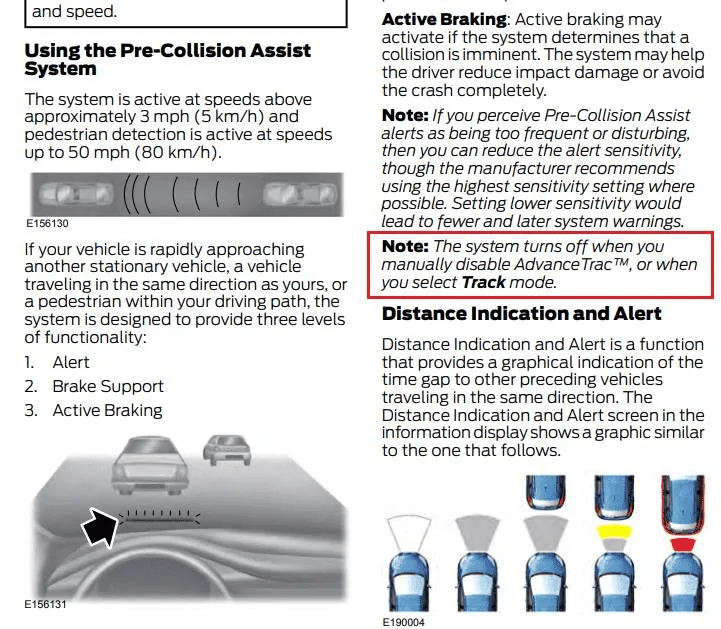

Well......I can confirm that's complete bullshit. Setting the car to Track mode does not disable TC. I know this 100% for a fact. I did that, and was trying to get out of a friend's snowy/icy driveway. The TC was definitely still on and fighting me all the way.
That paragraph refers to the pre-collision alert and the automatic braking, not the traction control. It may well be that those are indeed disabled in Track mode.
