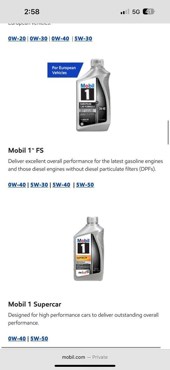

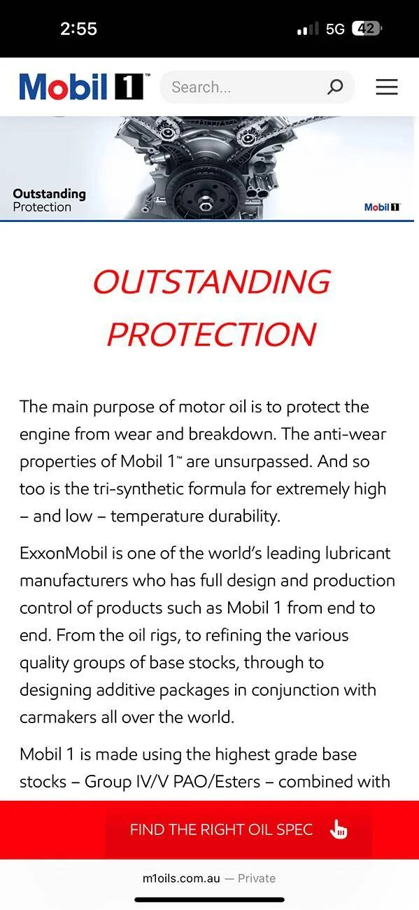

When I run across items like this below, it make me wonder if we don’t have the latest information (or correct info).
https://www.m1oils.com.au/why-mobil-1/outstanding-protection/
Mobil 1 own explanation for the Euro is clear. It is not for extra ZDDP or Group IV; it for the fact that in England where is was stationed at RAF Mildenhall Air Force Base, many cars sold where Desil or Turbo Desil.
https://www.mobil.com/en/lubricants/for-personal-vehicles/our-products/motor-oils

Mobil 1 own explanation for the Euro is clear. It is not for extra ZDDP or Group IV; it for the fact that in England where is was stationed at RAF Mildenhall Air Force Base, many car sold were Diesel or Turbo Diesel.
Look at the spec the oil meets then look up what are the requirements for that spec. The one we as high performance car owners want is the A3/B4 euro spec. ACEA, A3/B4
What will these oils provide that Mobil 1 Full Synthetic 5w-30 and 5w-50 doesn’t?
Again, I’m not trying to be a ass, I really want to know.
Where are you seeing this, exactly?
Euro spec oils generally carry an ACEA rating rather than just API. Many of the ACEA specs have requirements similar to diesels (higher viscosity, more zddp) so they can carry a gasoline/diesel dual rating. Also many of the euro auto manufacturers have different specs vs American cars so they tailor them to those. I believe pennzoil even has one called AV for Audi/volkswagen.
