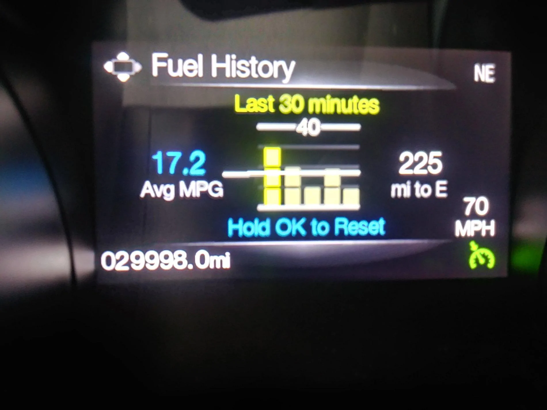

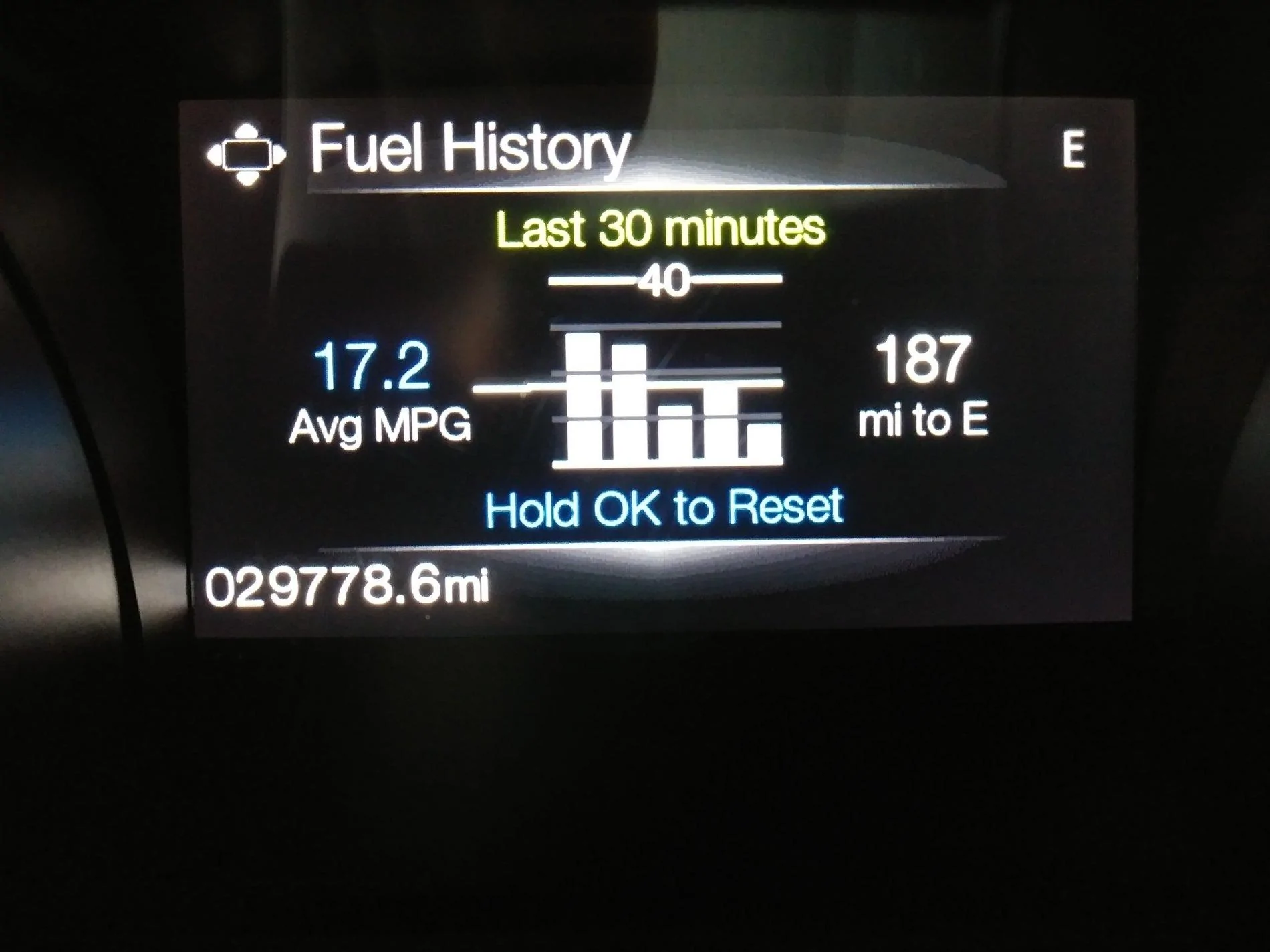

But to say the least, NASCAR is NOT a good example for a use case of thin oils in street cars if you can about durability. BTW, after switching to PUP 5W-30 from MC 5W-20, I actually got about 1 mpg BETTER fuel economy on the same route under similar conditions (50-60F, 75 mph average speed) just today. I changed over to PUP 5W-30 yesterday. Observe the left most bars as that was the same portion of highway without traffic most of the time. Earlier on in my trip this morning, I got stuck in traffic so fuel economy wasn't as good.
Each bar is a 6 minute interval of the average fuel consumption. So despite the slightly higher fluid drag losses, the anti-friction and anti-wear additive package in PUP 5W-30 actually more than made up for the fluid drag losses and netted about 1 mpg better. Just goes to show that if there was ANY forward thinking behind CAFE, they would focus on increasing reliability AND fuel economy by staying with 30 weights as the norm and focusing more on base oil quality and additive package quality.
Remember also my car is highly modified: Power Pack 2, VelossaTek Ram Air Duct, Oil Catch can, Cat Back Exhaust, TriboTEX, PUP 5W-30 and a really short final drive because I'm running a four square 275/35R19 tires that are 1.1" shorter diamter than the stock 40 series on lightweight wheels. So I have MORE tire up front which increases rolling resistance on sticky Pilot Sport 4S rubber. Between the 4% final drive ratio reduction (due to tire size) and the stickier and wider rubber with the power adder, that's pretty darn impressive for cruising on the highway at 75.
PUP 5W-30 (BTW my average speed was 75 mph, not 70, I hit some traffic right before I took the photo and had to reduce my crusing speed).
MC 5W-20
