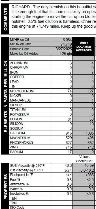

Send a sample off for analysis and you will change your mind. 5w20 looks fine at first, but the viscosity break down gets ugly. Especially if you're using Motorcrap oil.
This was my experience on my last oil change analysis from March, I will be going likely to 5w30 for next change (viscosity is the concern):
