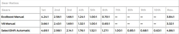

So the MT-82's 1:1 is 4th now?
That seems to be what the info says.
I really like having 5th be 1:1, and the close ratio feel. Moving to my '14 from an '02 (then back when I drive my mom's '03) The shorter ratios really feel good. The old wide ratio TR-3650 feels like driving a truck, now.
I'd like them to keep the ratios the same, and 5th being 1:1, but reduce the spread between 5th and 6th. The drop is way huge as it is now.

I don't see them getting away from the fuel economy 6th gear in today's environment. The GT350 has almost the same gearing 5th to 6th. It would be nice if we could get it's closer ratios from 1st to 4th though.

Sounds like they are going all out on the MT82 for once, and matching the TR6060 gearing with only 4 underdrive gears and detachable bellhousing.
This is good news as it should give 15-17 owners a solid upgrade choice besides the aforementioned TR6060.

As others have pointed out, the manual transmission ratios are unchanged from last year. Based upon the 6-speed manual info (page 14) in the eSourceBook, this must be incorrect. Does anyone know the 2018 MT82 gear ratios for the V8?

4th is now 1:1? No need for two overdrives :crazy:

Given how most serious road racers learn quickly that the MT-82 is not up to heavy usage and put in a Tremec, you gotta wonder about the wisdom of the no lift shift feature. I just don't see the MT-82 putting up with a lot of that, to me it's the biggest vulnerability in this car, it just feels weak when driven aggressively.
1st gear with the 3.73's is already borderline useless, lowering that further seems a tad strange, as does having 2 overdriven gears. Of all the stuff on the '18, only the addition of a Tremec would have been interesting enough to look at trading in, IMHO.
Ford must have lots of cash for gearbox warranty I guess.

Where are you guys seeing 2 overdrive and a shorter first gear ratios for the manual? Esource shows the manual ratios have not changed and still have one overdrive ratio. The 10A has three overdrive ratios and first gear is shorter than the 6A's first. 6A did not have a 1 to 1 gear.
Edit to add: I see that the esource conflicts with itself. One section quoted above says two overdrive gears but the table of ratios has only one overdrive. FYI the manual in the Camaro SS has two overdrive ratios and a very tall first gear.
