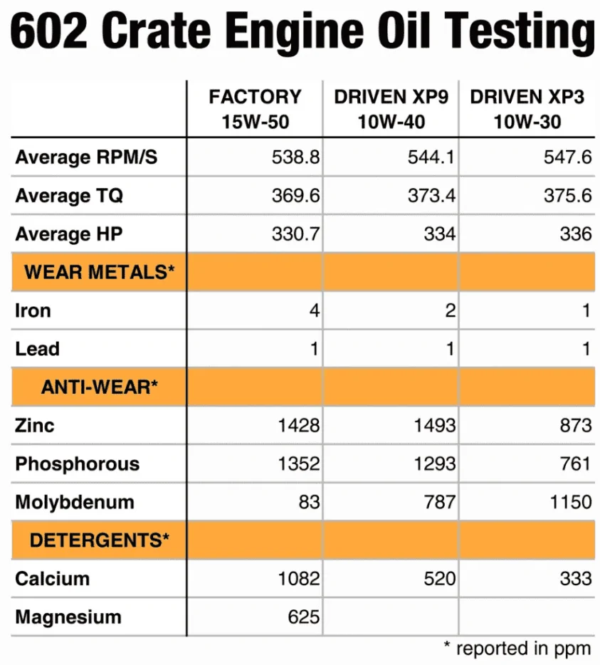

BTW the Ecoboost 2.3L uses the same 2 inch bearing size as the 5.0 and with a slightly tighter clearance range of 0.0011 to 0.0020 inches and calls for 5W-30. The 5.0's clearance range is 0.0011 to 0.0027 inches and calls for 5W-20. On the tightest end of the range they are the same. On the loose end of the range the 5.0 is the looser of the two and would benefit more from 5W-30. Granted the Ecoboost is designed to handle lots of torque down low so using a higher viscosity makes sense for better film strength at low RPM, especially when TDI engines tend to cause the oil to shear down. However film strength is always better higher viscosity grades AND film strength grows stronger as RPM increases, regardless of viscosity. AND general rule of thumb for highly loaded performance engines that operate at high RPM, run a little looser with a little thicker oil for optimal bearing life.
A thin 5W-30 should provide 10% to 14% more film strength with only a very minor increase in drag losses that I wager would be so small that it's within the error budget of the measurement instrumentation. 5W-30's also provide a higher viscosity index than their 5W-20 counter parts, at least that's the general trend I've seen when comparing the same blend of oil in it's different viscosity grades offered.
PUP 5W-20 has an index of 164, same as MC Semi-syn 5W-20 (also nearly identical viscosity at 100C between the two). However PUP 5W-30 has a viscosity index of 173 and PUP 0W-40 has a viscosity index of 189, very high and likely why Dodge uses it in all their performance engines, it's a very temperature stable blend that should be highly resistant to thermally induced shearing while also provided the necessary film strength.
The higher the viscosity index, the less it thins out at high temperatures and it appears that it's easier to get a higher VI with 30 and 40 weight blends than with 20 weight blends. In their testing of a 602 crate engine, Driven's XP9 10W-40 only cost the test engine 2 HP over their XP3 10W-30 and one could argue even that was influenced by it's higher moly content. This seems to back up the reality that the difference in drag losses between a 5W-20 and 5W-30 is so inconsequential, it makes one wonder why give up the better performance of the 30 weight for the 20 weight in any performance street car engine?
The 5th gen LT1 in the 6th gen SS and 2014+ Corvetts calls for 5W-30 for street use and 0/5W-40 for track use. The Hemi 392's all use 0W-40. Only the Hemi 5.7's call for 5W-20. 2018+ GT's call for 5W-30 for track use, up from their factory fill of 5W-20 for street use. The 2018+ Ecoboosts call for 5W-50 for track use, up from 5W-30 for street use. The GT350 uses 5W-50 all the time. The 2017+ Ford GT uses 5W-50 all the time. The Track Pack 2011-2014 GT's use 5W-50 all the time. The 2013-2014 Boss 302 uses 5W-50 all the time. The 2015 Performance Pack GT's used by Ford Racing School use 5W-50 with an Air to Oil cooler on the stock ECU calibration for the ultimate in reliability of frequent track use...2015 to 2017's are the forgotten generation in terms of oil specs for some unknown reason...
