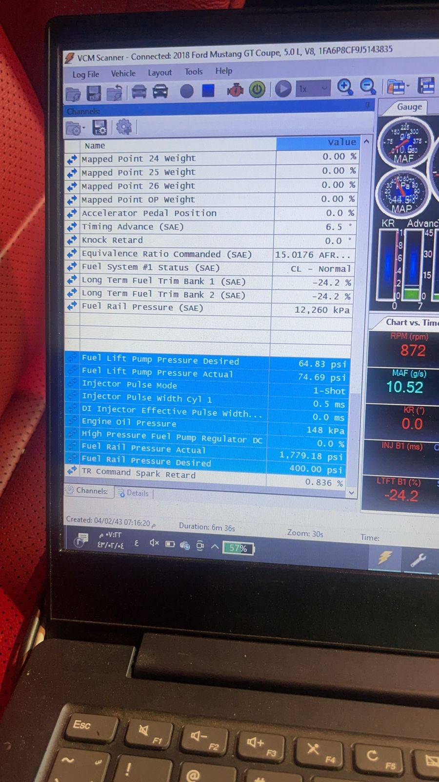

Hi all,
I've got this issue with my car being acting rough and having stall scenario multiple times. The tuner saying it's not a tuner related thing and to be honest I don't take his words for granted. Can anyone please check the attached file and see the fuel rail pressure which is way to high for being normal. We will be checking the boost pump voltage and so on then we will replace the injectors with the factory one. This is an Odin set up.

Let us know how it goes. I have a feeling it is a lean/rich issue at idle/low throttle plate angle, although I have no way to be sure. If that is the case, which BTW sometimes manifests even on normally aspirated GT350s on the track, it should be resolvable by tuning... Good luck man.

Sure I will, This is the core of this platform.
The car is still at the shop for troubleshooting. I'm gonna be sending a fat data log to VMP and few other trusted tuners to point out if this is really a faulty TB,BAP or tune! The car is sucking so much fuel and the DTC's are P0172/175 fuel rich just like what you suggested. The Misfire : 4,6 or even Multiple P0300 would come randomly! I just want to get my car fixed and enjoy it ASAP! I believe shifting to better tuner is my remedy!
Thanks for your add ups anyway mate :))
